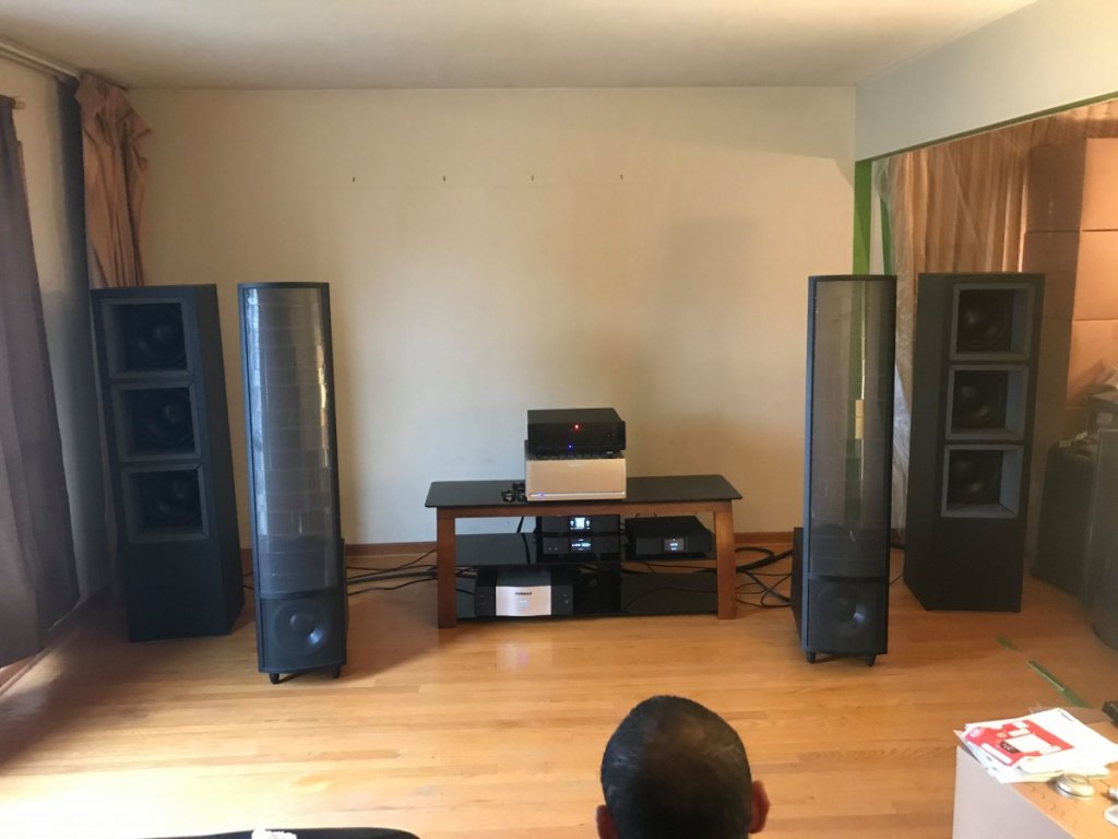

I strongly recommend triples. You'd be surprised how much difference the added driver makes and it doesn't take up anymore floor space than the doubles. The triples would also balance out visually with the Maggies better. Here's a pic of triples with a pair of Martin Logan Summit Xs
These have A370-XLR3 amps built into the bottom of the the towers. If you keep the amps separate the towers would be shorter accordingly.

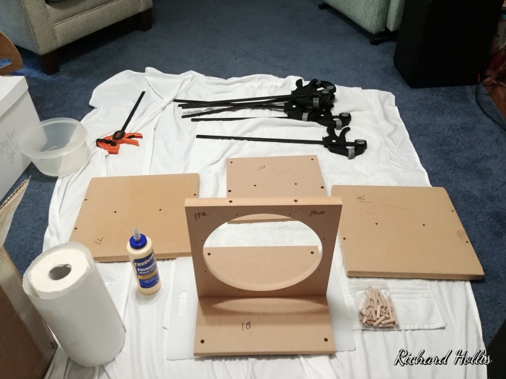

Here is one module laid out with what I use to glue-up and clamp them.

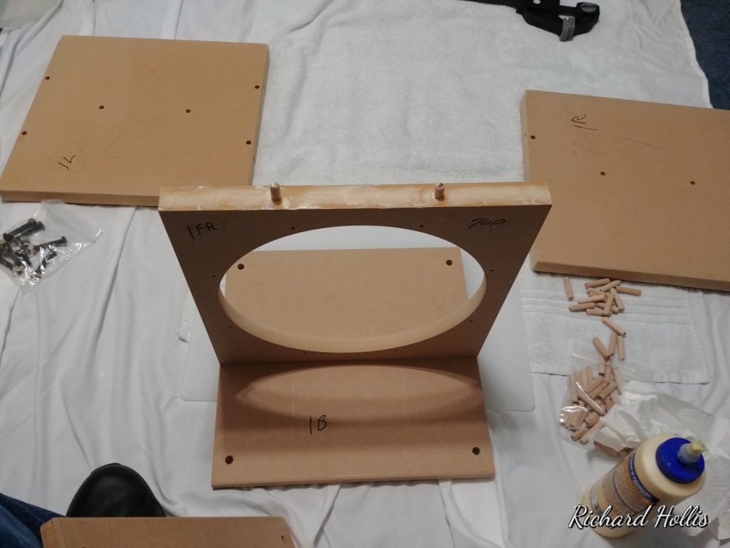

The bottom is glued to the baffle and the glue on the top side ready for the piece with dowels:

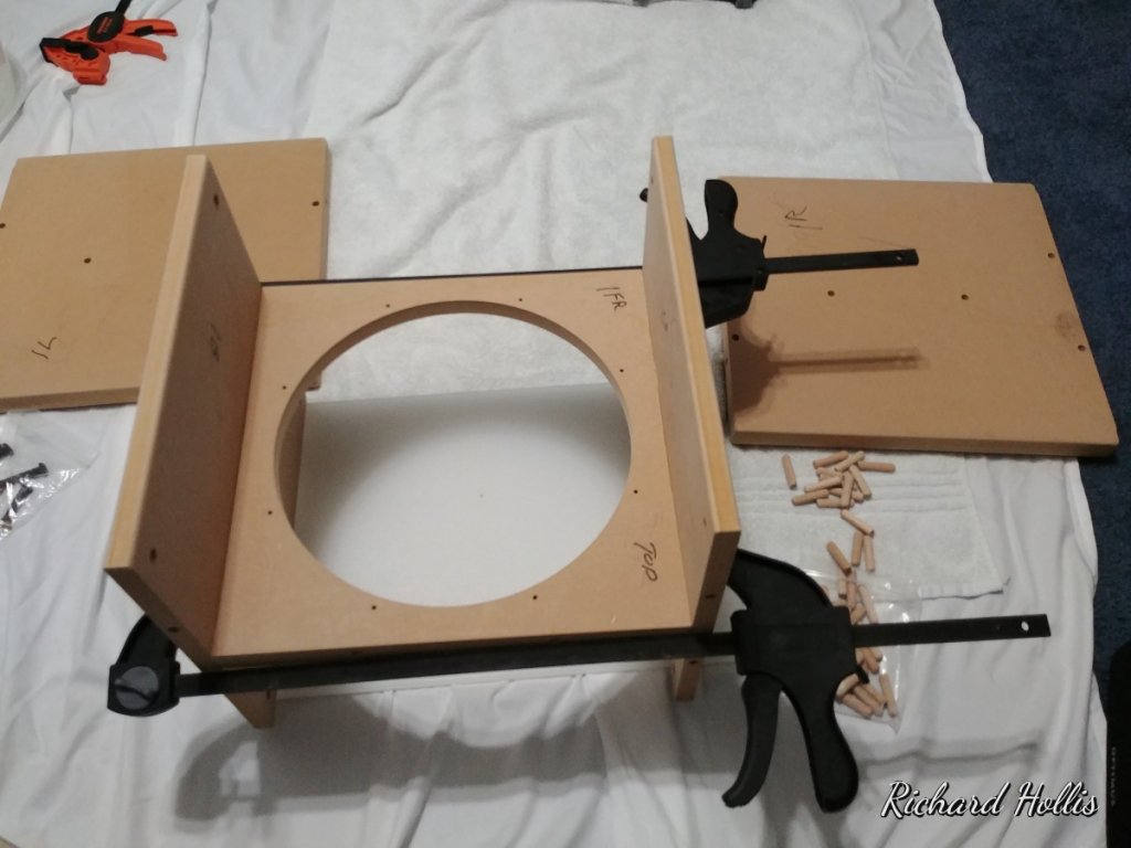

Second side glued and now clamped:

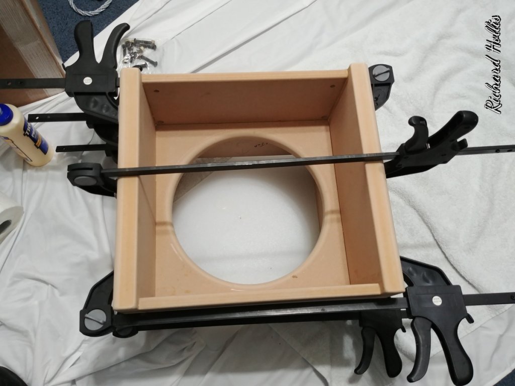

After 30 minutes glued the left and right sides and clamped them to let the glue dry:
Let it dry for 2 hours and remove the clamps and set aside to build module #2.
