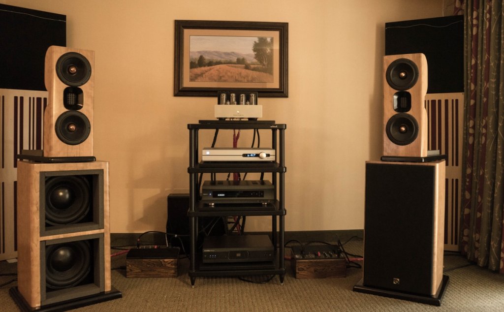

I love the look of exposed drivers, but the no rez, in my opinion, looks terrible.  Has anyone ever made a grill frame like they are typically built but with a wider perimeter and cross piece in the center?  The idea is that the wider frame will cover up the exposed edges of the no rez.  The frame can then be painted the same color as the cabinet.  Will this have a negative effect on performance or will it be purely cosmetic?  It should improve the appearance considerably if not using grills.

The foam on the NoRez is  mostly acoustically transparent so if you cover its edges it effectively changes the sonic characteristics of the cabinet. Essentially puts a semi-back on cabinet.
There are some alternatives. Here's one:
https://www.audiocircle.com/index.php?topic=139529.200
I think that photo sort of highlights the NoRez.

If you make the frame out of 1" x 3/4" hardwood (I've used both poplar and oak, you don't need a cross piece.

I really like the compound bevel look of this NoRez build.  It gives it a very finished look.
FWIW, I rotate my drivers by 45 degrees (so the posts are in the corners, NW/SE or NE/SW versus E/W or N/S) to give my big mitts some more room to access the speaker binding posts.

Yes it does. I've built two pair like that. However, when you miter the NoRez it takes twice as much compared to straight cuts.

I agree.  That's a very nicely done pair, but I would still like to cover up the norez, but not if there's a sonic penalty.  Does anyone know specifically how covering it up as described above will change the sonics?

Seem like if you wanted to get real creative you could wrap the NoRez with grill fabric. (that would be a challenge to implement) That should not affect its performance significantly. Personally I would use grills if for no other reason but to help keep dust out.
