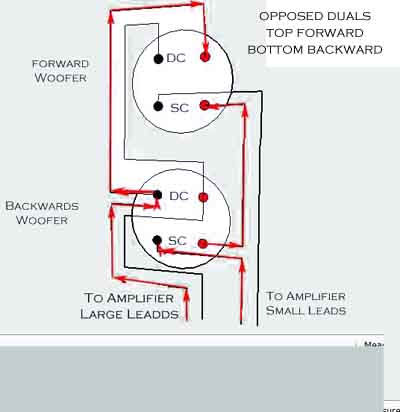

DUALS WITH  OPPOSED WOOFER (one forward, one  backward)
Driver Coils
Big red lead from  A370 to lower (backward) woofer - driver coil, then from there to upper (forward) woofer + driver coil.
Big black lead from amp to  lower (backward) woofer + driver coil, then from there to  upper (forward) woofer - driver coil.
Driver coil wiring done.
Servo Coils
Small red wire from amp to  lower  (backward) woofer - servo coil.
Run a wire from the lower (backward) woofer + servo coil  to the  upper (forward) woofer + servo coil
Finally, run the  small black wire from the amp to the upper (forward)  woofer - servo coil.
Servo coils  done.

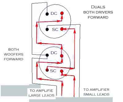

DUALS WITH  BOTH WOOFERS FACING FORWARD
Driver Coils
Big red lead from  A370 to lower woofer + driver coil, then from there to upper woofer + driver coil.
Big black lead from amp to  lower  woofer - driver coil, then from there to  upper woofer - driver coil.
Servo Coils
Small red wire from amp to  lower  woofer + servo coil
Run a wire from the lower woofer - servo coil  to the upper woofer + servo coil
Finally, run the  small black wire from the amp to the upper  woofer - servo coil.
Servo coils  done.

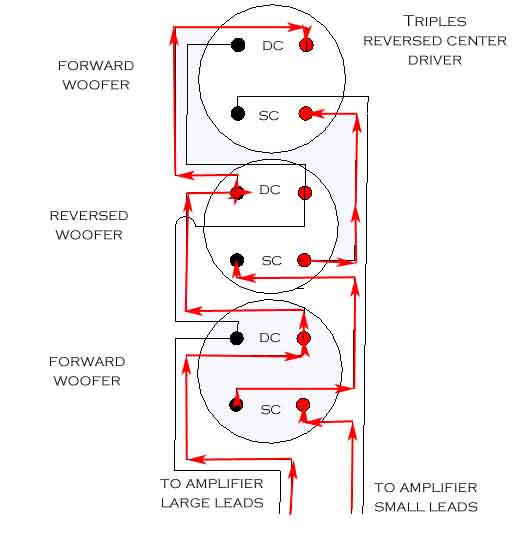

TRIPLES WITH ONE WOOFER FACING BACKWARD
Driver Coils
Big red lead from  A370 to lower (forward) woofer ) +  driver coil , then from there to middle (backward) woofer - driver coil, then on to  upper (forward) woofer + driver coil.
Big black lead from amp to  lower  (forward) woofer - driver coil, then from there to  middle (backward) woofer ) + driver coil.  and finally to  upper (forward) woofer - driver coil.
Servo Coils
Small red wire from amp to  lower (forward) woofer + servo coil.
Run a wire from the lower (forward0 woofer - servo coil  to the middle (backward) woofer - servo coil.
Run a wire from  middle (forward) woofer + servo coil to upper (forward) woofer + servo coil.
Servo coils  done.

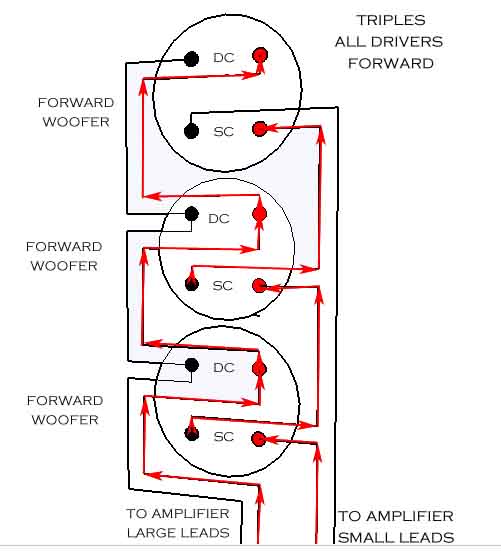

TRIPLES WITH ALL 3 WOOFER FACING FORWARDS
Driver Coils
Big red lead from  A370 to lower woofer  +  driver coil, then from there to middle woofer  + driver coil, then on to  upper woofer + driver coil.
Big black lead from amp to  lower  woofer  - driver coil, then from there to  middle woofer - driver coil.  and finally to  upper woofer - driver coil.
Servo Coils
Run a wire from the lower woofer - servo coil  to the middle woofer + servo coil.
Run a wire from  middle woofer - servo coil to upper woofer  + servo coil.
Servo coils  done.

Very Very nice Jay, it is very kind of you to spend the time to do this for people. It can be very difficult to find the information in all of the threads. I bet a lot of people will be really happy to have access to this and I too think it should be a sticky.
I had to ask for someone to point me to where the diagram was because one wasn't included in the kit. Maybe Danny can use this to send out with all of his Servo Sub sales.
