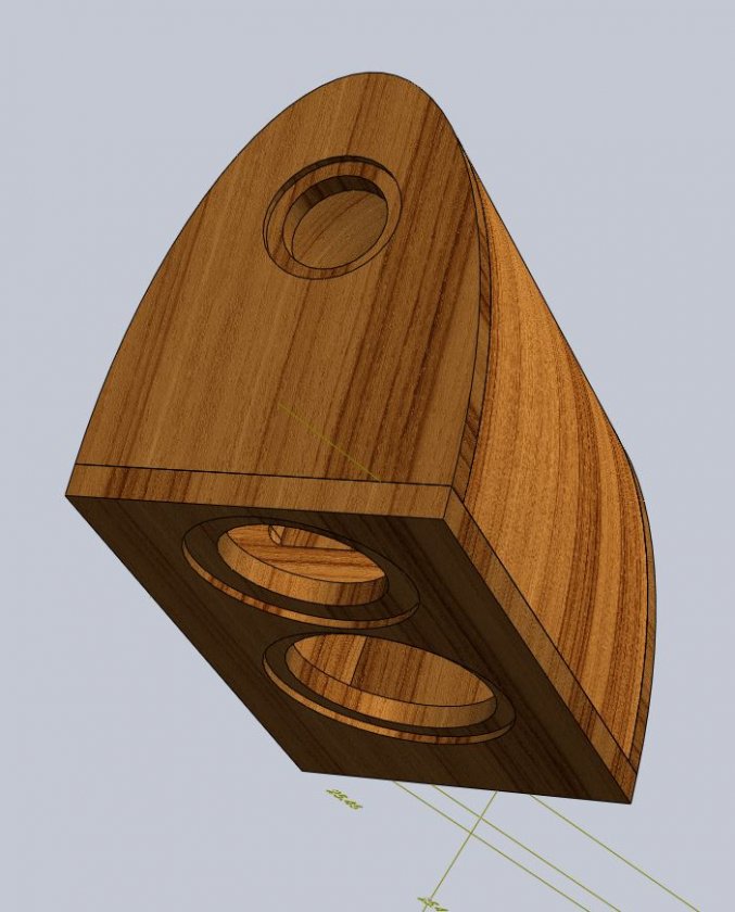

To put this into context, this is for a custom cabinet we're building for a customer. It's a small 0.32 cubic foot bookshelf speaker with a "boathull" cabinet make of layered stacks of baltic birch that are CNC milled. Because of the boathull shape it's not practical to place the port in the rear. Placing the port in the front isn't workable either because there's very little room for one and it would probably look awful. Hence the question of top...or bottom....location.
Going to go with top mounted. Bottom mounting would require feet to give the port breathing clearance and want to avoid feet on such a small speaker.
If you're interested, here's our AC thread with some more pics of the roughed out enclosure before sanding or mounting the baffle. http://www.audiocircle.com/index.php?topic=137108.0
Morten
Also, here's a 3D CAD rendering of the driver/port openings with a top mounted port.
