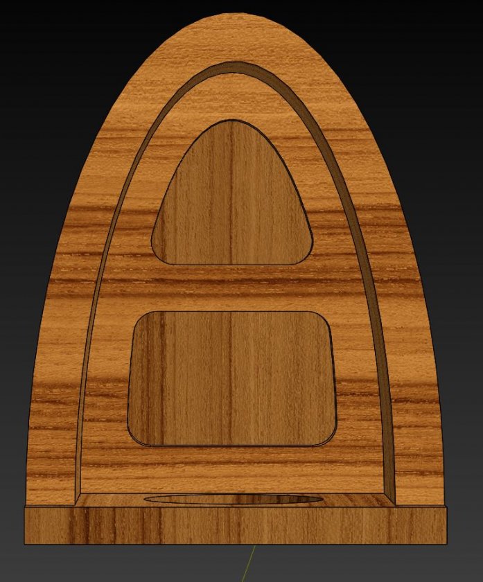

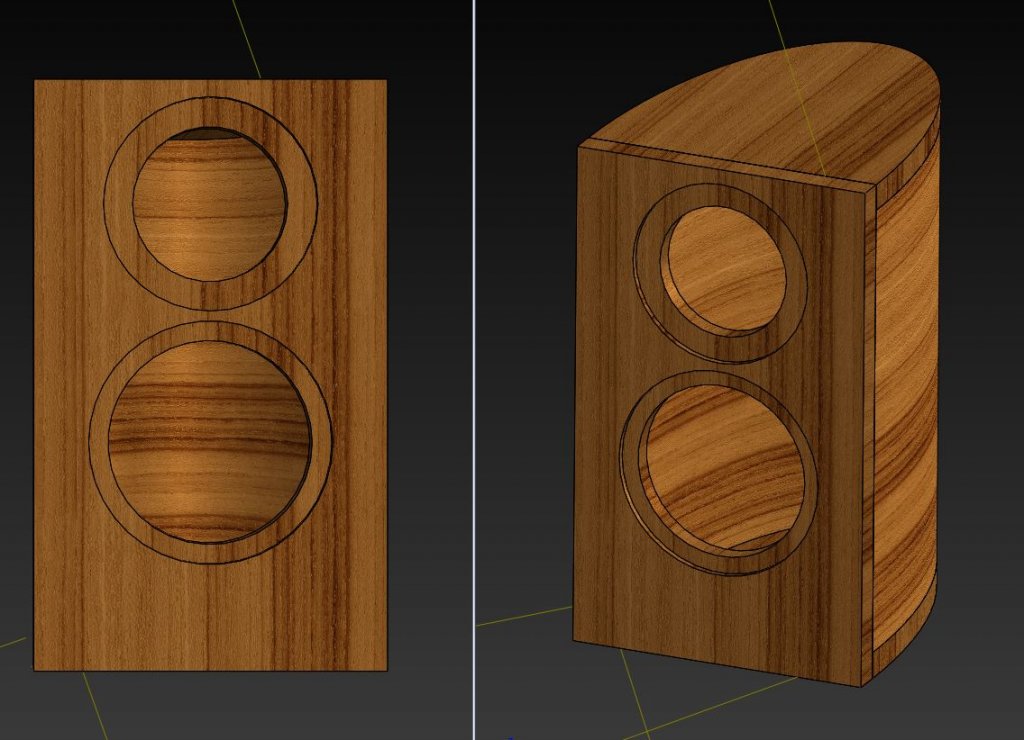

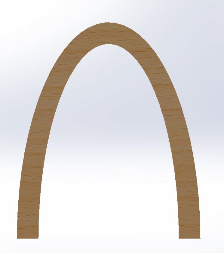

I've been working with a customer who is looking for a set of custom speaker cabinets that utilize a curved laminated cabinet shaped like a boat hull...hence "boathull speakers". These will be milled out of baltic birch plywood and finished naturally showing the thin laminate look of this fine hardwood plywood. The top, bottom and baffle will be veneered. The pics below don't reflect the external "look" of the final version but the structure and shape are accurate.
Once we get these done I may build a similar but larger mid-size cabinet suitable for a Audio Nirvana full range driver.
Anyone interested in something similar feel free to contact me. Keep in mind these are not low cost cabinets. I won't do these in MDF - the dust is terrible even with a good vacuum system.
Here are a few CAD pics. The last one is a top view with the top removed showing the internal brace located between the 2 drivers.

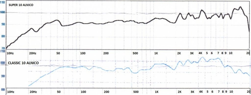

Not sure if "bigger is better" applies here but that's probably the thought behind it.
I've had Super 8 Alnico's running in mid size ported box for a few years now and I think they're amazing. Have not tried their newer Classic line without the whizzer cone. Do you think the Classic's are superior to the Supers?
Hi,
Here is a comparison Super10Alnico x Classic10Alnico for your evaluation,
you will note Super are stronger at bass and hi freq while Classic is smoother.
Also smoother at the Impedance chart.

I think the lack of whizzer cone prevent the beaming.
It does not... but it is likely the highs will be rolled off on a 6.5" or larger driver without a whizzer.

So remove Super10Alnico whizzer will be a great tweak?
No, I think you need a whizzer on a larger single driver. You can see the classic 10 is very rolled off, I couldn't deal with that but I suppose some like it.

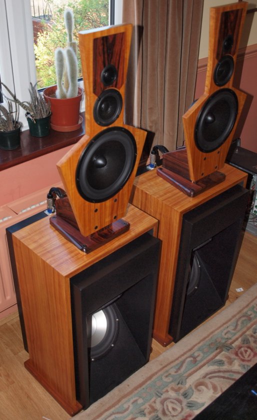

Bit off topic, but relevant to baltic birch and veneering....
These are 3/4" (19mm) baltic birch dipoles that I built to Siegfried Linkwitz's LX521 design.  The top parts and bridge are hand veneered using hide glue and French polished by moi, because I'm a traditionalist.  The dark wood is solid Cocobolo rosewood.  The feet at the bottom of the bridge are Goncalo Alves.  The bass dipoles are also baltic birch and are painted in black milk paint.
Craig

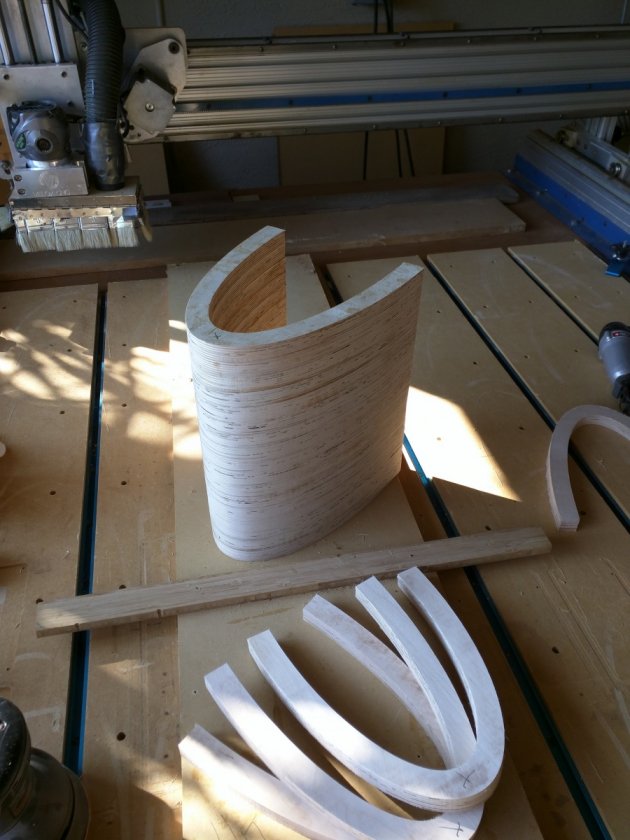

« Reply #17 on: 1 Nov 2015, 02:31 pm »

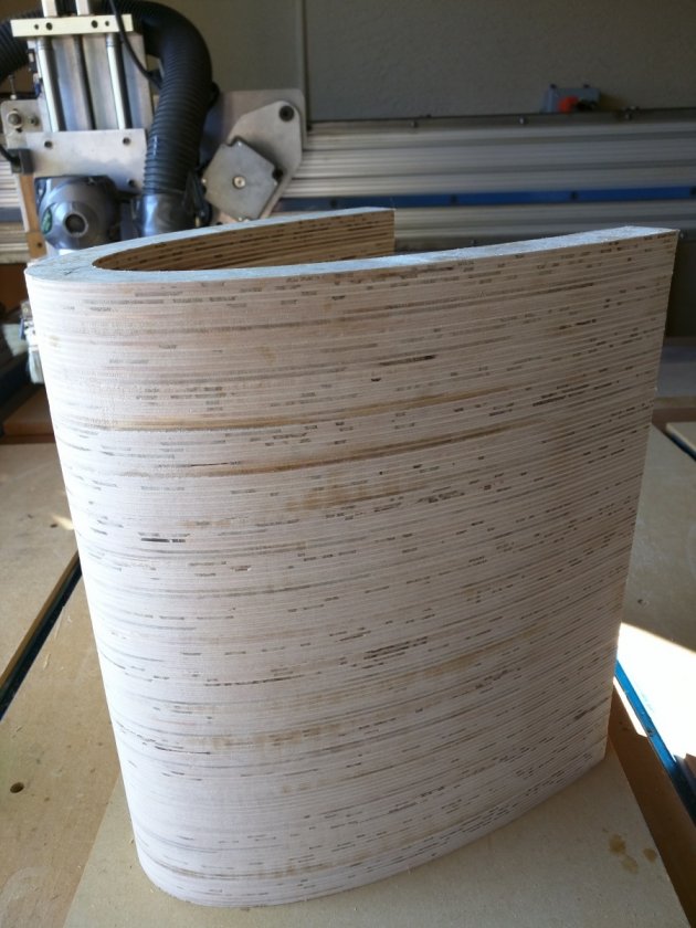

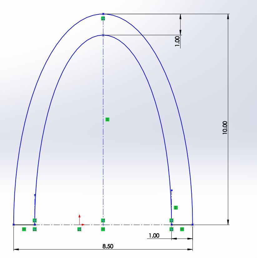

A few pics of the custom set of "boathull" speakers we're making for a customer. These are 0.32 cubic foot cabinets for a 2-way design. These will look very cool when finished. The baffle and top/bottom will be veneered in zebra wood to compliment that striped laminate look of the baltic birch. Took a bit of trial and error on laying out the boathull toolpaths but after the first few we adjusted the layout/spacing and it went smoothly. Always nice working with wood.  :thumb:
After building the initial stack but without ends and before sanding. The peppering you see is part of the plywood color variations and are not voids. Very few voids in the baltic birch plywood and what few their are will fill in nicely and disappear.
The first boathull stack - 17 layers. Each glued and power nailed. Extremely strong/rigid even without baffle, ends or internal brace.

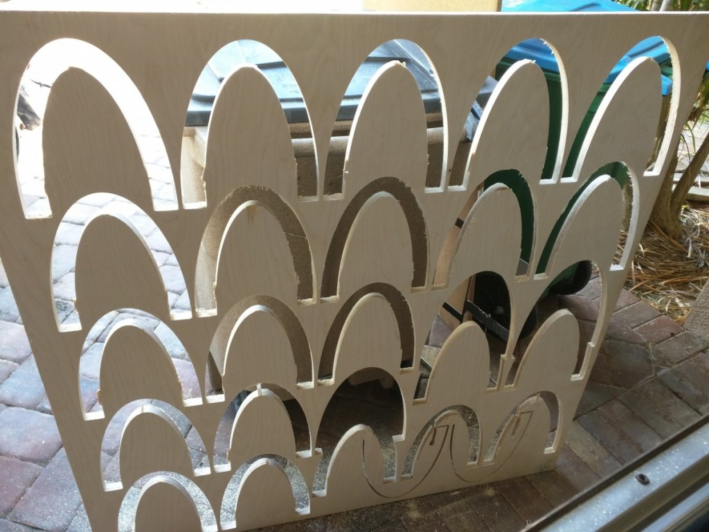

Tried to maximize utilization of the wood while maintaining the integrity of the sheet to keep it clamped down in place while milling. The lower right corner area shows initial attempts at getting even more utilization but this proved unworkable as adjoining pieces would not hold together during milling.
