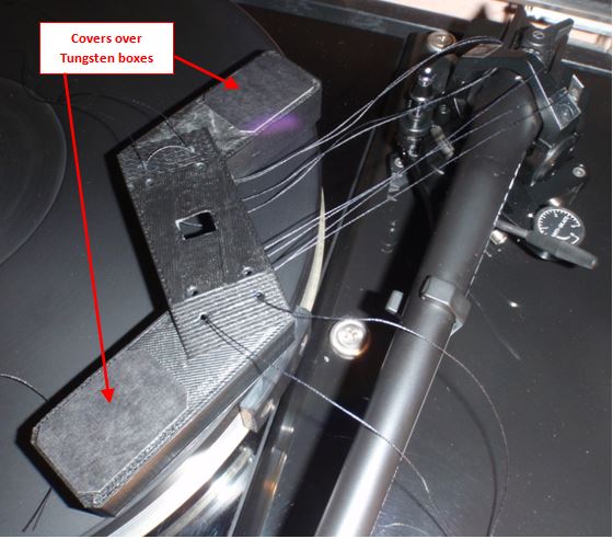

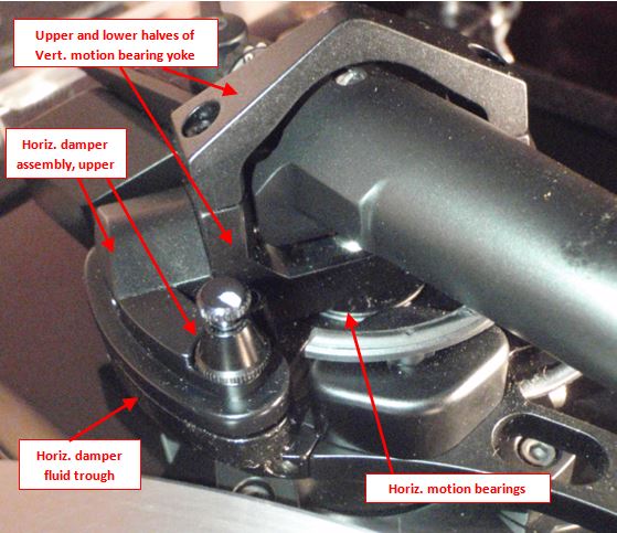

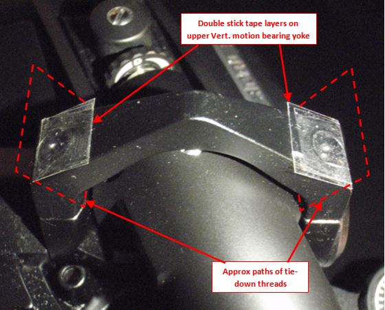

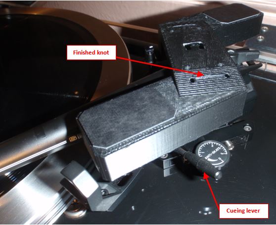

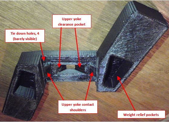

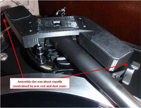

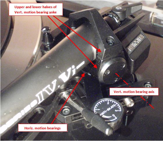

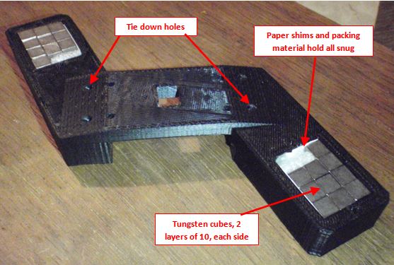

Here's the lateral effective mass enhancement mods done to my SME IV.Vi arm.  May take a little scrolling up and down but my hope is that these pics and captions manage to communicate.  Enjoy!
Fig 1.  SME IV-Vi  outboard side view of pivot zone.
Fig 2.  Inboard side view of pivot zone.
Fig 3.  Lateral Effective Mass bracket bottom view.  (Photo is flipped upside down, as if one was holding the bracket up in the air to look under it)  (Black objects are hard enough to photograph.  With 3D printing you get the added confusion of all the shiny "filamentations".)
Fig 4.  Lateral Effective Mass bracket top view.  Bracket weighs about 25g.  40 total 1/4 inch cubes of Tungsten provide approx 195g of mass at about 2.6 inches off the rotation axis.  The bracket material integrated moment, added, probably brings that up to about 205g effective mass at the 2.6" radius.  Top of the bracket was designed to stay just below the top of the yoke - which comes fairly close to the turntable dust cover.
 (Tungsten cubes are among all kinds of handy weight distribution parts made available for the Pinewood Derby car customizing market.  Yay competitive Dads!!)
Fig 5.  Bracket mounting area, prior to installation.  Double stick tape sometimes makes an excellent, stable way to mate up parts w/o much stress transmission - and if you don't use too much area, it keeps things decently reversible!  The shoulders on the underside of the bracket will contact those tape pads.  Weight forces will press down through the relatively strong yoke assembly side frames.  Once positioned, weight, balance, cushioning and stickiness will keep the bracket assembly quietly in place.  The tie down heavy duty threads will be mostly just as safety - to keep me from accidentally knocking the assembly off.
Fig 6.  Mid-installation with heavy duty threads double strung along intended paths.  I recently cruised through a very entertaining book on knots.  A great knot for this application is called a double surgeon's knot - basically a square knot with double overhand moves.
Fig 7.  Installation complete - arm at LP lead in groove location - outboard view.  The assembly was designed to be positioned high, primarily to free up space for the cueing lever to still be accessible.  Also for that same reason AND to keep the far side away from areas where I'll be lifting the outer LP ring clamp on and off, both arms of the bracket were clocked around clockwise, parallel to the armtube.  Nominally balanced design is maintained.  Riding on the horizontal motion direction bearings ONLY, all that counts is mass amount and horizontal distance from the axis for arm lateral eff mass enhancement.  (only downside is that the bracket covers up the cool SME model number graphics on the arm tube - Oh NOOOO!!)
Fig 8.  Installation complete - arm at LP outer diameter location - inboard view.
Played several LP sides at the end of the evening.  Amazingly enough, everything functions perfectly well...
Finally, like to give a shout out to mgalusha.  This is a bit of payback to the circles.  I benefitted from his and others posts on Hypex ncore amp building.  I do dearly love mine!
And then, as he would say:  "Now go listen to it..."  Next week - SME lateral effective mass enhancement - audio impressions.
Cheers,  John

Curious about the forward/backward placement of the weights on the right/left side of the arm. Would have thought it might be better to keep the weights aligned in the same plane. Can you elaborate a little on this decision?
Thanks
jschwenker
  • Posts: 368
Re: Tonearm Stabilising using Lateral Mass
« Reply #56 on: 15 Jan 2014, 03:38 pm »
Thanks
Hi Bob,
The weights are in the same horizontal plane and also in a single vertical plane that passes through the rotation axis.  Being carried only on the horizontal motion bearings, it does not matter if they are either at the arm height or not, or if they are aligned perpendicular or not to the arm tube or anything.  Let's imagine you are standing on a large ball bearing table with a cinderblock held out at arm's length in each hand.  (I'm not that buff but we can dream)  Now you have a friend get down on hands and knees and try to spin the table.  He would find it about the same amount of work to get the table started no matter whether you are holding one cinder block over his head or both at 90 degrees to that.  Also, if you were to knee squat way down and still hold out the blocks - start or stop work at the bearing platform would still be the same.
In the cases of arm designs where there is no direct access to the structure that moves only in the horizontal direction, additional constraints on the mass locations would come into play as I've described a bit in previous posts.
Yers,  John
