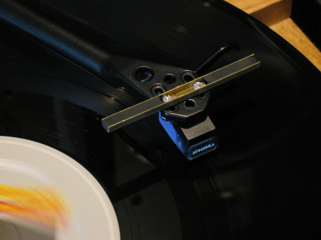

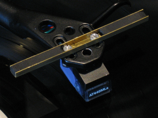

Wayner
Re: Tonearm Stabilising using Lateral Mass
« Reply #35 on: 9 Jan 2014, 09:25 pm »
dlaloum
  • Posts: 710
« Reply #36 on: 9 Jan 2014, 10:18 pm »
 :) Longhorn II...
The only downside here is that it adds EM vertically as well as horizontally - so if the arm is too light to start off with all is fine, but if it is well matched to the cartridge, it may not be ideal.
I also like the fact that it seems to be using plasticine/modelling clay - an added bonus of midrange arm vibration damping.
neobop

Pretty cool Wayner.  I do something similar with my Unitrak, only without the clay.  The arm comes without a finger lift and a conventional one seems to throw off the lateral balance.
Actually, Longhorn II isn't a tonearm stabilizer.  It's a cart stabilizer mounted on the headshell.  The weight is 90o from the offset angle and not the on the plane of the pivots.  It could increase the force vector that causes skating.  Not sure if it makes much difference though.
