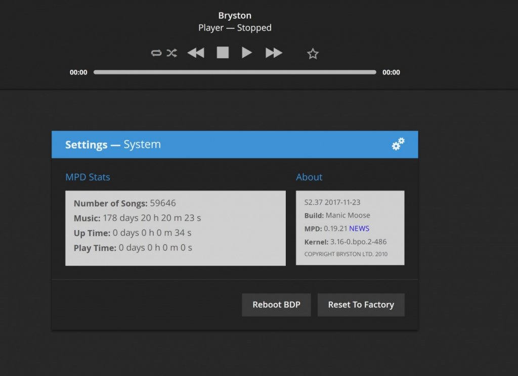

FYI, Updated to:
S2.37 2017-11-23
Build: Manic Moose
MPD: 0.19.21 NEWS
Kernel: 3.16-0.bpo.2-486
COPYRIGHT BRYSTON LTD. 2010

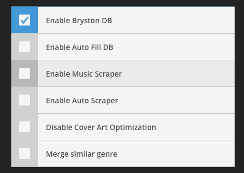

I rebuilt everything: cleared cache and reset bryston DB. When I load the Artists View, all I see is this (forever):
For what it's worth, here are my Bryston DB settings (yes, I tried turning things on/off, but nothing worked):

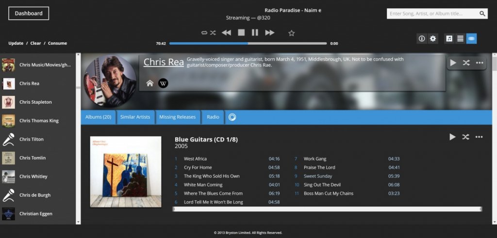

Re: Manic Moose (S2) - BDP's third major firmware release
« Reply #2314 on: 25 Nov 2017, 04:24 pm »
Here's mine with 11/23

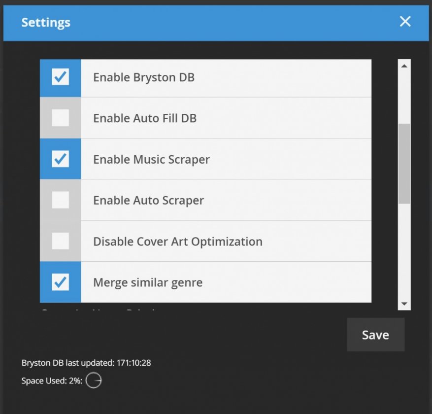

EDIT: I reverted back to:
S2.36 2017-10-06
Build: Manic Moose
MPD: 0.19.21 NEWS
...and I still have the same problem. Also, the Settings dialog is reporting "Space Used: 52%". I previously did a factory reset, but that doesn't seem to have changed anything.
I don't know what to do from here, except disable the Bryston DB and just use Soundirok. Sorry... I'm sure everyone is feeling chilled from the Larry Dickman's thread on Bryston cultists, but I am frustrated trying to make MM work for me.

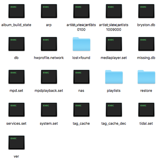

...and here is an image showing the entire contents of the USER folder:
The only change I've made was to add some *.m3U playlists and I've added the last line to mpdplayback.set:

Here is an image showing the entire contents of the USER folder:
