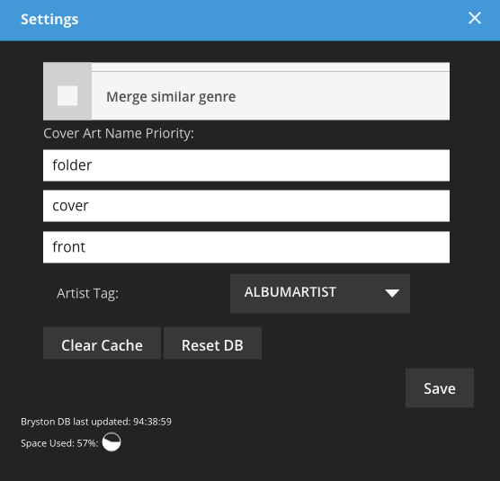

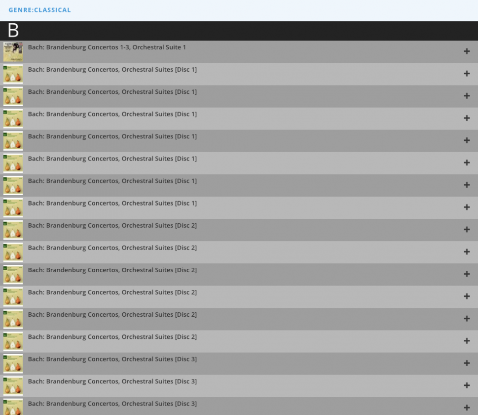

Running: S2.37 2018-02-13
I just wanted to bump the "Album Artist" issue with the Media Player.
In the Bryston DB settings, I definitely have Album Artist selected for sorting:
...but when I browse by genre in the Default View, it looks like this:
...as these files have different ARTISTS for tracks, but same ALBUMARTIST for the album.

This has nothing to do with cover art.
This is displaying an ALBUM as a single collection of tracks, under the Genre view. Many of my albums (e.g. the example shown) are from multiple artists, per track, but have a single ALBUMARTIST for searching/indexing.
This should be resolved in thursdays release, a rebuild might be required, but otherwise should be resolved.

« Reply #2375 on: 7 Mar 2018, 05:33 pm »
Chris
Thank You! I will completely rebuild and post back my results, after Thursday.
Chris
Fixed. Thanks!
