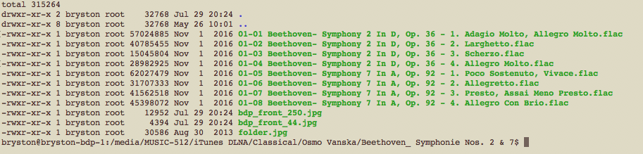

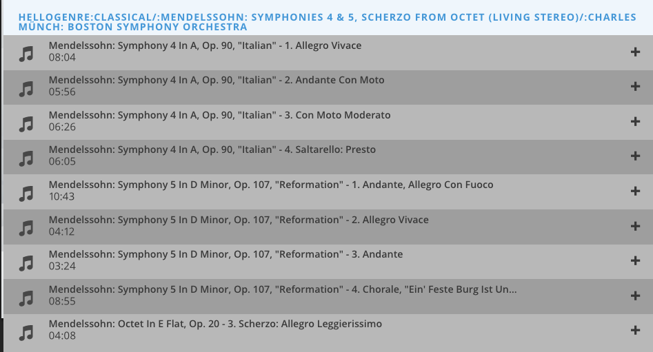

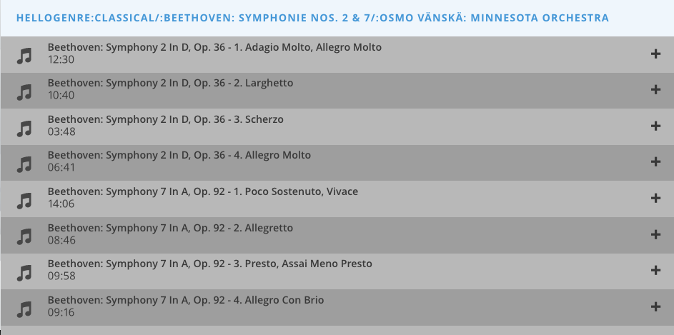

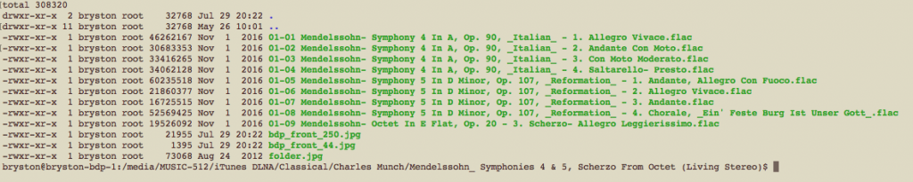

These images show both the MEDIA PLAYER view and the ssh command-line view of the same albums. Both are examples of albums missing album art thumbnails, when browsing by Genre, for example. The album art does display in the main MEDIA PLAYER window, while the music is playing.
One thing that seems to be common to all that are missing thumbnails: an ampersand character.
For the stuttering issue, it happens only at the start as it is loading/displaying the background image for the artist. As soon as the background image has displayed, the stuttering stops. Again, this is most common on high-res files (i.e. 192/24).

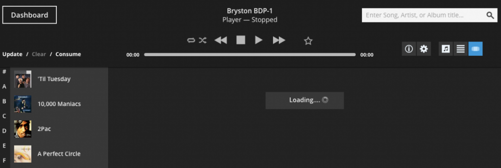

I rebuilt everything: cleared cache and reset bryston DB. When I load the Artists View, all I see is this (forever):
Addition: FYI, this problem has returned, as shown in the above image. It seems to happen if I play a song from the Artist View, switch to the Media Player Default view (i.e. view the playing album), then click into the Artist View again. Whatever previous Artist I was viewing shows loading, forever. The other Artists I can view, just fine.

« Reply #2407 on: 16 Aug 2018, 02:29 pm »
K, let me know if today's release has the same problem, I'll check it out my self later tonight.
Everything is fixed (minus the stuttering issue, which is still there).
Complete art work coverage in all views and no more "Loading..." hangs.
Nice work!
