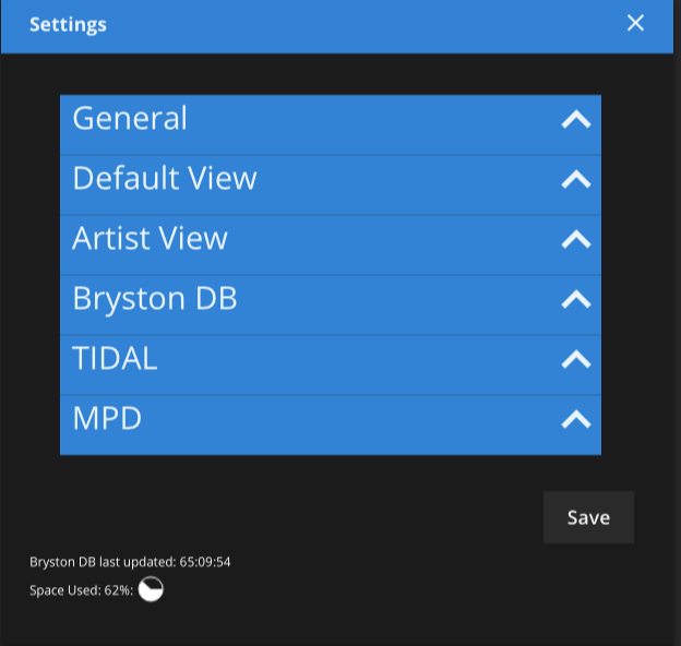

I'm a little worried about the continuous increase of Space Used.
FWIW, I have less than 797 GB of music and graphics files.
What is it that is making it to grow fast? - is it something related to "Scraping" or is it some other setting that could be disabled?
Scraping goes forever and goes slow, but maybe this is not an issue.
These are my settings, and ~75% ... growing.

« Reply #2428 on: 16 Sep 2018, 06:24 am »
Hi Fernando,
That's reporting the user space partition (its part of the BDP's internal flash), as you use the Bryston API and explore your music library it will cache more and more data and thus consume more space.  If your worried about running out you can configure a scratch drive (a designated drive to cache files) and the BDP will move the existing cached files to this drive and continue to use it as the designated cache location.
http://support.bryston.com/downloads/BDP/Manic%20Moose%20Manual.pdf
Chris

Hi Chris,
a few minutes ago I updated firmware to S2.38 2018-09-11 -
to my surprise, Bryston API shows unchecked in Settings ...
don't know what to do now ... Space Used reached 76%
I may plug a 32GB USB flash drive and set it as scratch drive, but don't quite like the idea. Would it be large enough?
yes, Bryston API shows un-checked:
Krutsch

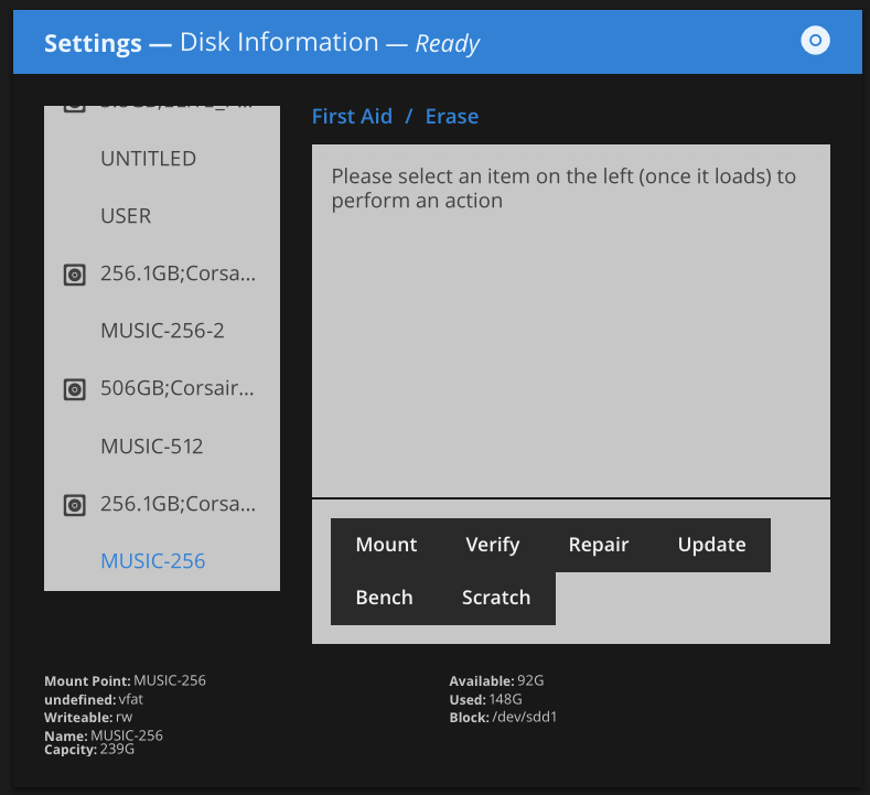

So, I have a scratch drive configured, but I still have the same issue - user space partition continues to be consumed.

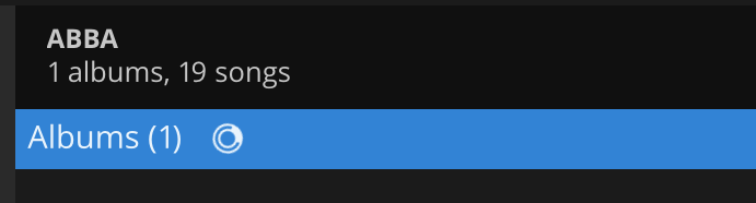

Does that also disable the Music Scraper?
I am noticing that with the Default View -> Enable Artist Info (Bryston API) disabled I only get the spinning wheel and I never see any Artist Info in the Artist View.
I am referring to the spinning wheel to the right of Albums (1) in the example:

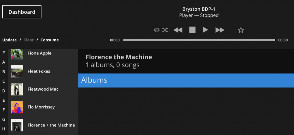

One more defect, after reviewing my library with the current BETA build:
S2.38 2018-09-11
Build: Manic Moose
MPD: 0.19.21 NEWS
Kernel: 3.16-0.bpo.2-486
In the Artist View, Florence + the Machine trips up on the '+' symbol. The band really is listed with the '+' instead of an 'and'. In the Artist View, the listing shows 1 album with 0 songs. In the Default View, it lists and plays just fine.
Notice that the '+' is missing from the Artist name in the white on black banner, but is shown correctly in the lists of artists on the left.
mine, it was consumed from 76% this morning to 88% now ... i bet it will reach 100% soon.
how large should scratch be?
Fernando.-

« Reply #2435 on: 19 Sep 2018, 12:37 pm »
Hi Fernando,
To give you an idea of how much space your currently using the user space that the pie chart represents is the following sizes
BDP-1 & BDP-2 (1GB), so a 32 GB thumb drive would provide 32x the storage
BDP-3 (20GB), so you’d gain roughly another 1/3.  We dilberatly gave the BDP-3 all lot more space as it was being designed while these software features were being developed.
BDP-Pi (3GB), so you’d gain 10x the storage.
Hope this helps
Chris
Is this still broken?  If so could you place the bdp into service mode and email me the service id?

« Reply #2437 on: 19 Sep 2018, 02:19 pm »
Hi Fernando,
Hope this helps
Chris
Hi Chris,
I will start by using the thumb drive, 'though I was just about to mount a new 2TB MyPassport.
I held myself because of the 500mA warning on page 5 MMoose manual, and still don't know how many mA does it need.
Hope I can use it as another back-up of my music files. Feel that those MyPassport are power-hungry, have had bad experiences with early models.
Fernando.

Chris,
Another related question: If I have 2 disk units ( or 3, 4, 5 disk units ), with the very same file contents ( each one is a copy ), then: does User Space double, triplicate, x4, x5 etc. ? - or does it remain the same, as files are the same into each attached disk ? - or does it increase following a different ratio than y=2.x; y=3.x; y=4.x; etc. ? - Space Used jumped from 1% to 2% after I put the NAS online and Reset Database, but not sure.
The thumb drive seems Ok - nice to have only 2% of consumed User Space, and it scrapes faster too, in fact the BDP2 tells me it has Finished Scraping  :thumb:
Fernando.-
