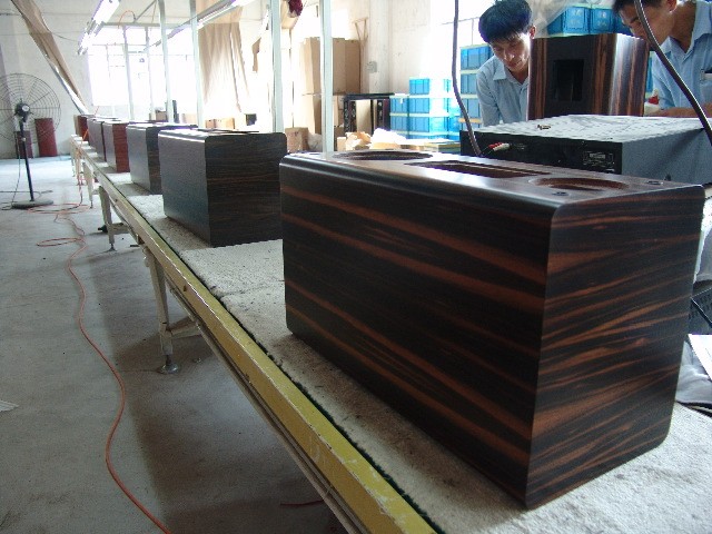

John Casler
VMPS 626R upgrade anyone?
« Reply #65 on: 11 Jul 2004, 06:03 pm »
Quote from: azryan
I think too it was overboard for you to post pics of those MLS cabinets though but just my opinion based on the fact that the pics of the poor quality of the 626 cabinets Danny was handed were not posted here (and not meant to be posted anywhere public).
Again for informational purposes:
Here is a picture of the "exact" cabinet in question taken by me since I owned them for over a year

It is not an upcharge to get the MLS cabinets.  Only certain models are being made by MLS (626 is one of them).  BTW, my RM 40's weren't made by MLS and the cabinet work is very good (I have the Cherry finish and they were purchased at the end of 2003).
Well the pics and graphs are out.  If Danny truly didn't want them out, he shouldn't have given it out in the first place.  I personally think that was just a way of later on saying "I never released them myself".

That is a very nice picture John....
However not exactly the type of picture I'd like to see if I were judging the build quality of a speaker  :!:
I know that VMPS has never been touted as having even 'average' quality cabinets. However, this is totally unacceptable.  I was shocked to see that Danny could fit a pencil in a gap between the woofer and the cabinet  :!:  :nono:
