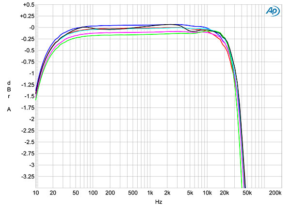

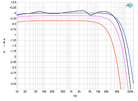

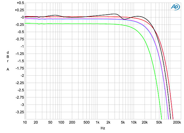

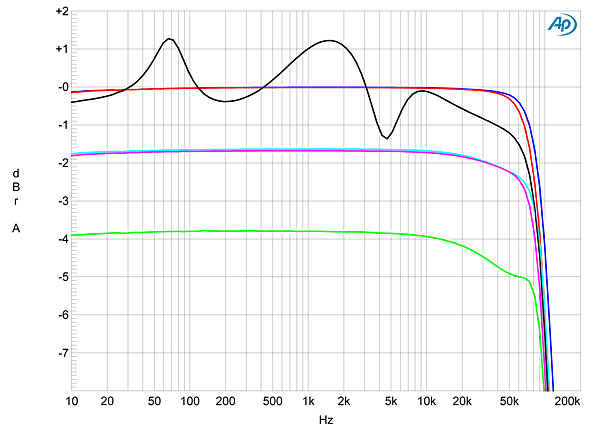

To flesh that out, let's look at some measurements from Stereophile. In each case, focus on the black curve. (They call it grey, but it looks black to me.)
Here is the frequency response into a simulated loudspeaker load of the most recent tube amp Stereophile tested, the "Octave Audio RE 290 power amplifier," which has a source impedance greater than 2Ω:
By comparison, here is a high-fidelity amplifier with source impedance measured at ≤0.16Ω (Mark Levinson 532) into the same simulated speaker load:
And another high-fidelity amp with output impedance measured at ≤0.17Ω (Bryston 7B-SST), into the same simulated speaker load:

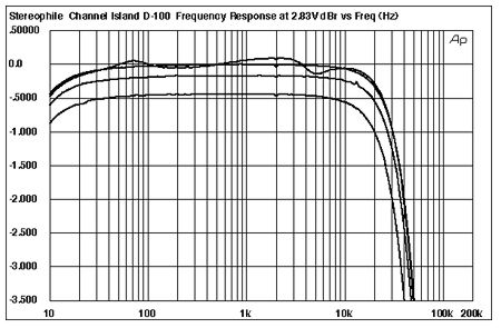

As for class D, I'm not aware of a Hypex-based amp that was measured into Stereophile's simulated load, but here is how the Icepower 125ASX2 module, as found in a recent Bel Canto integrated amp, measures into the same simulated load:
Will a tube amp sound different from the three high-fidelity amps? (Those three amps won't sound different from one another to people who listen with their ears rather than their eyes or wallets, so long as the 125ASX2 can reach sufficient levels at a given listening position in a given room with a given pair of loudspeakers.)  Considering that there are FR differences in excess of 1dB in the 1-2 kHz octave even into the relatively forgiving Stereophile/Kantor simulated load, a attentive listener should hear a difference between them even level matched.
Now, given there is an actual, non-illusory difference between the high-fidelity amps and the lightbulb thingy, one could of course prefer the lower-fidelity reproduction. But...I suspect if someone replaced a tube amp with a commodity AB amp used miniDSP with parametric filters in front of the AB amp to mimic the effects of its source impedance on the set of loudspeakers used for the comparison, there would be no differences to hear.
Stereophile measured the Channel Islands D-100, which is Hypex UcD-based, in 2005. The curve with the slight wiggles is the response plot into the simulated loudspeaker load. Looks very good!
