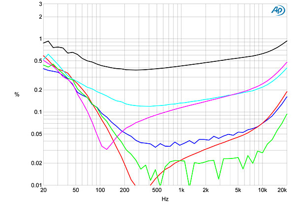

I think it should be firmly borne in mind that if the tube does put out 3X or 4X it RMS rated power on music peaks the frequency extremes, 20Hz and 20Khz, will be compromised due output transformer core saturation and inter-winding capacitance effects.
Both of these graphs are best case representations of what the amp can do. They do not portray what the amplifiers full rated power bandwidth looks like. Also not shown is what happens to the distortion versus frequency relationship at full rated power levels. If such graphs were included in the measurements most mfgrs. of tube amplifiers would cry foul and pull advertising from the magazine. Graphs below from Stereophile magazine.
Fig.1 Octave Audio RE 290, frequency response at 2.83V into: simulated loudspeaker load (gray), 8 ohms (left channel blue, right red), 4 ohms (left cyan, right magenta), 2 ohms (green) (1dB/vertical div.).
Fig.7 Octave Audio RE 290, THD+N (%) vs frequency at 2.83V into: 8 ohms (left channel blue, right red), 4 ohms (left cyan, right magenta), 2 ohms (left gray).

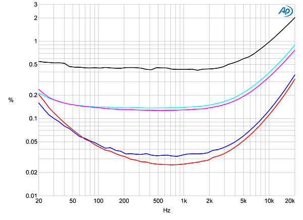

The graph below is the kind of graph that is missing from tube amplifier reviews. This is the solid state Musical Fidelity AMS 100 power amplifier's distortion versus frequency response behavior at 50watts output into an 8ohm load.
Fig.8 Musical Fidelity AMS100, THD+N (%) vs frequency at 20V into: 8 ohms (left channel blue, right red), 4 ohms (left cyan, right magenta), 2 ohms (green).
 The effects transformer core saturation and inter-winding capacitance at higher powers are grim and contribute markedly to the perception of the tube amplifier's performance when asked to produce more than a couple of watts.
This is a fact of life and in no way accounts for anyone's preference for transformer coupled tube amps.

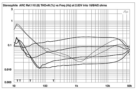

Here are a couple of graphs from Stereophile. The Audio Research Reference 110 and the Audio Research Reference 150.
Fig.8 Audio Research Reference 110, 8 ohm tap, THD+N (%) vs frequency at 2.83V into (from bottom to top): 16, 8, 4, 2 ohms (right channel dashed).
Fig.7 Audio Research Reference 150, 4 ohm tap, THD+N (%) vs frequency at 4V into: 16 ohms (left channel green), 8 ohms (left blue, right red), 4 ohms (left cyan, right magenta), 2 ohms (left gray).
Fig.7 plots the THD+noise percentage from the 4 ohm tap into loads ranging from 2 to 16 ohms at a level, 4V, where the actual distortion rises above the noise floor. The THD increases at low frequencies due to the onset of saturation in the output transformer, and in the top octave due to the decreasing open-loop gain margin in this region reducing the effectiveness of the negative feedback. But over most of the audioband, and when the load impedance is very much higher than the transformer-tap value, the Ref150 offers low distortion. The picture from the 8 and 16 ohm taps was similar (not shown), but with higher levels of distortion overall.
Remember, we are seeing increasing distortion due the effects of transformer saturation at only 2.83Volts into 8ohms at 1watt of output, contrast this with the performance of the Musical Fidelity AMS 100 at 50 watts into a 8ohm load in my previous post.
