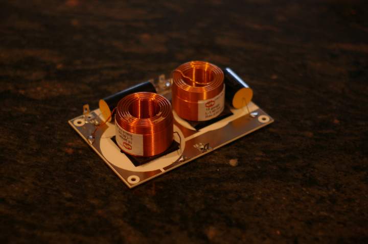

The inductors are Jantzen 18 AWG air core and the Caps are Dayton Audio Polypropylene. I use the Dayton pre etched 2-way PC board number 260-130 which makes a nice finished product. I typically mount them on the baffle back with rubber washers.
L1 =  1.80 mh 18 AWG
C1 =  7.5 uf
L2 =  1.40 mh 18 AWG
C2 =  5.6 uf

Above is the X-over schematic for the original design.  Honestly, I would stay with the MCM + Vifa top as is.  Then run plat amps for the helper woofers.  Its the helper woofers that allows you a little flexibility to add your own touch.  A single 15... dual 10's or 12's... kinda depends on what you want for a baffle size and of course your own preferences for good bass characteristics such as speed, attack, extension, power handling.output, etc., etc.
Have fun with your build and check in with any questions.  Can't wait to hear the progress.

Slowest build in history update pic. Crossovers built for xt19 and mcm combo. Perhaps will be finished at Christmas....

Congrats Newbie!  Let us know how you progress over the holidays... looking for forward to you getting some OB sound!!!

One more step guys.  Even though I only have a plywood baffle I wanted to use this project to learn some skills. So I spent Saturday (took a good few hours) to do the recess for all drivers, not just the tweeters.  I used a rabbet bit but unfortunately only had 12.7mm as the maximum so had to do some sanding to fit the MCM.  I am about 1mm off on all the drivers after a test fit.  I was wondering, how does everyone screw in the drivers.  I have the baffles balanced between two cardboard boxed and I am dropping in the drivers through the holes but it is not easy, kind of need 4 hands to do this properly.
