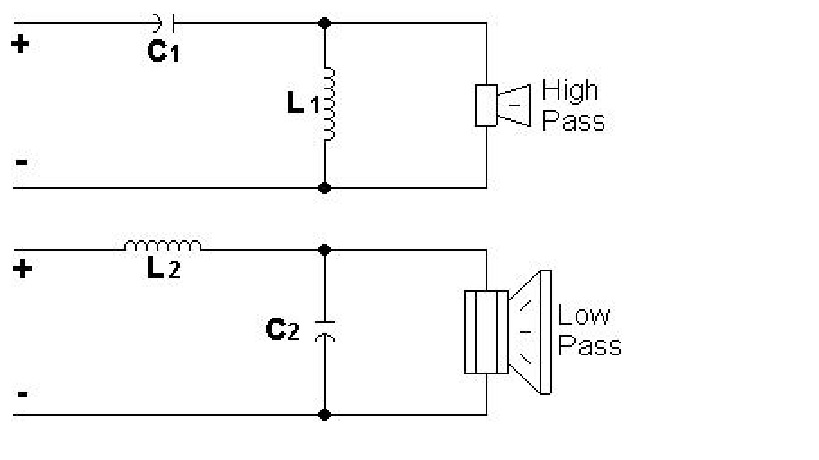

Hi Matevana. I have all parts to construct the Hestia using three mcm drivers per side. They were on sale for 14.95 over the holidays. I constructed the cabinets with a u frame for the bottom two woofers. I will be powering with a tpa3116 for the top end and a yung 100 watt plate amp for the woofers.My problem is that I am quite the novice in crossover building. I have seen the diagrams but do not understand them. Could you draw a simple picture of the crossover board with parts and solder points and speaker hook up. Thanks for sharing your knowledge and passion for our hobby.Lloyd Bruney

Hi Lloyd,
Sure thing! See the diagram below for the connections. C1 and L1 represent the capacitor and inductor pairs for the tweeter; C2 and L2 for the woofer. Typically the (+) and (-) connections furthest from the speakers get wired to the (+) and (-) ends of a speaker terminal, so you can easily unplug the speakers as needed. If that still isn't clear just email me and we can go through it in more detail.

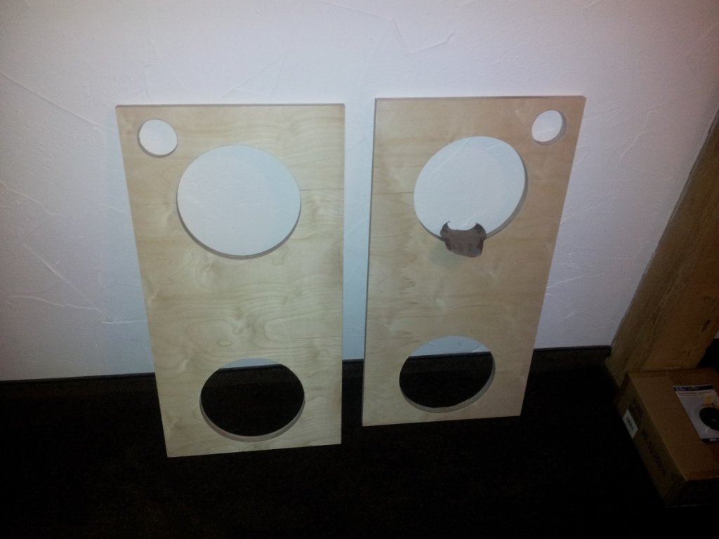

Dear Matevana and fellow Hestia OB owners/builders
1.5 years from first thinking about this project I am almost there with lots of ups and downs for a total beginner. Pircture attached to prove I am actually progressing. Holes all cut and crossovers ready to build. I even understand the crossovers
. However one simple thing stopped me tonight building them. How can I use the cableties to fix the coils. There is only 1 hole in the pre-etched boards from PXpress. It would be far easier surely with two holes. Can I drill extra holes. I looked at the pictures and I cannot see how to do it with just one hole securely. Sorry for such a simple and dumb question but it is stopping me progressing to the final stage!

Hey Newbie!
Great to see the progress. Should be pretty easy to drill a 2nd hole in your board. Are you able to upload a pic of the board you are working with?
