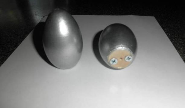

The dustcap mod was a little spooky and you will likely tear some of the top fibers leaving a ring where the cap was. No real harm though. If that doesn't bother you, then what I did was cut an "X" in the face of the cap from the center out to the edges giving you 4 "pieces of dustcap pie". Then gently and slightly lift the corners of the area glued to the cone and SLOWLY work the X-acto knife around the circumference cutting as closely as possible to the cone. I built the "phase plugs" from discs of wood cut using a 1-3/4" hole saw for the insert in the pole vent and a 2-1/8" for the remaining 3 discs. I then glued them together, ran a 1/4"x4" bolt through the pilot hole, squeezed it all together with a nut and formed the final point rotating against an angled table saw blade. This will make most shop class instructors cringe, so be safe!
The pole piece vent is EXACTLY 1-1/2" in diameter, so a dowel cut to 3/4" deep is also viable.

I think it was AC member PoultryGeist who came up with the idea for using wooden eggs found at craft stores as phase plugs. He put two (or 4) screws in the base and the "plug" was then held in place magnetically by the driver's own magnet, after performing the dustcap-ectomy procedure described above.
brad944911
Posts: 52
Re: Hestia OB, an ambitious low cost, 3-way OB design
Reply #274 on:
3 Mar 2015, 07:40 pm »
Yea, I saw that. I didn't realize he did it on the MCM's...that woulda save me a LOT of fabricating!
