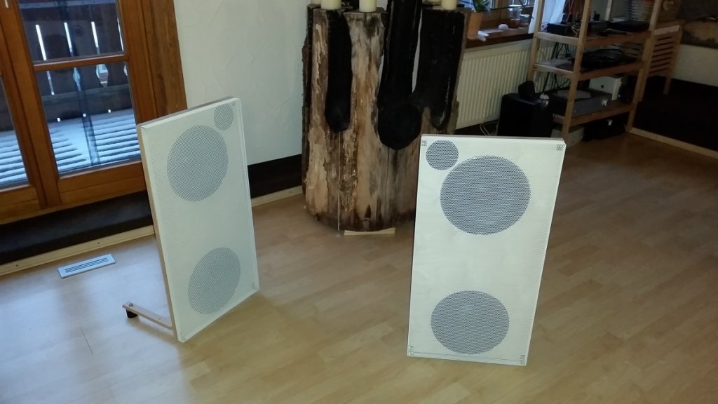

So I finally got the project up and running (not done, right Ed) and am enjoying it a lot!  My 16 year old son was listening with me as we compared these with the 1.6's (still for sale BTW) and he liked them a lot more.  We auditioned several discs and DVD's.  Now bear in mind I know 16 year old ears are not truly qualified to judge, but it was a good bonding moment and experience as he has been helping me out.  I did make a few mistakes painting them that I will address next year, but for now, I'm ready to get fat and listen to these things...it's the holidays!!  :green:  Anyway here are a few pics. Merry Christmas and Happy Holidays you guys!!

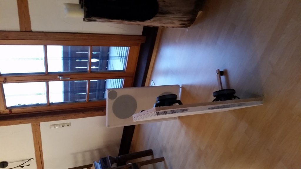

Unfinished but playing, Santa cant wait...

Very cool!  Really like the way the design came together. Is that 1" MDF? What are you using for speaker wire?

« Reply #256 on: 25 Dec 2014, 03:37 pm »
Hi Matevana.
Wood is Virola panel 5/8  (sandwich 2 gave me almost 1 1/4 thick)
Cables are Cat 5 with snake oil fermented :green:
Not finished, maybe white Duratex.
Cross are going to be concealed.
First OB design listening. They are very open...
Would give my review in a few weeks, so far, are goooooood.
Matevana thanks for sharing this desing... :thumb:

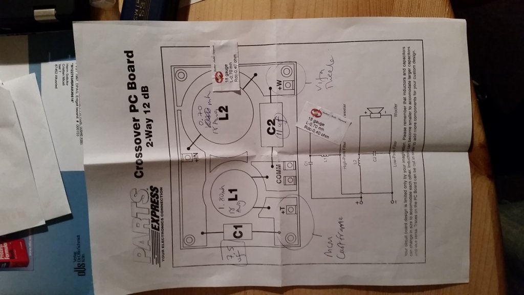

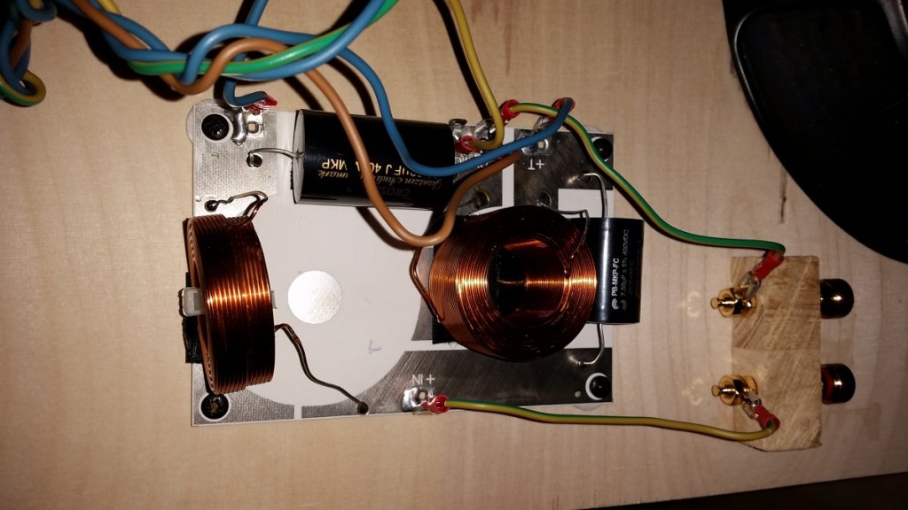

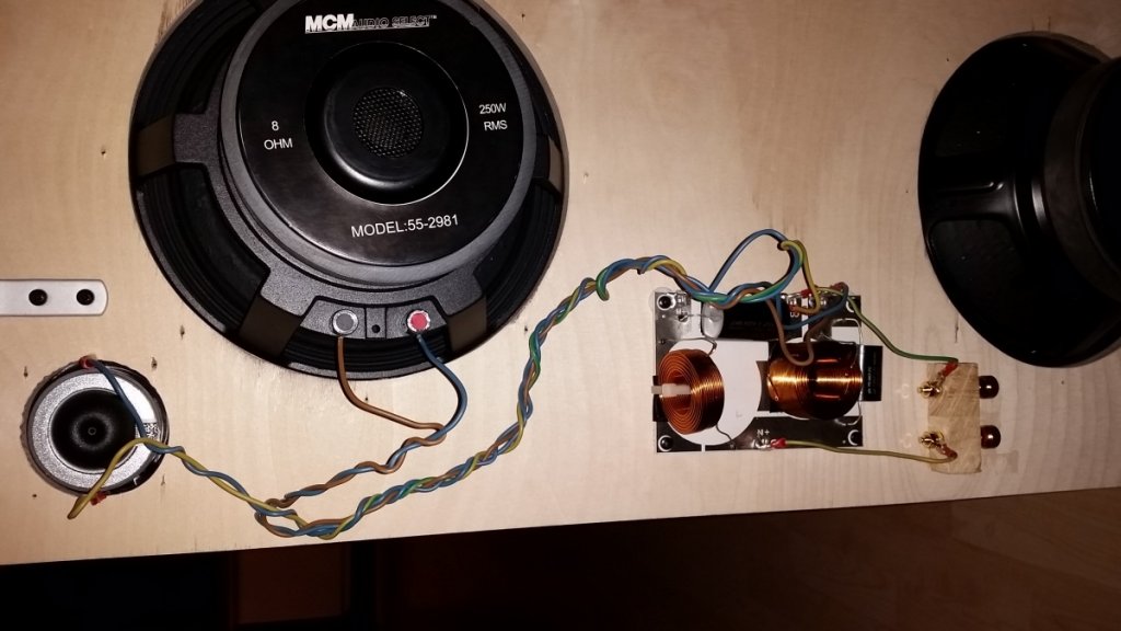

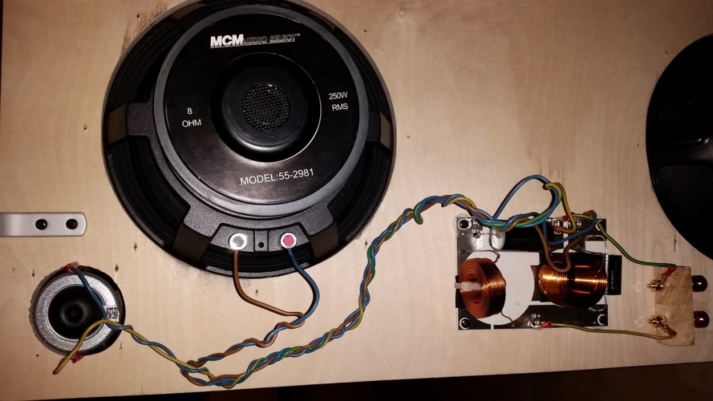

Dear Matevana, Dear Hestia OB owners
Well I finished the build but I think without success.  Being so sure I had wired the Crossover correctly (for the XT19) I plugged everything in and off I went (sorry should have slowed down).  Anyway the sound was not too bad but the Xt19 have what sounds like distortion after a certain volume level.
I studied the various crossover postings numerous times before building the cross over but my complete lack of electronics knowledge is probably getting in my way.  I have attached some pictures to see if anyone can help.  Because of C1 and L1 in Matevana's design being for the MCM driver I thought that the plus connection labelled +T must be for the MCM and that the +W must be for the XT19.  L2 and C2 are soldered to the +W connection (being 0.70 coil and a 12UF cap for C2).
I am lost as to what I have done wrong.  Any help to make my Christmas better would be great.  I have waited 2 years for this moment and now feel a bit deflated.  I hope I have not ruined the Xt19s in the process but luckily they are not too expensive if I have.
Thanks in advance for your collective help!!!
