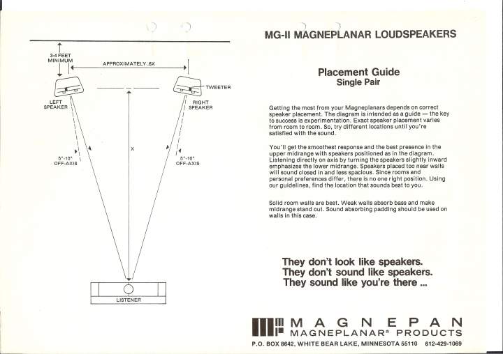

Here is the placement guide for the IIa I had in the early eighties. In those days Magnepan was recommending a more narrow triangle.

They also recommend tweeters outside and only 3-4 feet as minimum from the rear wall.  :scratch:
The best way is to test it out in your room and if you hear good you will define the correct position. Also you must try unconventional positions and placement. Not  just with the book in your hands and making +- 5 inch movements from the suggested placement.
