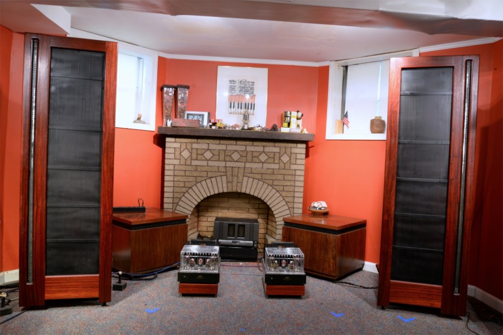

Okay Steve,
Here's another photo, which shows a little more than the previous one (the one a couple of posts up illustrates the absolutely perpendicular relationship between the panels and the side walls). Actually, this photo is inaccurate, because I nudged the 3.7s a little closer to the side walls a few days after taking it. The speakers completely disappear and the room's apparent dimensions swell, but there is still specificity to points in space from which the sounds seem to originate. I don't get the sense of exaggerated scale, but it gets
enormous
with certain types of material. If the imaging weren't stunning enough, the frequency balance also seems to have improved.
There are a few others who have been fiddling with this setup and we all (so far) find it intoxicating. I had to move my 3.7s a little closer to the front wall in order to get them this close to the sides. My speaker cables limit my 3.7's distance off the front wall to 8'7", which seems fine to my ears.

Looks like good distance from the wall behind plus you have some diffusion going on back there. I know what that can do for both stage depth and atmosphere. That stuff is important to me, too, as I listen to lots of music made on location. Moving one's chair forward can give a taste of this plus a little added width. Or, further away, of that. Bet your sound is wonderful.
