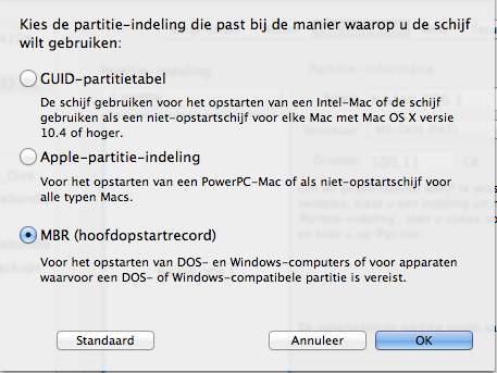

Re: upgrade/update BDP for larger hdd sizes?
« Reply #112 on: 10 Dec 2011, 05:25 pm »
these are the formatting-options on a MSDOS (fat32) partition:
Which option would be preferred for the HDD's attached to the BDP1? Or put differently: which option does not lead to the Unsupported_FS error?
Marius

skunark
  • Posts: 1436
« Reply #113 on: 10 Dec 2011, 07:08 pm »
I haven't hit that error and I select the MBR.     GUID I would expect to work for all unix and Linux based OSes today.   The middle option is Apple's old old old file system table.
