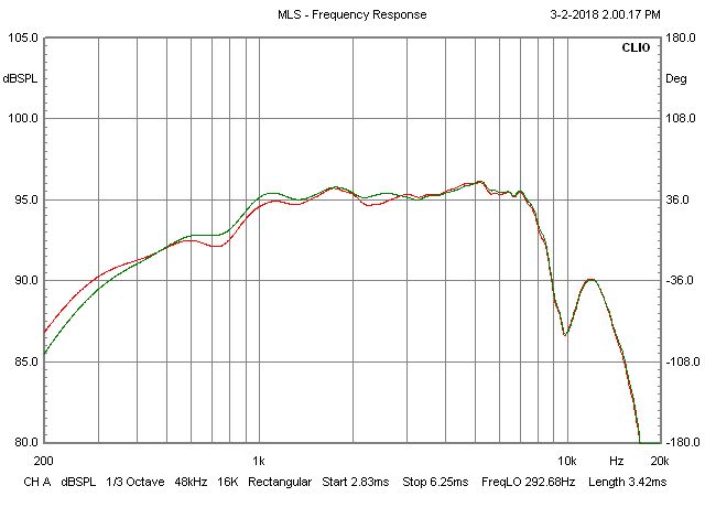

So for reference, here's the original Neo10 on-axis response in the super mini frame:

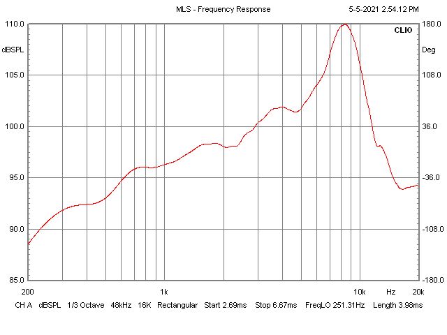

Here's the GRS 10:
Despite its rising response peaking at 110dB, It seems to be a little more effecient and can play a little lower than the original BG10.

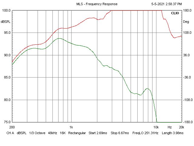

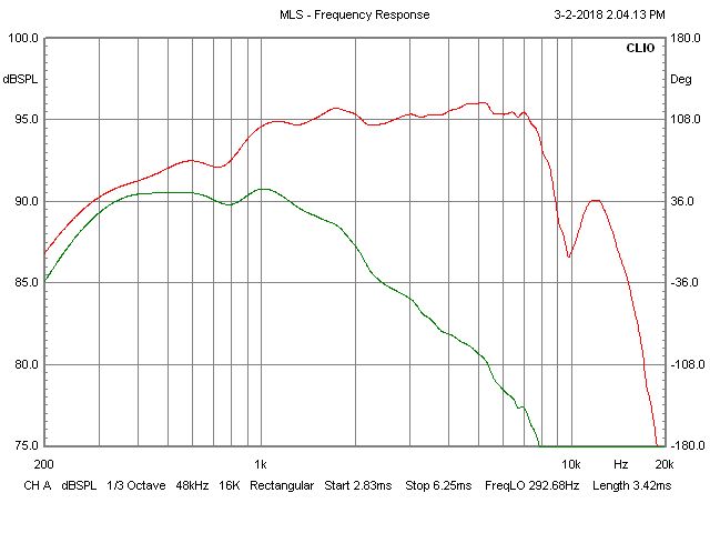

Here's the response of each with only an inductor in the circuit:
BG Neo10:
GRS10:
The hump at 700Hz needs to be brought down with a notch filter, vs the BG model that only has a 2nd order filter, but it definitely is a workable alternative!  :thumb:

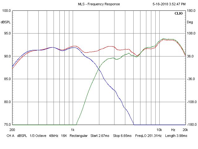

Here's the original Super-mini response including the GR Neo3, both using a 2nd order filter.

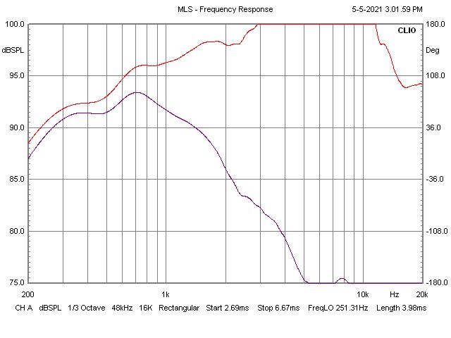

Here's the GRS10 using the same 2nd order filter, without a neo3/GRS3 to match it.
Didn't get a chance to include a notch filter in the results, but its still good to hear it should actually be a pretty good alternative for those looking to build a SuperMini/ Lineforce, without hunting down the BG units!
