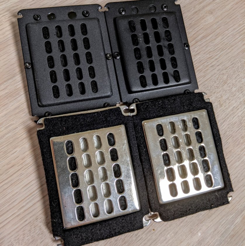

Managed to snag a deal on a pair of older, used Neo3 PDR tweeters for $75 on ebay. They're some kinda ugly "chrome" models, that used the older bodyframe before the more recent 6-rivet design.
I'm curious to test them since they're different aesthetically, but more similar to the GRS-3 where it counts. Hopefully their age/condition won't be too much of a factor in their results, cuz i do know that older models are known for failing prematurely.

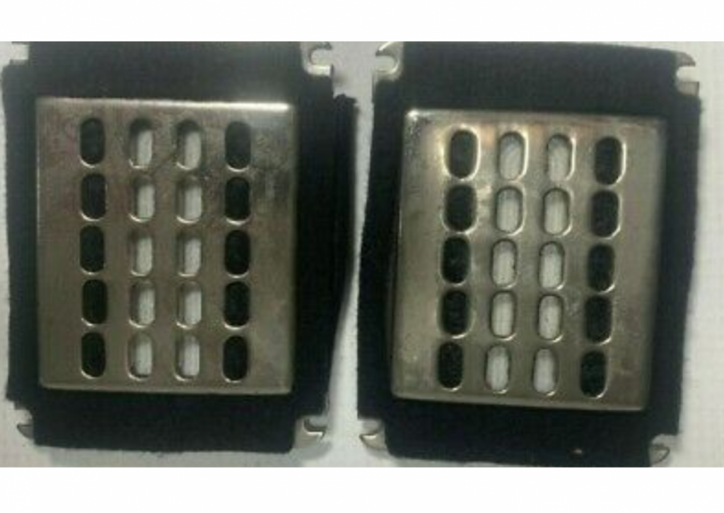

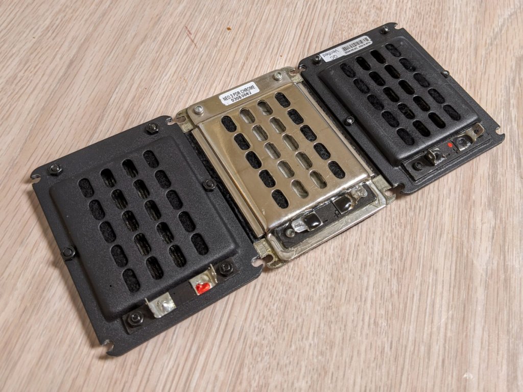

Got my Chrome Neo3 PDR tweeters yesterday!
They're actually kinda pretty once you wipe off the finger prints and smudges... lol

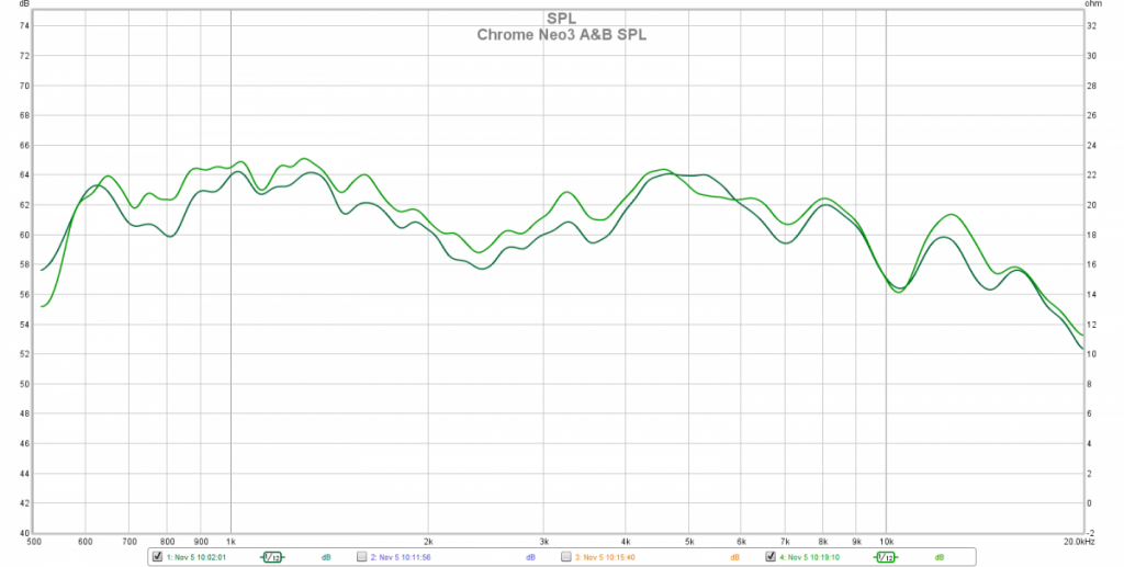

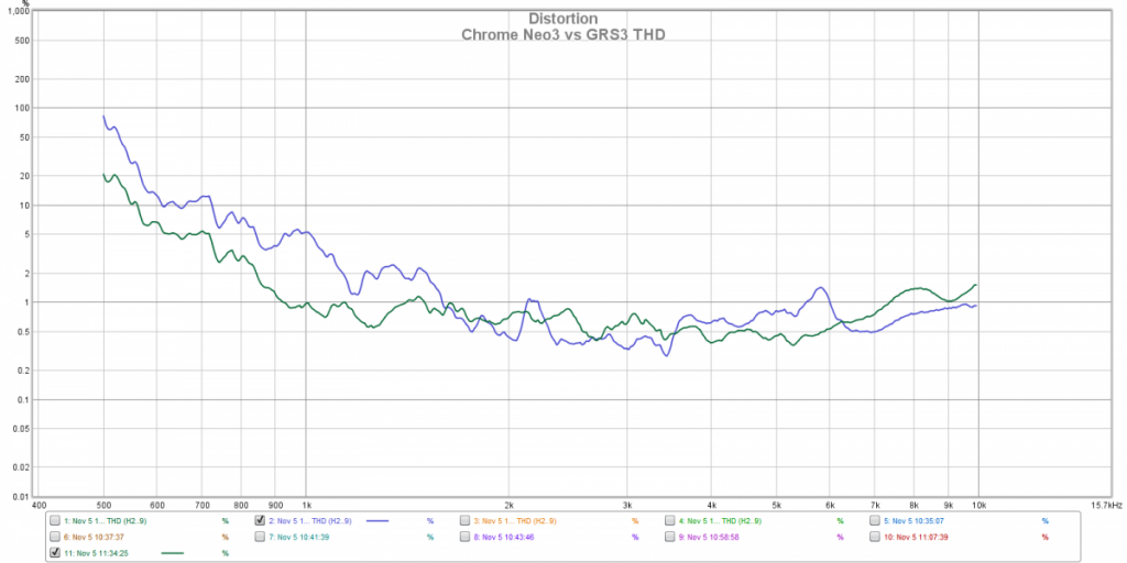

I also did some A-B testing with each chromed Neo 3 to see how they measure.

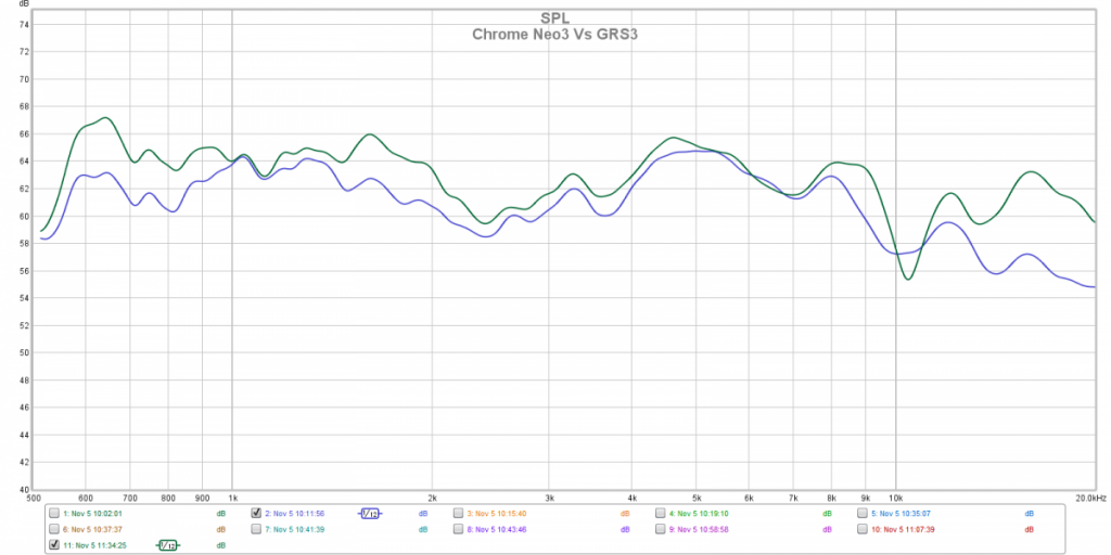

SPL:

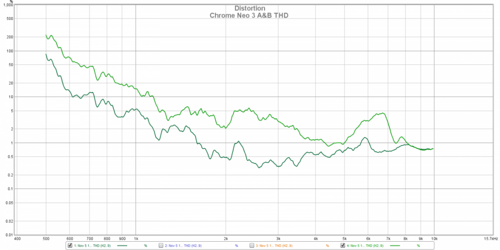

THD:
Yeahh.. One of these are definitely blown out, it sounds horrendous... at least I got one working model thats somewhat similar to the GRS 3.. :P
it doesn't appear to be torn/shredded like my Neo 3 or original GRS3 tho, so possibly a tensioning issue with the disaphram?
SPL:
THD:
Purple: Neo3 PDR      Green: GRS3
The GRS3 is about 5dB more effecient (not shown here), has a better response top-end except for the dip around 10K, & the THD is cleaner below 1500Hz.

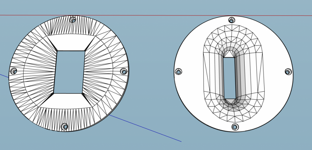

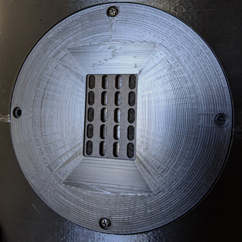

I worked on a design for a faceplate that mimics the stock BG faceplate. As well as a fun design that covers the outer two rows, narrowing the width of the waveguide to see if that can remove the 10dB drop around 10K Hz.
I also printed out the faceplate, hopefully i can test it tomorrow, and print the narrow waveguide tonight.
