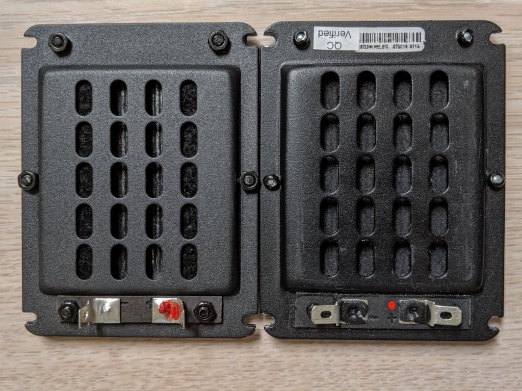

I just got my driver in today and wanted to compare the new GRS (Great Replacement Speakers) "Neo3" clone side by side with my standard (Non-PDR) BG Neo3.

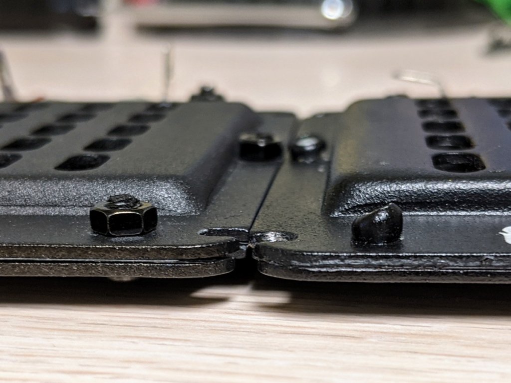

The first noticable difference is the use of bolts/nuts over rivets.
The position of the face also appears to be more simetrical top to bottom, where the Neo3 has its face shifted about 2mm higher.
The grill holes are also slightly smaller and are again, better centered within the protruding face, but its an issue that may arise more noticeably with waveguides or mounting plates.
The buffer layer between the magnets & diaphragm appears to be thinner on GRS model when compared to the Neo3.

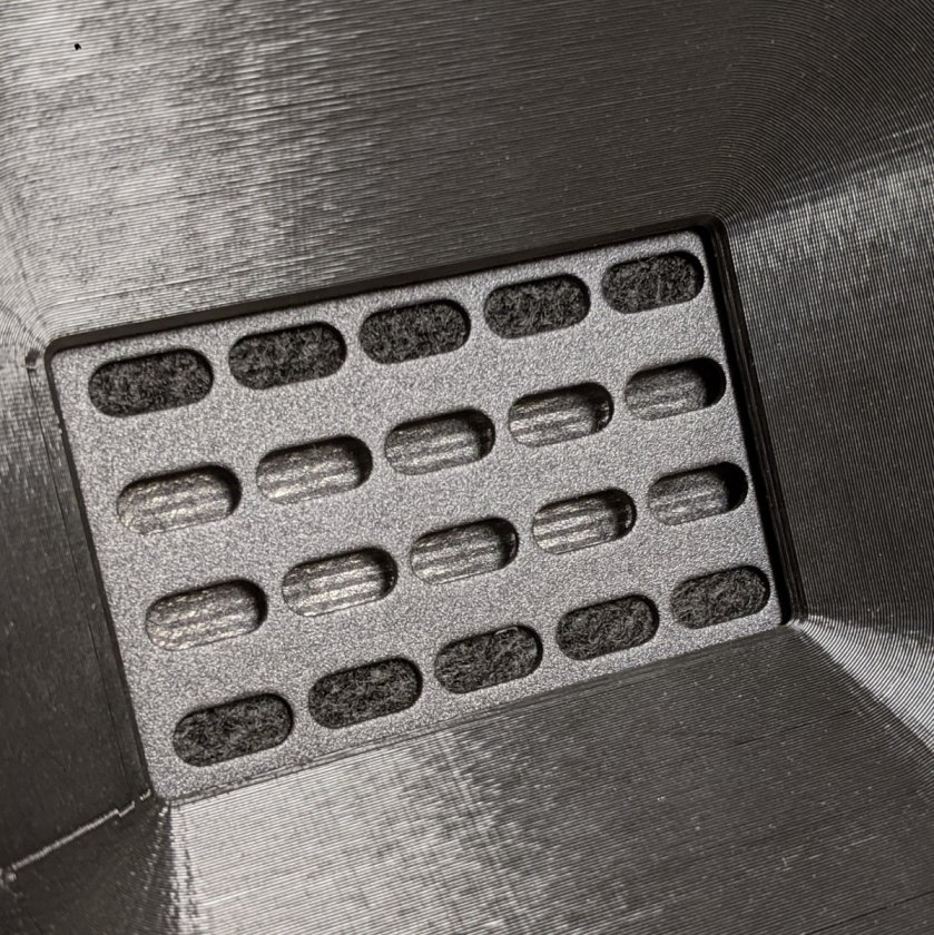

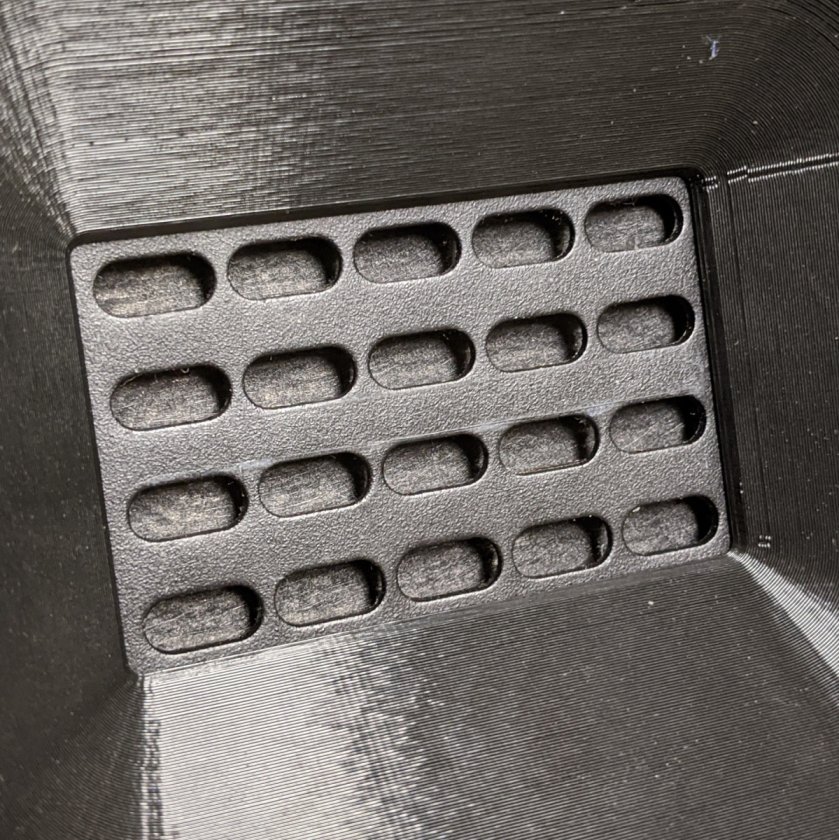

GRS3:
Neo3:

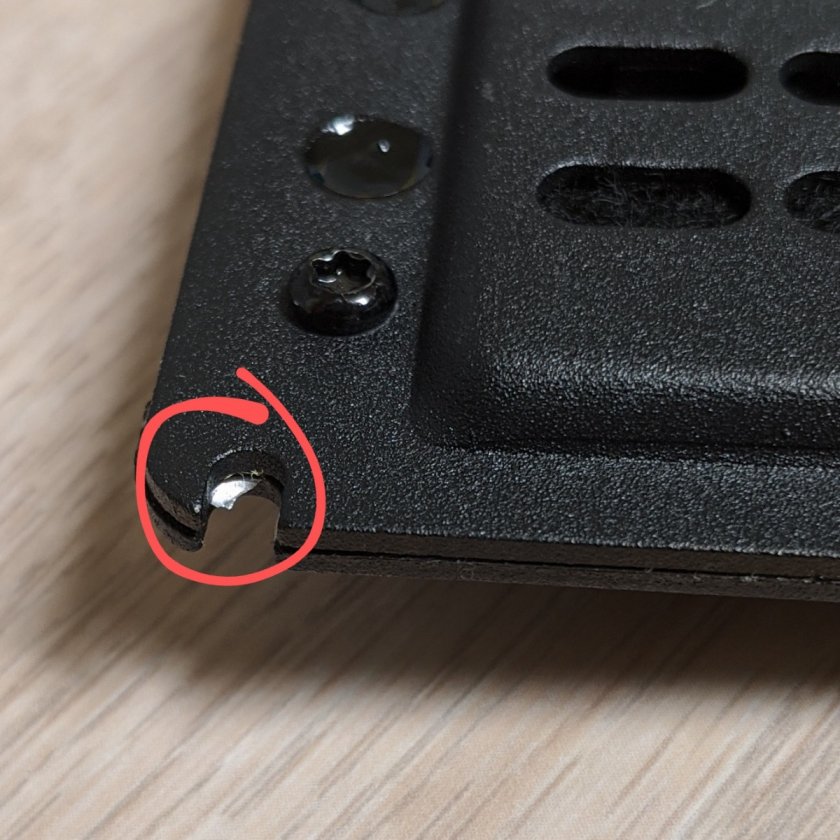

First QC issue I've noticed is that the diagram isnt cleanly attached to or hidden by the frame. There are also a few spots where it sticks out, namely around the terminals, and mounting holes but it's a fairly minor nit-pick.

Tho I'm still confused why the felt stuffing only exists on the back side and not the front on either 8" driver... (I checked and the Neo8 PDR has felt on both the front and back sides)

I'm not 100% sure, but it looks like a weird hybrid of the Neo8S & PDR models. Its has the full 30 drivers like the 8S, but has the felt strips stuffed in the outer row like the Neo8 PDR, tho only in the rear..
You could stuff some thick yarn in the outer, front rows & probably make for a better hybrid.

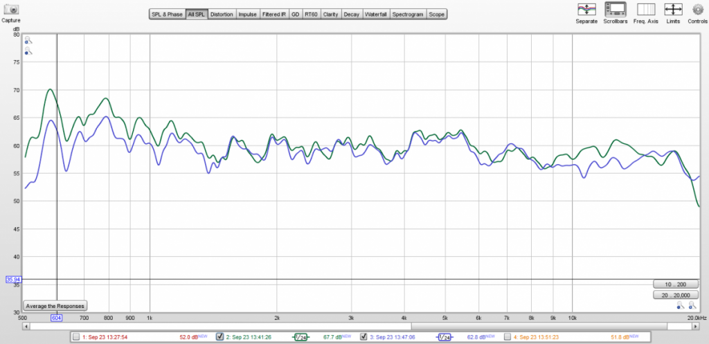

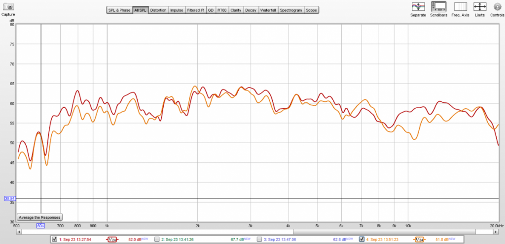

Okay! Testing done!
(Technically not done at 1W, but was done at 1M from baffle to mic)
I ran 4 sweeps in total: 2 as OB, 2 with the back cup mod.
Sweeps were done, on axis, 500-20,000 Hz using REW with 1/24 smoothing.

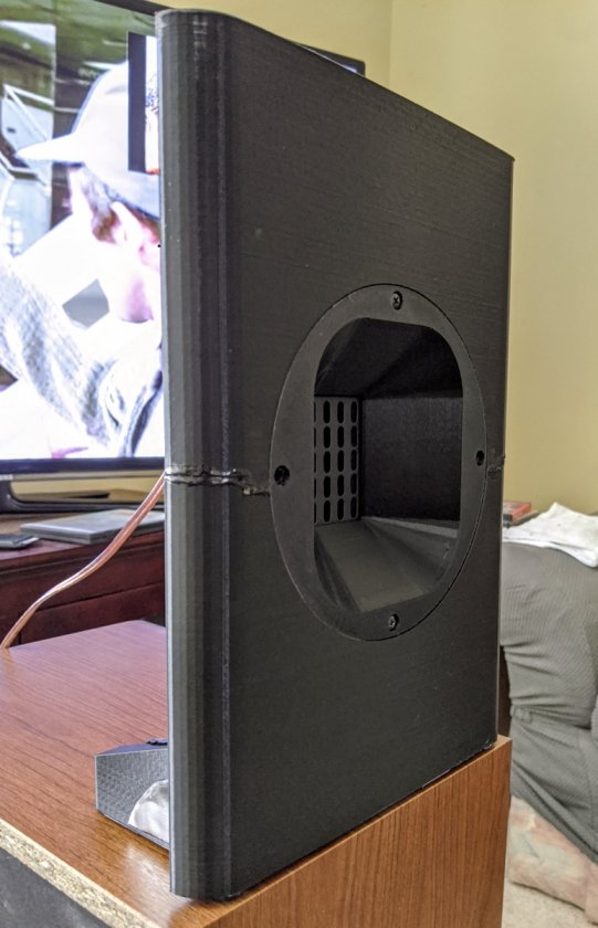

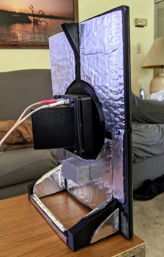

Here's the test baffle/waveguide, with a dynamat product on the back to reduce resonance of the plastic.
Deep cup results:
Red: Stock Neo3     Orange: GRS-3
OB results:
Green: Stock Neo3       Blue: GRS-3
I'm honestly impressed, they both measure well. And quiet consistently to one another, esp in their OB/dipole config!
Tho I would say that the Neo3 does fare better in the deep cup tests, but for OB the GRS-3 doesn't appear to be a bad option, and can easily get you down to 900HZ
In the sweep, there are other minor sweeps near the end, where I would say that the Neo3 does sound clearer imo, but the difference is pretty minor, and for the price is a pretty nice way to go.

How do the waterfall decays compare ?  Does the GRS have more ringing ?
