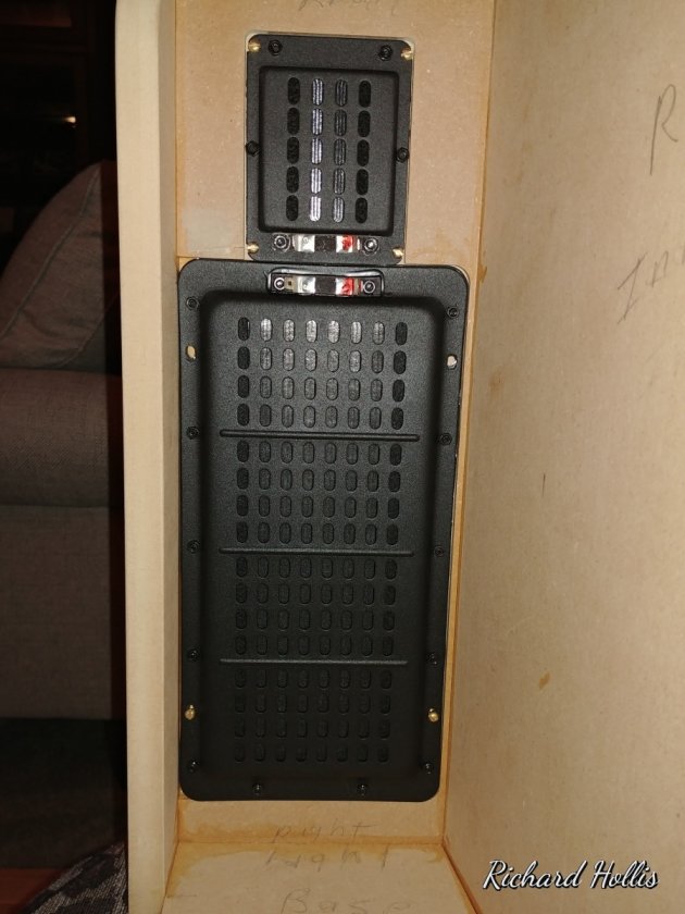

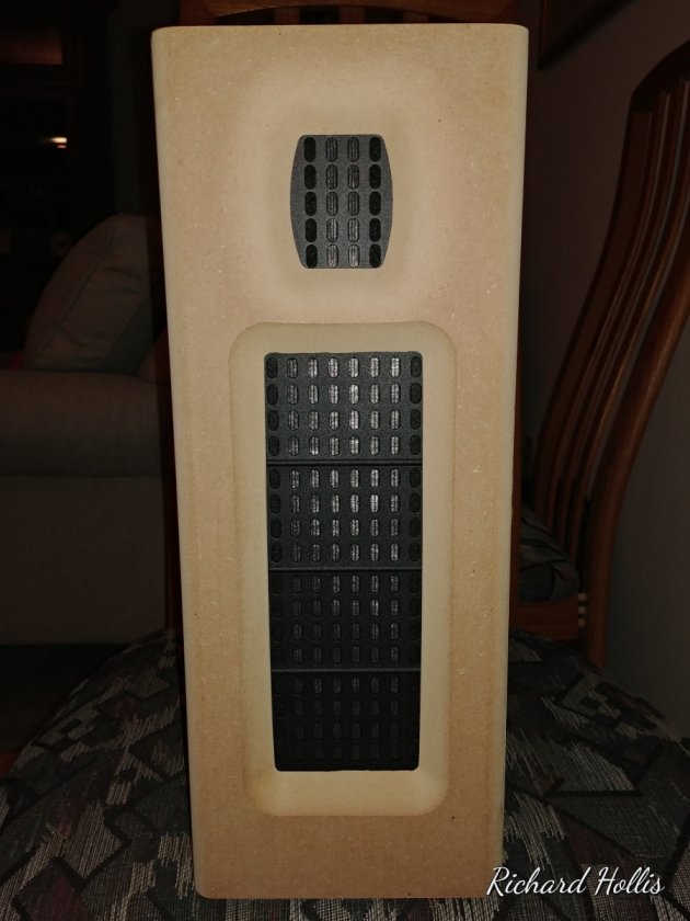

Here are the GRS-3" and GRS-10" planars mounted in Jay's open baffles for trials.  You can see the top two screws in the 10" planar are not installed as the mounting holes are in different places than the BG NEO10.  No big deal, just have to predrill new ones.  The gaskets can be used for either front of rear mounting which is nice.  The 10" one has extra precut holes for rear mounting.

They fit in the Super-Mini baffle quite nicely, even if two of the mounting holes are a little off. It's an easy fix at least!
Re: GRS-3 vs Neo 3
« Reply #43 on: 25 Sep 2020, 09:17 pm »
If you  guys are  frilling new holes inthe   recess for the GRS drivers,  use the existing holes as a depth gauge and mark your bit.... there is not a  ton of room there before you 'd pop through into the  waveguide onthe frontside.
If these prove to be worthwhile,   I can add the extra  2  scerew holes to future cuts of the  Super Mini,  Super 7, and Super  LS (Line Force) cabinets

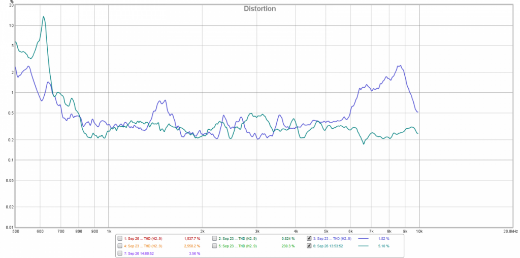

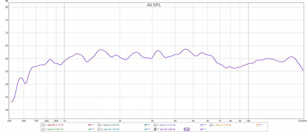

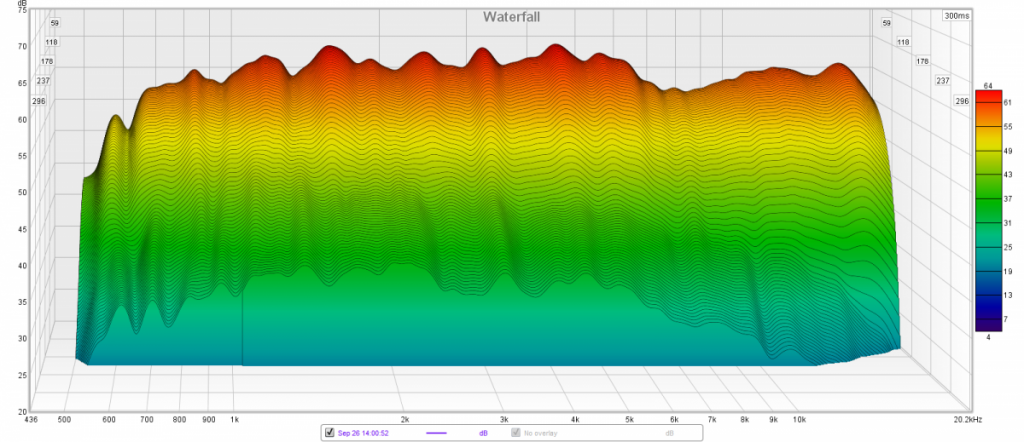

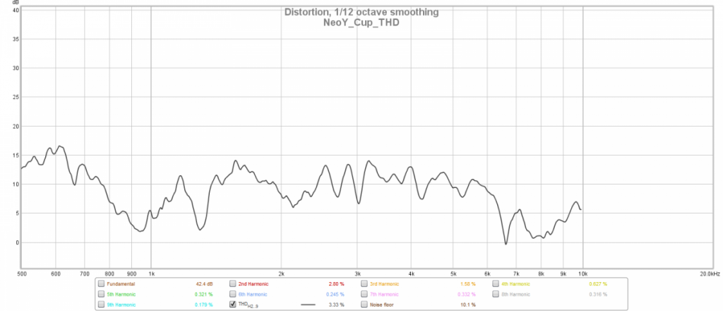

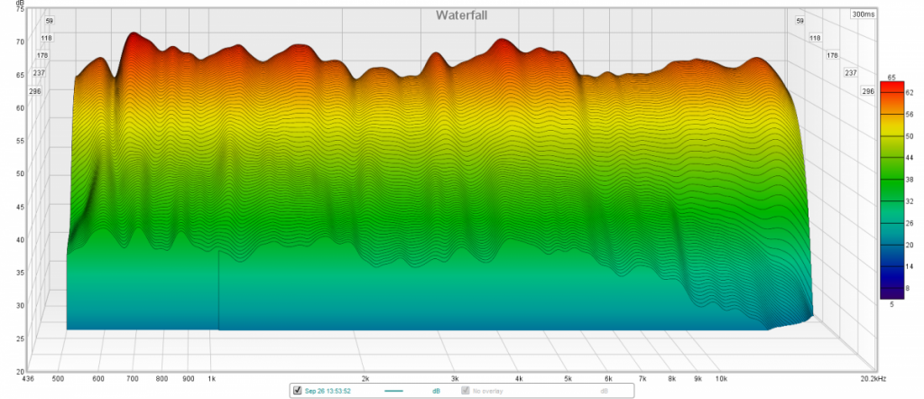

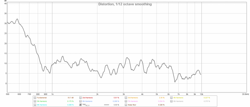

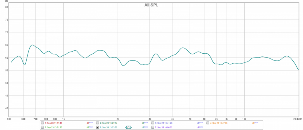

Okay, I installed Danny's yarn mod to my Neo3 and ran the tests again both in OB & Deep-Cup setups, using same test setup and positioning as last time. (Check the previous pages for GRS & stock Neo3 comparison)
Modded OB:
Modded Cup:
Modded OB:
Modded Cup:
Modded OB THD:
Modded Cup THD:
The yarn mod does a better job than I expected!

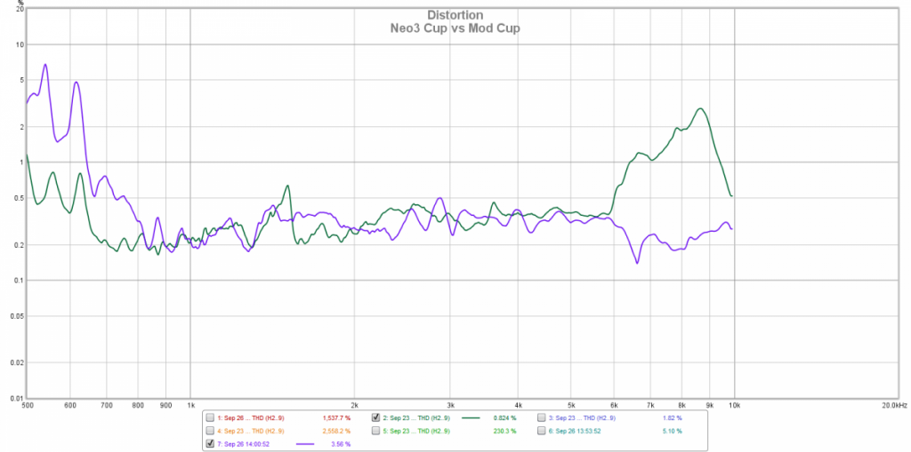

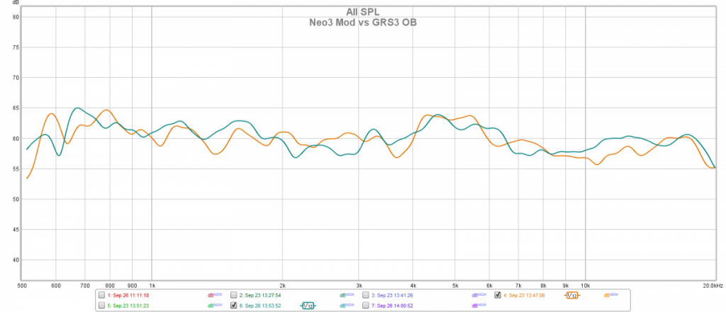

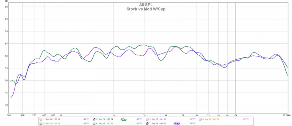

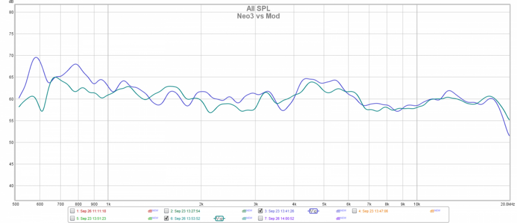

Here's a few comparison charts:
Blue: Stock Neo3 OB
Teal: Mod Neo3 OB
Green: Stock Neo3 +cup
Purple: Mod Neo3 + cup
Yellow: GRS3 OB
Teal: Neo3 Mod OB
OB THD:
Blue: Stock Neo3
Teal: Mod Neo3
Cup THD:
Green: Stock Neo3
Purple: Mod Neo3
emailtim
Re: GRS-3 vs Neo 3
« Reply #47 on: 27 Sep 2020, 10:16 pm »
The string mod appears to have knocked down the distortion peaks.
Will you be doing the same yarn mod test to the GRS NEO3 clone ?
TIA
Hobbsmeerkat
  • Posts: 2741
Re: GRS-3 vs Neo 3
« Reply #48 on: 27 Sep 2020, 11:04 pm »
TIA
No, cuz it already has thick felt strips where the yarn goes..
The GRS-3 is a PDR clone, while Danny's mod only works with standard BG & GR Neo3 models.
I imagine removing the felt would likely destroy the dampening layer in the process, making distortion much worse.
But it is interesting how the felt drops distortion on the high end, but spikes it below 800Hz. And while the cup mod does help reduce those distortion peaks, compared to OB, its also below the range where most Neo3s will be playing, so kind of inconsequential.

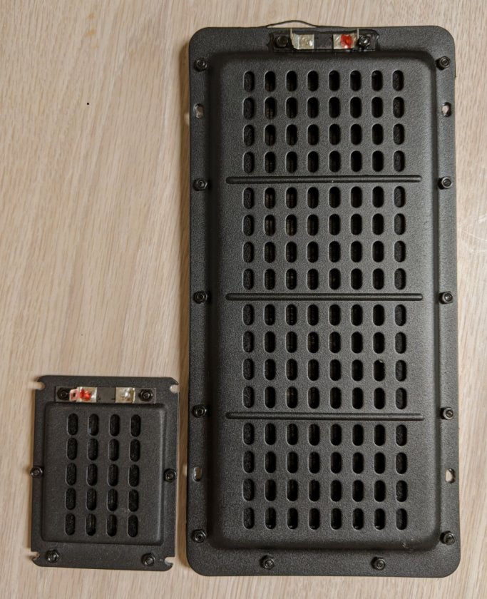

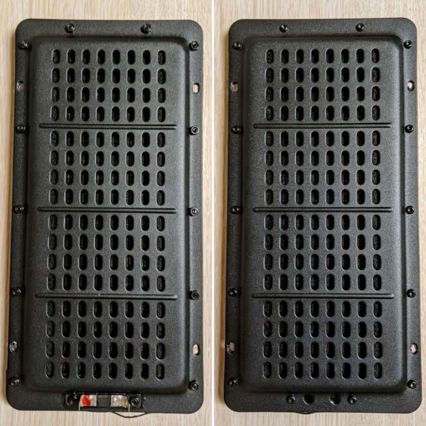

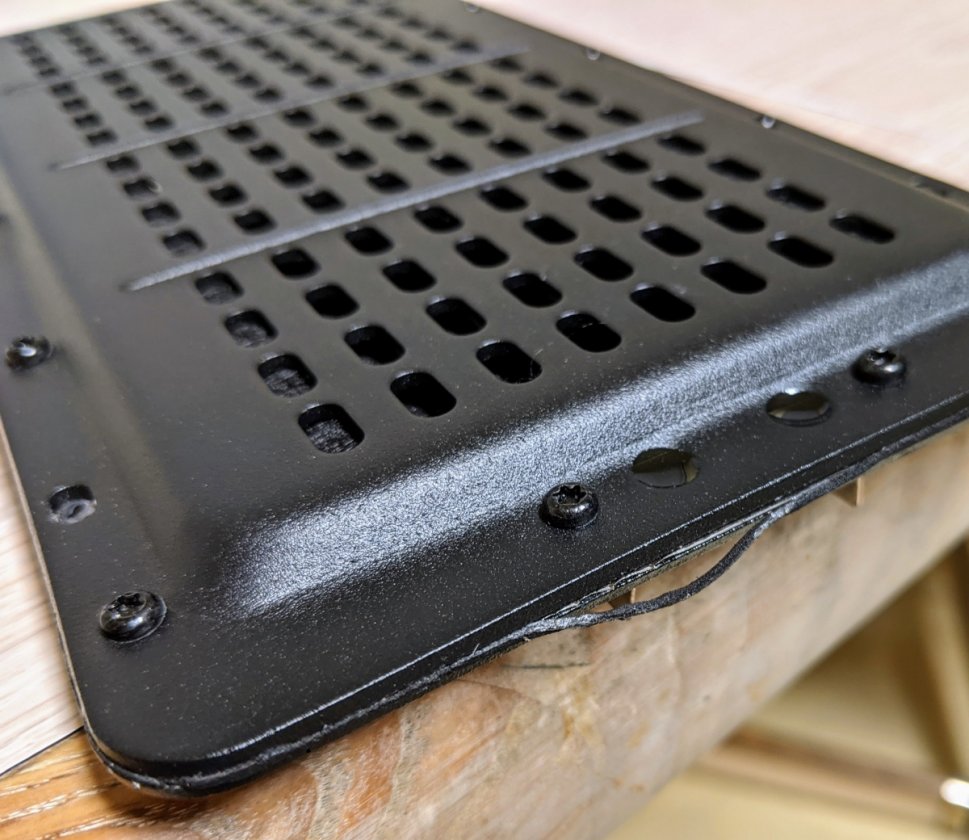

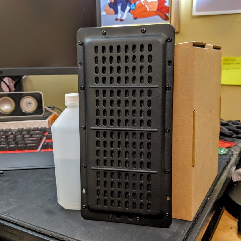

Got my GRS-10" driver!
I'm surprised how hefty this is, it's really solidly built.
I do want to say tho, that there is actually the full 56 magnets (28 per side) within the driver, not the 42 listed in the Parts Express page.
Heres some pics I took:
You can see in the 2nd pic that there's a strip of rubber that hanging off, and that seems to be their attempt at covering the edges of the diaphragm that came loose, but considering how well built this is, as a whole, the edges are a nitpick on both of these models.
I'm definitely interested in seeing how it measures tho, cuz thats where it matters, I do wish I had a Neo-10 for a proper side-by-side comparison, but I'm definitely interested in what Danny has in the works with his own model.

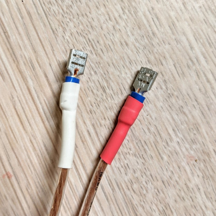

Just a word of caution for everyone testing these out.  DO NOT solder to the tabs.  It's very easy to overheat and damage the diaphragm.  Use crimp on terminals on the end of your wires.
Greg
Hobbsmeerkat
  • Posts: 2741
Re: GRS-3 vs Neo 3
« Reply #57 on: 30 Sep 2020, 02:22 am »
I'm using these for that reason, I do wish they were copper, but copper is also quite soft.
But for testing it makes the process a whole heck of a lot easier without the risk.
