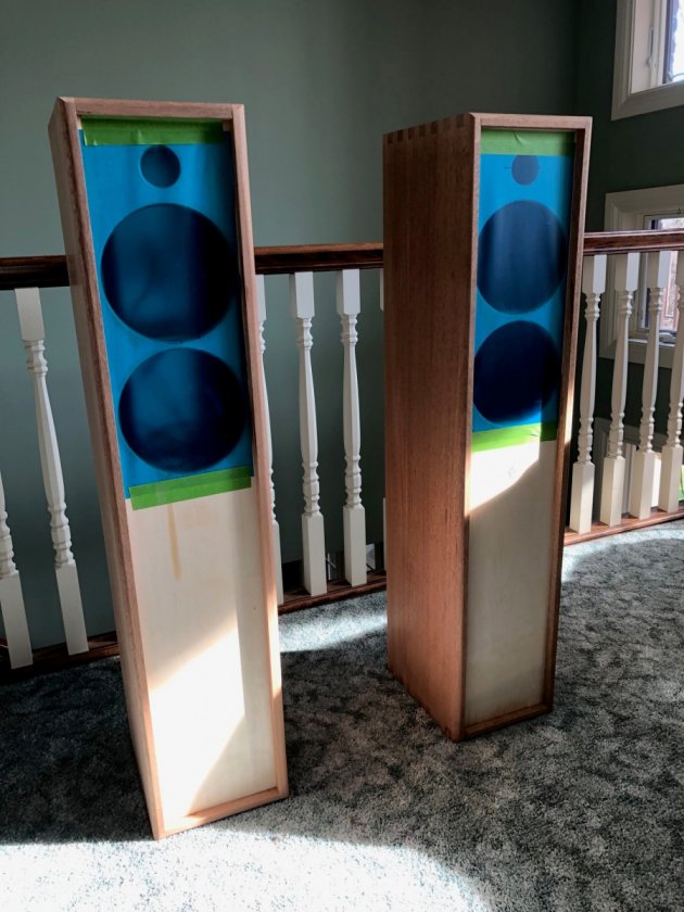

I need some solid ideas on how to keep sawdust from going inside of the cabinet while I am doing the finishing stage. It has no-rez now and it will be a supreme pain to allow sawdust to freely go inside of the cabinet. I don't even want to know what cleaning up that mess would be like.

1½" Masking tape in all the holes would be a start. A little tougher with the sub hole, but effective none the less. Maybe masking paper to build the gap. Try to build a border around the circle from the back side, then at the last bit close the hole with tape from the front side.

That seems doable. I don't know why I didn't think of this yet.
I used adhesive stencil film from Amazon. I'm sure that it was overkill, but I was going hardcore on every other aspect of my build, so I figured why not? I can't find the specific link for my purchase, but it came in a roll and I have enough for the next 347 pairs of speakers I build. I think that adhesive-backed shelf liners (like for kitchen cabinets) would work well, too.
