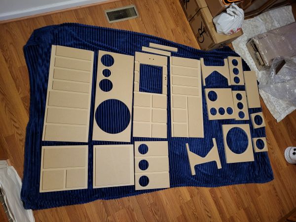

I received my Bully flatpack yesterday. Let the fun begin! Any ideas on order of assembly?

Looks like 18 parts per speaker with no instructions. What could go wrong?  lol

The cuts are very nice and clean. I think the next move I take will be to attempt to match the parts to the cabinet plans to understand how it goes together. Try out some dry fitting.

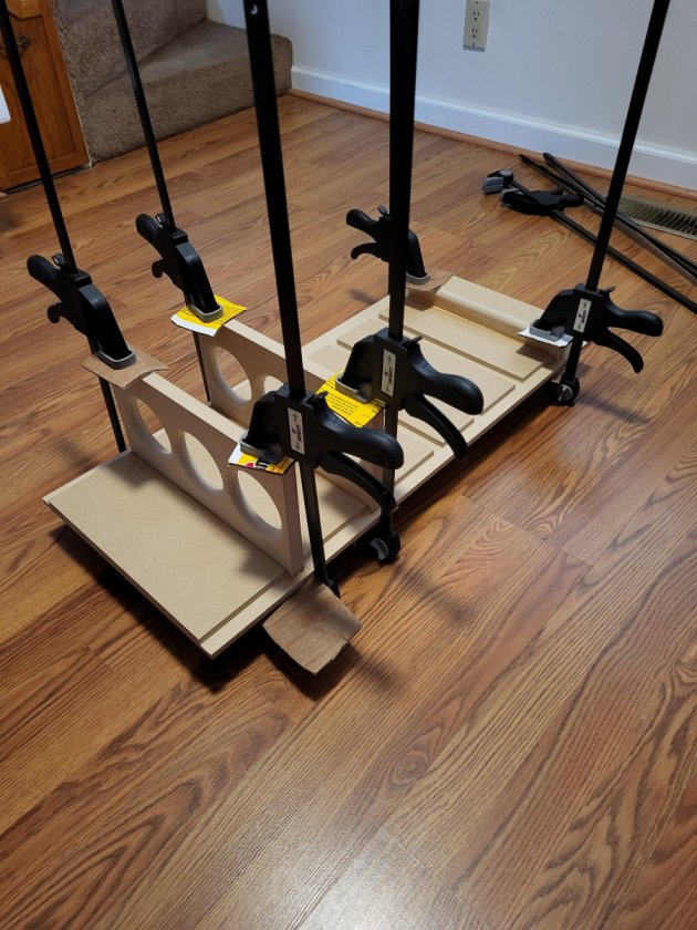

I'm guessing at some of this, but for sure dry assemble at least once and develop a game plan. People sometimes laugh at my clamp collection, but I can tell you there are times when I've used more than many think are necessary. Beg, borrow, steal what you need. Well, don't steal but you get the picture.
Use slow setting glue, I use Titebond Extend almost exclusively now. No downside that I've found.
There may be a way to do sub-assemblies but I am mostly not in that camp as it can produce surprising and unwanted mis-alignments. Perhaps some of the interior parts can use sides and backs as place holders while saving the glue up of those guide pieces till later.
For me, having a flat, hard and stable surface that's at a comfortable working height is crucial, meaning not the floor. But I'm old. Sawhorses and plywood will suffice, but those rickety fold up tables are almost more hassle than they're worth.
Have everything you need close at hand. You don't want to be searching in your garage or making trips to the store in the middle of a glue-up.
If you can't visualize the process start to finish, I would suggest you're not ready for glue-up. "Figuring it out when I get there" is folly, especially with so many pieces. There's enough to execute without throwing curve balls to yourself.

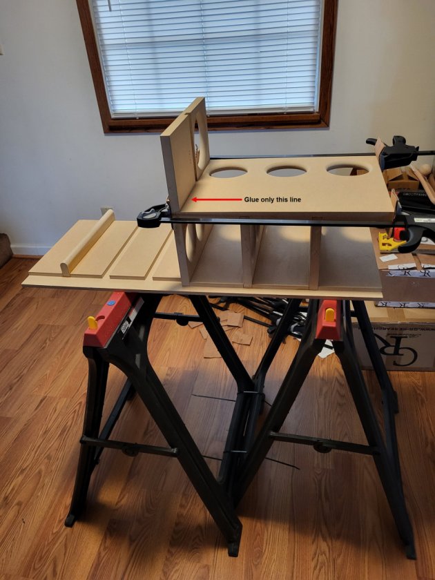

So, I did some very light sanding to level off the cuts. After that, I performed a dry fit of the right speaker (I'm working on only the right speaker). Part "H" is not installed to show the rest of the assembly.
robwm
  • Posts: 170
Re: The Bully Build Begins
« Reply #14 on: 10 Mar 2025, 03:25 pm »
As far as I can tell, the second baffle needs to be glued first. I don't see any way it could be done at a later stage.
« Last Edit: 10 Mar 2025, 07:19 pm by robwm »

Next step looks like the two parts "B" need to be glued to the right-side panel (as looking at the front of the speaker). It seems most logical to build most of this on the right-side panel. I glued one part "G" also.
« Last Edit: 10 Mar 2025, 07:18 pm by robwm »
robwm
  • Posts: 170
« Reply #16 on: 10 Mar 2025, 07:13 pm »
The next step looks like you should glue part D to part G. Use a dry assembly to hold it position while the glue cures.

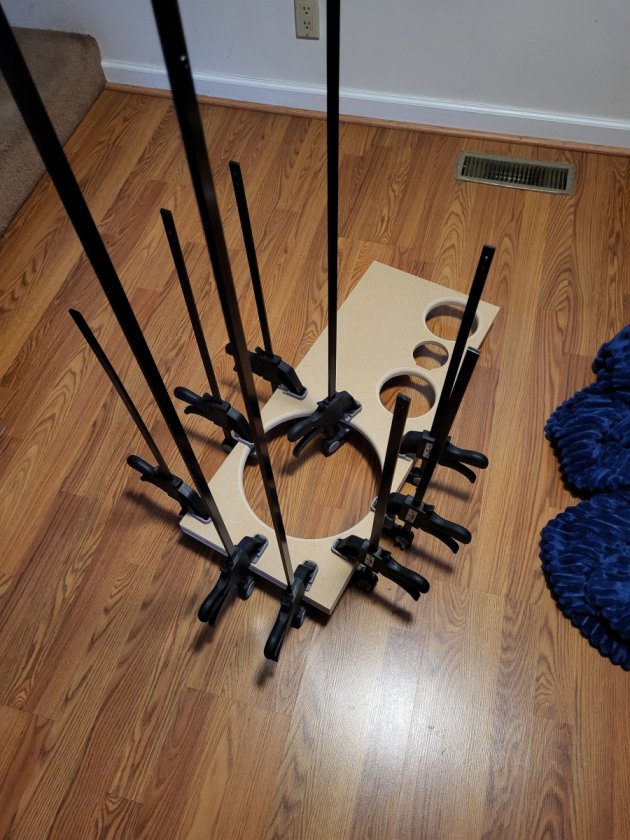

Rob, to make it a little less daunting, I think you could glue up the center assembly using sides and back as place holders. This would make final assembly somewhat easier.
FWIW, machine marks on panel edges shouldn't affect gluing but sanding them off probably won't have an effect either. If dados are snug, I often use a sanding block to ever-so-slightly bevel panel edges so that they kind of funnel into place. It won't affect assembly strength and also gives a little relief area for excess glue which decreases needed clamping force a bit.
Seems you've got a handle on it. Not rushing will reward you at some point, but then I plod through things so take that FWIW.

I'm just taking it slow as I have heard many people say in these forums. It might not be the best or efficient approach, but I feel like the stages I am using are safe, so I'll roll with it. Maybe I can speed things up on the left speaker after making it through one. No chance I can afford another kit if I mess this one up. I suppose I could use the drivers for fruit bowls?
My strategy is to essentially to avoid too many glue lines at once. Spend some time thinking through what might happen before even trying. Make sure all clamping is in one direction. I can't really do any overlapping of clamps with the type I am using.

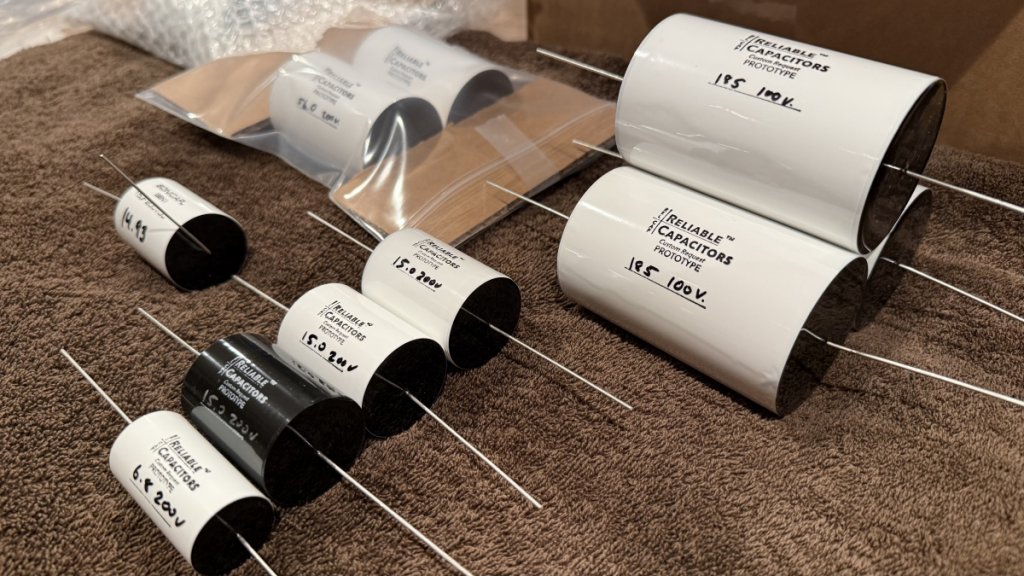

I have gotten the right speaker together except for the front and back. The left speaker will reach this stage by Sunday. I'm a bit behind on posting pictures so I'll be trying to get that caught up this weekend. I think from here I should start getting the insulation installed while access is very easy.
It is also time to start building the crossover. I was only provided one board for two crossovers, and it is way too small for the Bully crossover. I bought a 1/4" x 2ft x 4ft piece of MDF and I will cut custom pieces for the crossover. I plan to build it similarly to how Danny demonstrates in his videos.
I also bought a 3/4" x 2ft x 4ft MDF to mockup some pieces for router practice. I don't want my first router cut to be on the speaker cabinets.
