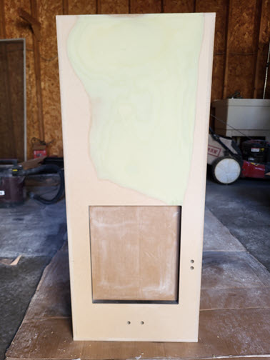

If this is conventional wood filler that air dries, it does almost none of the things listed, IMO. Stick with something that uses a catalyst. You could even start with body filler and then finish with glaze. That's kinda how it's done in the body shop world. I might also start with something like Kitty Hair (reinforced body filler), then finish with glaze.
If you take the high spots off, are you still beyond 2mm fill?

I haven't done any work so far. I need to build up 1/8" - 3/16" in places (maybe slightly thicker) to bring it back to 14". The glaze isn't meant for this type of buildup but that doesn't mean it won't work. I need to skim a surface that is 17.5" x 14".
I'm still trying to settle on the best approach to get this defect corrected. I did buy the glaze, but I might return it if there is a better method. The DAP product sounds promising, but I have no experience with it and reviews are not very helpful.
Are you suggesting using Bondo to build it up some and then finish with the glaze? Apparently, Bondo also has a wood filler.

Yeah the Glaze was meant to do in smaller coats but better finished edge to not leave a lip. Regular body filler will have more bulk to it and allow up to 1/4" coats, but can leave a little more mapping of the edge profile. Also the glazing putty is developed for the automotive market, but it absolutely works on wood as well. They just don't put it on their label as it wasnt their intended market. It is funny how many contractors use automilotive filler for their work. Nobody trusts the wood filler stuff as that can be cut with a butter knife  :duh:, but it is easy to sand. Lol.
My recommendation if you would rather a single application and sand than two thinner coats would be to return the Dolphin Glaze and grab some of their filler, specifically part#UP0660. This is the same resin, but a more standard Body Filler viscosity that will allow for that thicker build in one single coat. It's also one of the few nice fillers in a quart size. Either way works, just different tools for the same application.

I think building up to original height may be a lot of work for little return, but I'm not looking at it, so better you judge.  Averaging might be a better approach. I didn't look to see what Lloyd was recommending, but a long sanding block is going to be your friend. You could even make a crude one with a straight edged piece of 2x lumber and sandpaper roll designed for longboard.

Maybe all I should shoot for is to level it off which wouldn't take much work. Perhaps building it back up to original spec is not feasible and leads me down the road to more frustration. Building it back up will be a lot of work. Maybe too much work.
A long sanding block will fix the dip, you might have to make one if a manufactured block is to expensive. The block has be be dead flat and stiff. The longer the better, 24" or 32" would be nice.
Lots of options are available. And stay away from power tools in the future.
Using a soft pencil, draw "S" and squiggles all over the side you will sand. With pressure only on the ends sand off the pencil squiggles on the edges leaving the squiggles in the center. Alternately sand 90°, 180°, 45° going slow checking your work with a steel straight edge making sure the edges don't look like ocean waves turning one problem into two.

I'm going to try the DuraBlock AF4403. It's two inches wider than the surface I am working on. Unfortunately, I managed to make the edges wavy too so it's already a compound problem. If you look back in this thread, I posted measurements and a few pictures that help to show how it's wavy in a few spots. If I'm lucky, it will be close enough that you would have to lay a square on it to really notice.

This is as far as I am willing to go with a repair. The veneer will apply no problem now. From side to side, the surface is level. From top to bottom, the surface is curved inwards a little but nowhere near enough to cause problems with veneer.

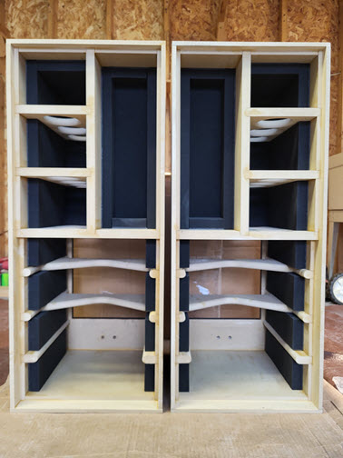

I finished installing the no-rez I had cut for the right speaker. I need to cut four more small pieces to finish that speaker. I'll post a picture after I finish installing the no-rez in the right speaker. I'd like to know if I did it properly.
I need to cut a lot of no-rez for the left speaker. It turns out that three sheets of no-rez covers only one Bully speaker. I ended up buying six sheets to cover everything that makes sense. Outer walls only.

This weekend, I was able to get the back panel on the left speaker. In this attempt, I was very meticulous about dry fitting the back panel. I spent a serious amount of time making sure I had a really good fit that could be taken apart without any trouble. It was still a very tight fit, but there were no issues taking it apart.
It took some minor hand sanding to bring the panel to the point I could install and remove it without fear of damage or getting it stuck. Once I reached that point, I installed the no-rez that will become inaccessible once the panel is installed and attempted a dry fit once more. I'm so glad that I did.
I ended up reproducing the exact issue as the other cabinet (without glue this time). The back panel was sticking up about 3/16" just like the other speaker. It turns out that I was using too much precision in my no-rez cuts which allowed it to interfere with the "outside walls" seating properly. I took the dry fit apart and pulled the no-rez off to reposition it (not an easy thing to do). After adjusting the no-rez positioning, it went together as expected, nice and flush.
I did have a minor panic though. After the last dry fit showed that it will seat properly, I added the glue and seated the panel. I noticed it was sticking up in places, but I was at the point of no return now. I kept adding all my clamps (14) and then I noticed the panel was seated flush as it did in the dry fit phase. Apparently, the uncompressed glue joints made it appear as though it would not seat all the way. Clamping fully seated it everywhere around the edges.
To summarize - I was able to install the back on the left speaker, and it mounted very close to flush. I will take almost no sanding to prep the surface for finishing.
Lesson learned - Skipping the dry fit phase at any stage has the potential to completely ruin your project. I learned that dry fitting is so crucial that you could prevent mistakes that should never happen. Please do not skip the time it takes to get a very successful dry fit. I rushed the right speaker by not dry fitting and paid the price of doing so both in money, labor, and personal disappointment.
Tonight, I will install the no-rez in the left speaker and post pictures of my current stage.

I have the no-rez installed at this time. I'm not sure if I need any where the input tube connectors are located.
NIGHTFALL1970
Re: The Bully Build Begins
« Reply #99 on: 29 Apr 2025, 03:25 pm »
There isn’t any there on mine.
