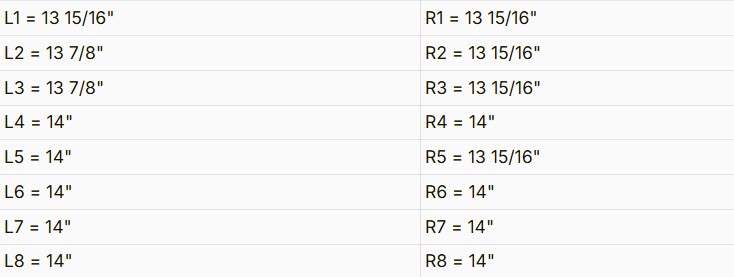

I took some measurements to see how it looks from top to bottom. You can see the edges are a bit wavy.
The original dimensions are 14" w x 14" deep x 33.5" tall.
I measured the depth on the left and right panels in 8 places that are roughly equidistant from top to bottom.
L1/R1 = top edge
L8/R8 = bottom edge
L/R = left/right

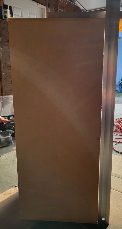

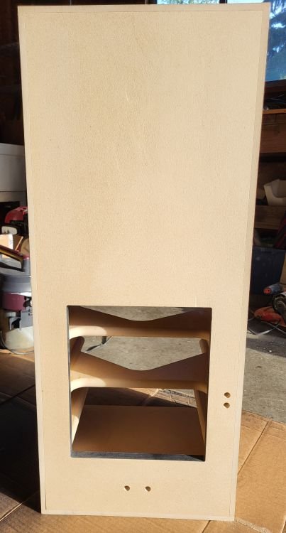

Back panel - above the cutout is where I sanded it too much. I sanded below the cutout too but not nearly as much. I realized what I was doing above so I used it sparingly below the cutout.

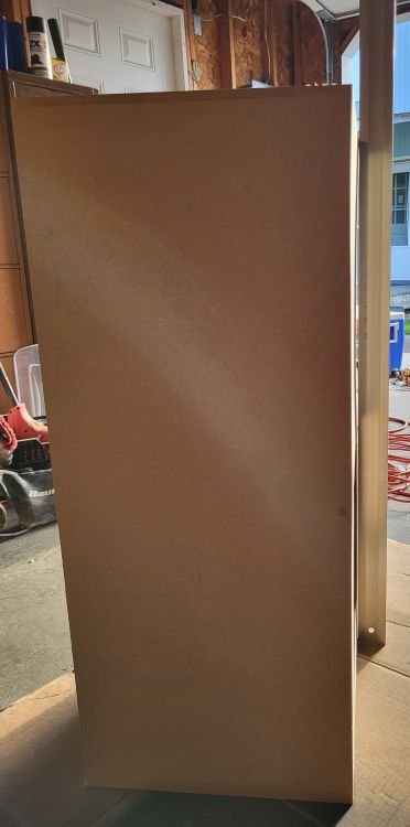

Sight line looking at the left edge. You can see light between the straight edge and the cabinet.
Sight line looking at the right edge. You can see light between the straight edge and the cabinet once again.

I bought some U-Pol Dolphin Glaze and a Durablock AF4403 as suggested. It might not be realistic to bring this back to square, but I could level it better than it is at the very least.
