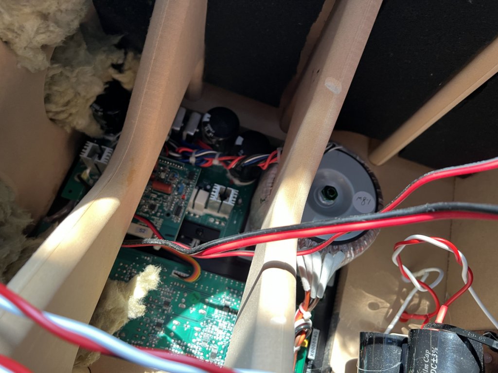

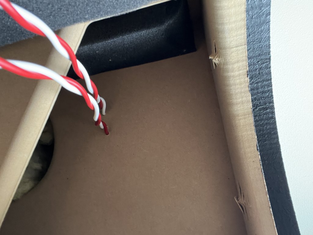

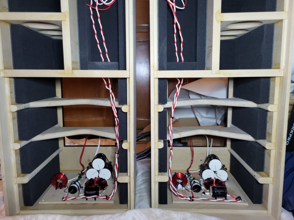

Does anyone have pictures of how the crossover, subwoofer, amplifier and jumper wires are installed?

Here are some. I hope they help.
The bottom two pictures rotated sideways. You can see where the wires for the jumpers go.

NIGHTFALL1970
Re: The Bully Build Begins
« Reply #105 on: 5 May 2025, 08:49 pm »
Looking up. Wires that go up to the drivers.
robwm
  • Posts: 117
« Reply #106 on: 5 May 2025, 08:49 pm »
Thank you for the pictures!  :)
If I understood better how to build the crossovers when I was doing it, I would have built them in a way where the tweeter and woofer wiring is right under the MTM box. In the layout I used, I'm really concerned the wiring is not long enough to accommodate cable management. Rewiring these would be a real nightmare at this point. Those crossover boards are there to stay.

Back view where you can see subwoofer amp.

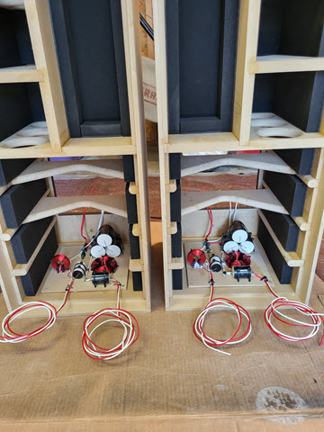

robwm
  • Posts: 117
« Reply #109 on: 9 May 2025, 02:44 pm »
I twisted and routed the wires. They seem like they will be long enough to reach the drivers, and the wire is firmly in place using hot glue at the mid-point. I can't imagine it coming loose or vibrating. Next up will be polyfil in the upper chambers.

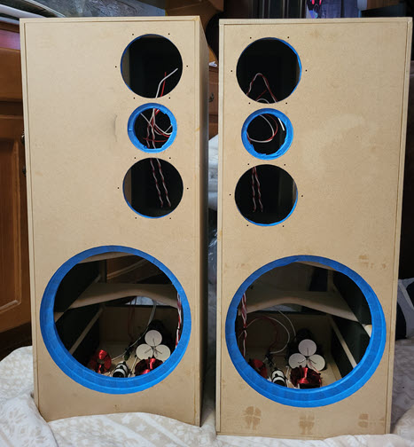

« Reply #112 on: 12 May 2025, 02:16 pm »
I was able to install the polyfil and get the front baffles glued on for both speakers this weekend. I also cut up the veneer. I noticed that the veneer was cracking, and you could see the paper backing through it. After cutting up everything, the cracking was only occurring in that one spot and ended up being scrap. Whew!
I will be able to remove the clamps after lunch today and then I can post more pictures.
I need some solid ideas on how to keep sawdust from going inside of the cabinet while I am doing the finishing stage. It has no-rez now and it will be a supreme pain to allow sawdust to freely go inside of the cabinet. I don't even want to know what cleaning up that mess would be like.

nlitworld
  • Posts: 2462
« Reply #113 on: 12 May 2025, 05:40 pm »
1½" Masking tape in all the holes would be a start. A little tougher with the sub hole, but effective none the less. Maybe masking paper to build the gap. Try to build a border around the circle from the back side, then at the last bit close the hole with tape from the front side.
robwm
  • Posts: 117
« Reply #114 on: 12 May 2025, 05:49 pm »
That seems doable. I don't know why I didn't think of this yet.

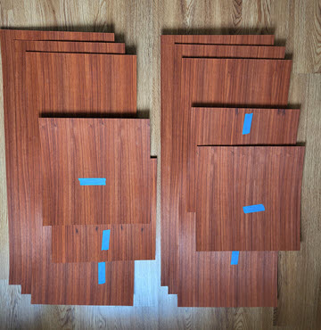

« Reply #117 on: 13 May 2025, 04:44 pm »
Veneer is cut and ready for use.

« Reply #118 on: 14 May 2025, 11:59 am »
That veneer looks very nice !
