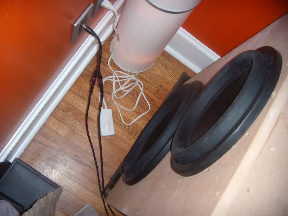

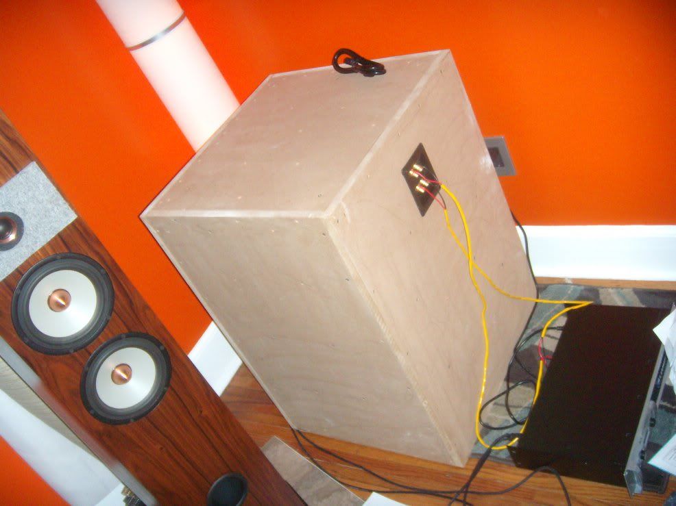

When Brian announced he was using the new TC Sound woofers - my interest was a little more than peaked.
Unfortunately I just cant afford to buy one from a manufacture.
I am however handy with power tools and wood so I figured I would give it a shot myself.
I owned a Larger and took all the dimensions of it.
This is not done yet - I am going to do one more layer of plywood and a layer of solid wood and the drivers will be flushed.
I wanted to hear/feel the results before I invested in the plywood and solid wood...
So far the difference is night and day - we measured solid in room down to 15hz with the sub hardly breaking a sweat. Utilized a Crown XLS2500 (800 per woofer) and the amp was clipping while the amp laughed.
The final design will have an aluminum plate with insulated binding post and dual XLS1500 amps bridged (1555 watts at 4 ohms) driving it.
Tonight was impressive and my house needs to be reinforced...

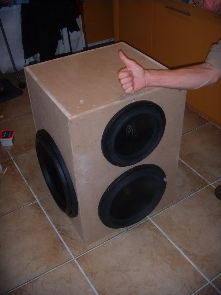

This is using the 15" TC, 12" TC, and 18" TC Sound Passive

I cant wait till it is finished - we are guessing it is going to weight around 350 pounds, give or take...
The base will be 6" thick with the enclosure wall and base combined - so it shouldnt go anywhere and I have 8 thick rubber feet to bolt to it...
Will be exciting!

Hello Vr3,
Great looking project. The 18" must have been a very tight fit. How & at what freq are you crossing this monster into your system? It would be great if you could post your measurements for the box!

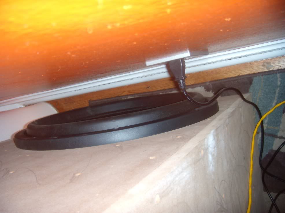

Here's my DIY TC Sounds 15" sub -- the woofer is downward firing. The pic shows the front firing passive radiator. The plate amp is the Parts Express thousand watter. Note the massive power cord. :o The woofer is tucked directly behind the seating position.
