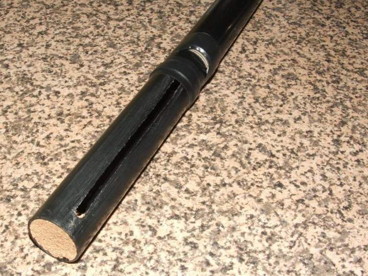

The wand is a simple piece of plastic tube, actually part of an old snorkel I had kicking around in the garage.
The vacuum slot is about 1/8” wide and the whole lot just plugs straight into a vacuum cleaner hose.
When vacuuming the wand is hand held with the end resting on the plastic disc which holds it approx 2mm above the vinyl surface. It is butted up against the jam jar lid to maintain constant position while the table is rotated.
To hold the wand parallel to the table I initially used a plastic pad (as seen in the pics) and held it down against the outer edge of the table. Unfortunately the vacuum was so powerful that it sucked the record up to the wand.
I overcame this by adding a taped PVC strip that runs against the upper, outer  edge of the lead in, holding the vinyl down. There is no contact between the vinyl and the wand other than at that point.
I probably need to think about this a bit more, but currently it seems to work.

As expected there's been a few mods to the kit already, the main one being that the vacuum wand is now mounted on a dedicated stand that I just slide in to place when drying. Much quicker and safer to deploy.
I've also needed to add some extra support towards the rim of the vinyl to reduce deflection during cleaning.
Holding the record rim off the platform eliminates any cleaning fluid migrating to the leading edge of the other side of the album.

The narrow slot plugged into the latest model Dyson appears to be delivering the goods so far.
When I fire up the vacuum the liquid is rapidly pulled in from about 3/4" either side of the wand. After a couple of relatively quick spins everything certainly appears to be totally dry. Will continue to bear this op in mind though for a potential little down stream trial.

I have been cleaning some hundred records by now and yes, maybe steam is something wort trying. The really important thing by record cleaning is to get everything out of the groves, how it looks on the visible surface is not the issue.  8)I think you have to get really close tho the groves in order to get a good result and using velvet lips is one way to go and your vacuum mashine don´t have to be very strong to accomplish this as you will reduce the airflow to near zero. The velvet will help in picking up some fluid and I use to dry it before the last two rounds.
Just some thougts about the drying part. And Dave, I still like trying your steaming method  :thumb:
Martin
Thanks for your comments Martin,
The thing I personally don't like about the velvet lips is the fact that they are in contact with the vinyl.
They tend to remain damp during the vac process and can leave a small amount residue on the surface of the record when removed. I wanted to see if I could apply a method that avoided any direct contact with the playing surface.
So far I'm pretty happy that the three applications of steam and the level of vacuum I'm applying is getting the crud out of the grooves.
Cheers
