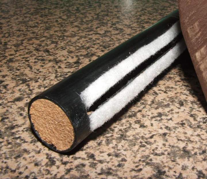

I spent a bit of time last night cleaning a few records with the addition of some velvet lips on the vacuum wand.
I used some adhesive backed soft velvet, typical of what you can get at an arts 'n' crafts store.
As the end of the wand sits on the label guard, all of the suction was applied directly to the record surface.
The result - Boy does that suck the grooves  :o
I had to back off the suction at the vacuum pipe due to the level of hold.
Even after opening up the bypass port a little, the disc was virtually bone dry after one quick rotation.  :)
The end result in terms of vinyl cleanliness appears to be pretty similar though.
I tried a couple of discs that I'd cleaned previously that had some stubborn pops and they remained.
What was interesting was that the velvet actually remained very dry. I believe the vacuum is actually drawing air through the material and keeping it dry.
Certainly I saw no witness marks at all when removing the wand from the vac'd disc.
Not sure if I'll leave the velvet on long term, it is a little quicker but I still like the idea of not having anything in contact with the playing surface while vacuuming.
We shall see.

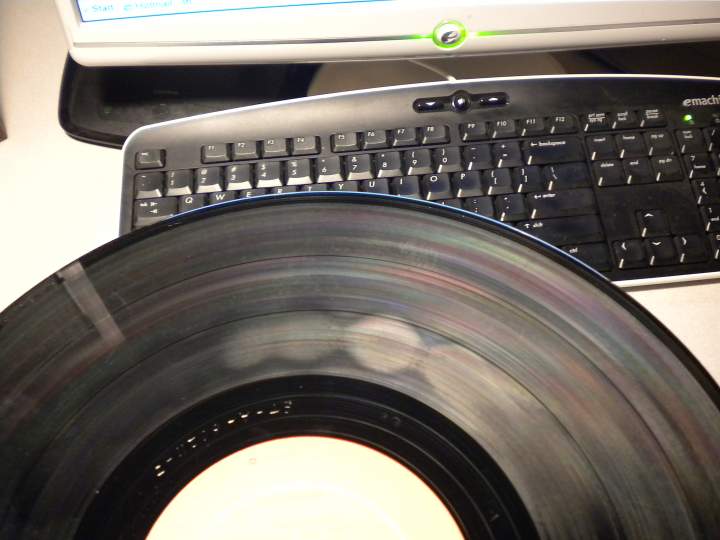

Here's what can happen if you leave the steam to long in a particular area of the LP.
The LP no longer plays right............Bill  (trial and error mostly error  :lol:)
DaveyW
Re: Basic DIY Steam & Vac Record Cleaning Approach
« Reply #28 on: 15 Mar 2011, 08:20 pm »
Oh Dear!
The round witness marks seem to indicate spot application as opposed to a continuous spinning of the disc during steaming.
Can you confirm the process you used.
One other thing, my steamer spits out boiling hot condensed water on first application. I purge that into a jug and let the steam come through before applying to the vinyl.
Your pics look like there could have been big drops of boiling water at play there.
Did you apply inside to out? This could be the cause?
Sorry to hear you've had this problem - A lesson for all of us Steamers
Dave
« Last Edit: 15 Mar 2011, 09:38 pm by DaveyW »

Oh Dear!
Your pics look like there could have been big drops of boiling water (No) at play there.
Dave
The circles are becaused I stopped & started spinnig I wanted to try it. Clearly it was a mistake
The LP was a nothing LP................Bill

One process update - I ended up removing the velvet lips.
I found that if I was cleaning records that had a large amount of surface dust (generally discs bought from vendors that have been sitting unplayed for many years) then this level of dirt could be retained within the fibres and take a couple of purging cycles to clean out.
I could have delivered a pre-cleaning hand wash, but it all adds unnecessary time.
So I'm back to hovering the vacuum nozzle just above the vinyl with absolutely nothing in contact with the playing surface.
The extra advantage here is that I don't need to swap wands whether cleaning or rinsing.
All in I’m now happy to leave this very simple & cost effective method as is – No more tinkering just Steaming and Playing  8)
