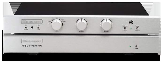

James what is the DB level if installed below BP26 . Example like the picture
Thank you
Robert
James Tanner
  • Posts: 21005
  • The Demo is Everything!
    • http://www.bryston.com
Re: BP26/MPS2
« Reply #9 on: 11 Dec 2010, 01:02 pm »
Hi Robert,
I can not remember specifically so I will have to ask engineering.  I just remember them telling me there was a slight advantage if the power supply was on top vs on the bottom.  The noise floors are very low anyway and I doubt whether any of this would be audible.
james

« Reply #11 on: 11 Dec 2010, 02:48 pm »
Hi Sasha,
They tell me the influence of the very large power supply in the MPS-2 seems to radiate the magnetic field upwards through the top at greater intensity than downward.  I assume some of it has to do with the materials used in the chassis and the magetic field and positioning of the transformer in the MPS-2.
james

Hi Sasha,
james
Translation: the bottom plate is thicker than the top plate.
