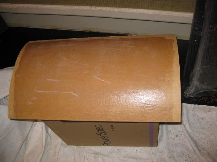

The front baffles were not rounded over so I bought a $25 Habor Freight router to finish them off.  This was a good use of Habor Freight!  I like the little router.
The cabs are coming together.
I can't wait to get on to veneering!

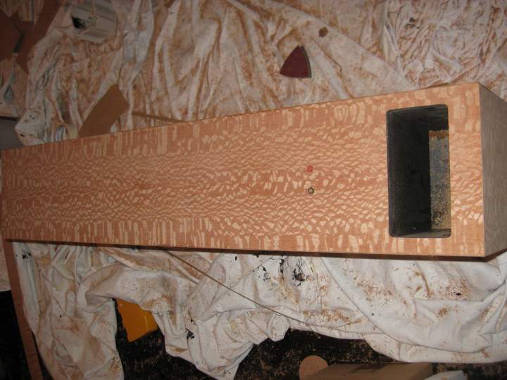

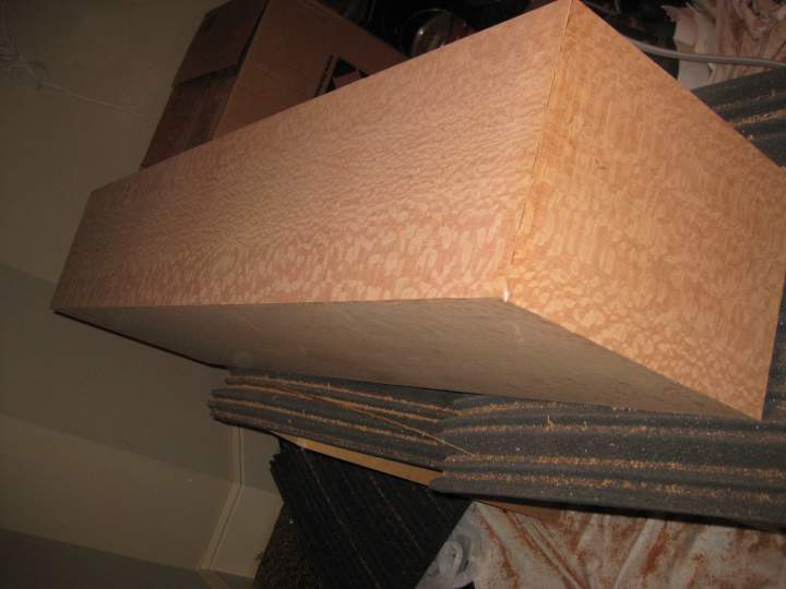

Ok things are getting excited!
Holly batman you don't realize how much veneer you've bought until you lay it out
This is the front of the towers.  Should be pretty cool in that the grain tapers to the top just a bit.
This will be the sides.  I struggled if I should have a stripe or just use the figured portion.  I ended with the stripe because it is just so cool looking.  Hopefully it is a good move.
I can't find heatlock local anywhere.  I'm thinking of doing the hot iron method with Titebond Cold Press for Veneer which is available.  However, I don't want to mess up.  I'm also trying to get them ready for Xmas... Dang procrastination!
More to come,
Robert

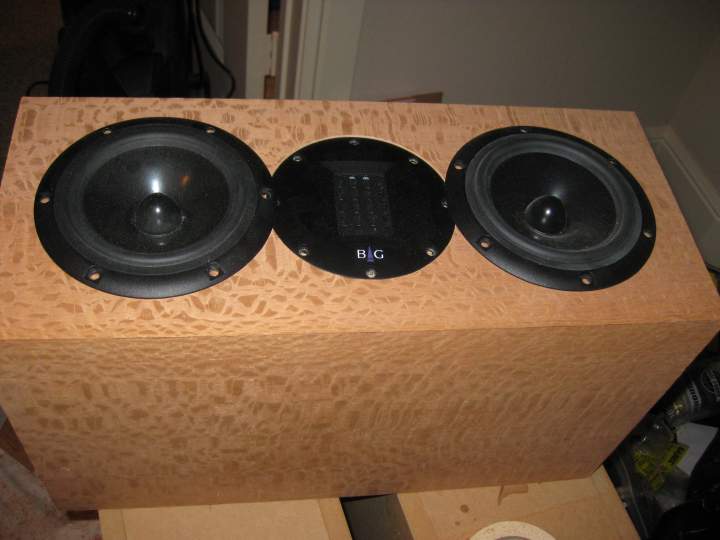

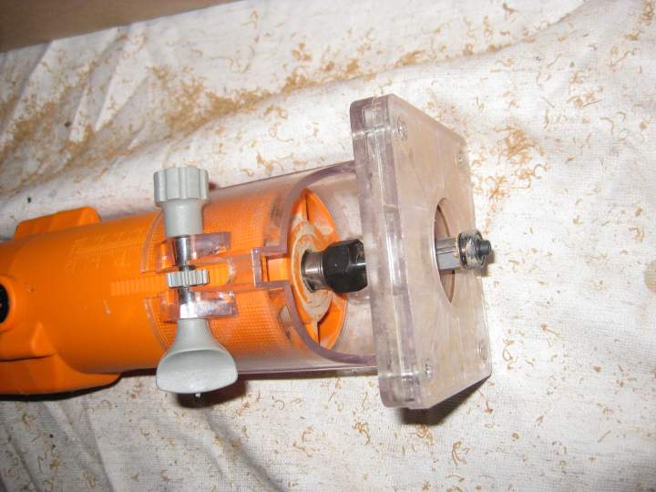

More progress...
I got the veneer cut for all the speaker sides.  This tool was very helpfull as the venner is tough stuff with the paper backing.  I honestly can't imagine this project without this thing.  However, I don't know if it will make it to project two as it is kinda sputtering.
The Three Amigos before clothing.  I actually made all the cuts in one night.  :green:
I went to Ikea this afternoon and got this little table to use as a front rack.  Looks nice with the floor color.
I think I have enough veneer left for that servo sub someday!  I also ordered the cloth to cover the boxes and the accoustic transparent screen.  I decided to wait for the Heat Lock to finish the glue job.  Should have planned a little better.  No sleep is getting old.
Robert

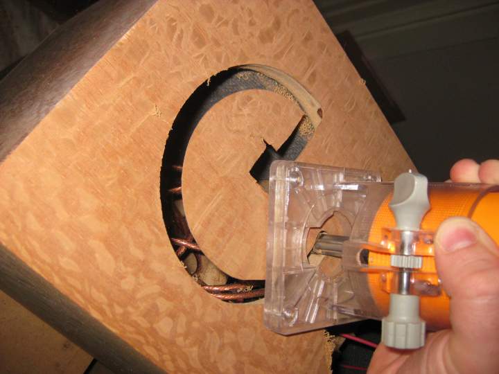

Ok you can see this starting to come together.  Got the center veneered in one night  :green:

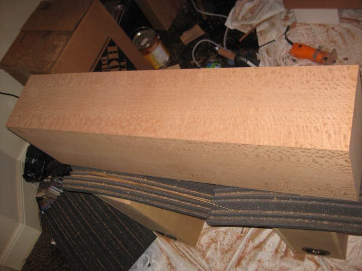

Thanks for the kind words so far.  For a total noob, I'm feeling pretty good so far... :icon_surprised:

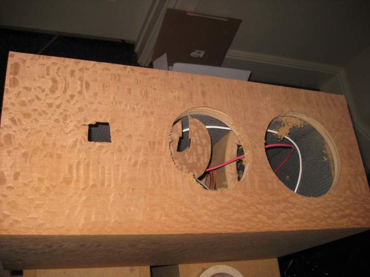

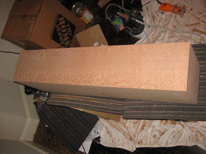

Here are some more pictures of the work from the last 3 days.  Cabinets are completely covered in veneer and all the holes are cut.  Now I will install my rear two speakers and then start cleaning my room of dust.  Then I'm on to finishing the speakers!!!
Robert

did you install the electra tube connectors after you veneered or before?
« Last Edit: 30 Dec 2010, 10:00 pm by aharami »
HT cOz
Re: A Neo Home Theater Build
« Reply #19 on: 30 Dec 2010, 08:54 pm »
I installed the plugs before the veneer. That was a.bit of a catch 22 because if you wait how do you get to the wires and if you don't wait the how do you put the veneer over then and avoid stuff like glue.
I positioned the veneer where I wanted it and then pressed hard enough to leave marks in the paper. Next I drilled holes. Certainly not perfect but I'm not sure how I could have done better.
