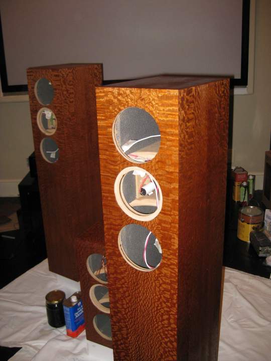

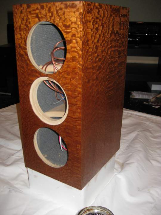

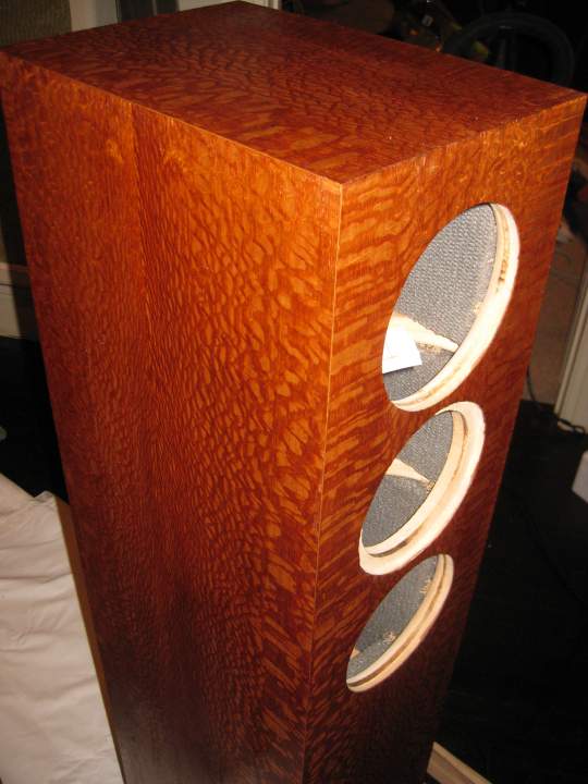

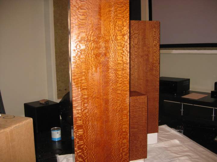

Big progress is being made and I'm feeling better about my 2 week deadline for the project and entire room.  Here are some more pics for you guys. Today I lightly sanded with 320 grit, dyed them very lightly, sanded with 0000 steel wool, and applied the first coat of Waterlox.

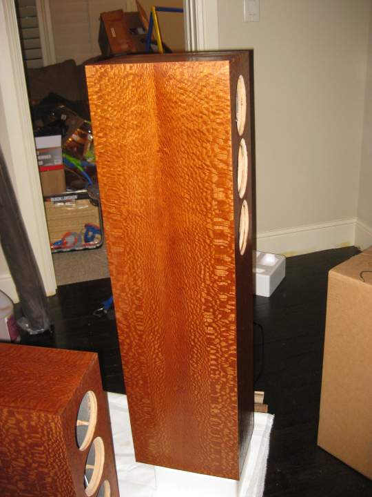

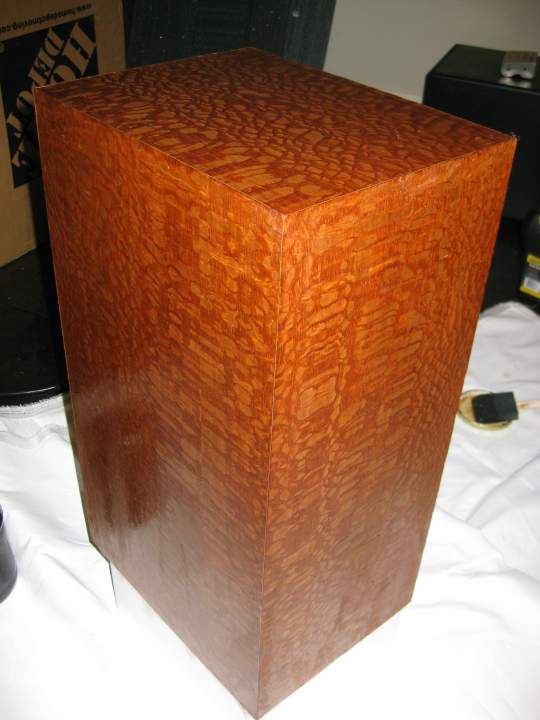

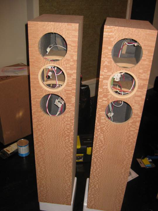

So the deadline for having my room presentable is this Friday, per the boss.  Well I'm getting pretty close to having it atleast look like a media room.  I have five coats of Waterlox on the speakers and will wait until next week (it needs to harden) to do some sanding and start the final coats. The sound boxes are covered.  I only have to hang some brown velvet drapes to cover the front corner bass traps.  Here are some pics of the progress.
The Waterlox is awesome so easy to use.  I have some nibs that fine rubbing pads will take care of.  Honestly they look really good until you are a foot away and you feel a non-perfectly smooth serface.

Robert, your build is realy coming together quite nicley. If you dont mind me asking why the need for all the coats of Waterlox as stated you already have 5 and next week you will add the "Final coats" . Thanks R.K.
According the Waterlox instructions 3 liberally applied coats is standard.  I have been using sponge brushes so my coats are not all that liberal.  If you look closely you can see that the later coats start to fill in the grain and self even out.  I wanted to get enough material on the speakers to be able to rub them out with Mirlon Pads http://www.woodcraft.com/Product/2020922/23086/Mirlon-Total-Scuff-Pad-Assorted-Grit-3-Pack.aspx
Last night I rubbeb out the back of the center channel speaker using the 1500 and 2500 grit to a smooth surface.  I got all the nubs and irregularities like threads from initial sanding smoothed out.  This was done without getting down to the wood grain which I think is important.  I then applied one very light coat of Original Waterlox.  It looked great this morning.  The final step will be to apply the final coat of Waterlox Hight Gloss Finish.  Here is a pic of the different finish sheens.
So basically the plan is get enough original on to fill in the grain and get a smooth surface, rub out to a very smooth surface, then apply the final coat according to the desired sheen.  After all this, I will have to evaluate the results and then figure out if I want to polish or just call it good.
I will say that I believe anyone can do this as these products are pretty much dummy proof.  I know that is a bold statement but it is not hard to get good results.  It just takes a little bit of time.

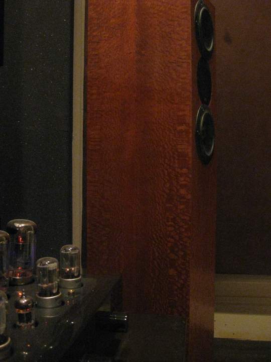

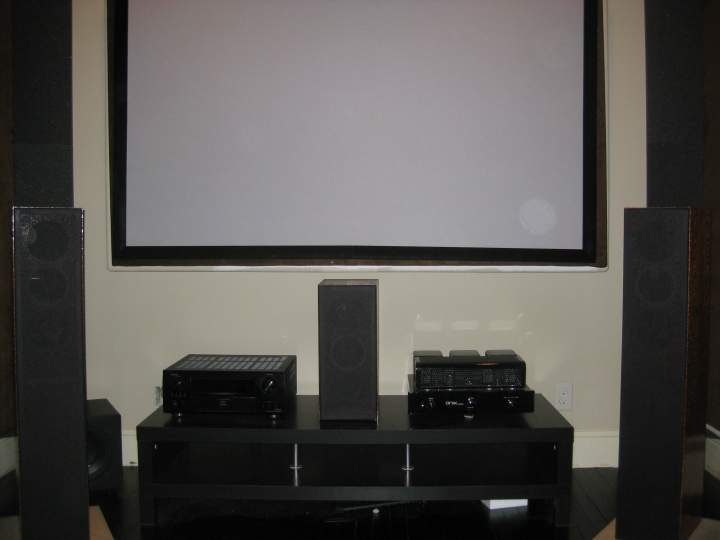

Tonight is a definate milestone, I played music!  :guitar: Just got my BluRay player hooked up to my tube amp and popped in Dave Mathews and Tim Reynolds at Radio City BluRay.  I like it a lot.  If I can get this kind of sound with a BluRay player, stone cold gear that hasn't seen electricity in 18 months, new drivers, new caps, no real positioning.  Things are look bright!  I think all the hard work will pay off bigtime.
Here are some pics for your photo junkies.  I can't wait to post final pics of a completed room with speakers!
If I can do it, anyone can.  Like a proud Papa, I think they look great.  I will post the wifes opinion, that's the real judge!

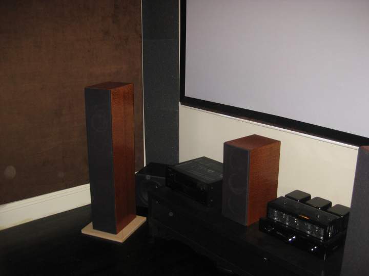

« Reply #35 on: 17 Apr 2011, 09:58 pm »

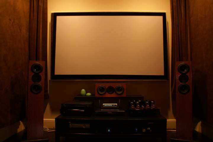

Well here are the final pics of this project.  I must say that I am totally happy with the outcome  :thumb: The speakers are so good for Home Theater.  They are also very musical and the 2 channel rig has never sounded better.  Thanks for all those that helped along the way :D
