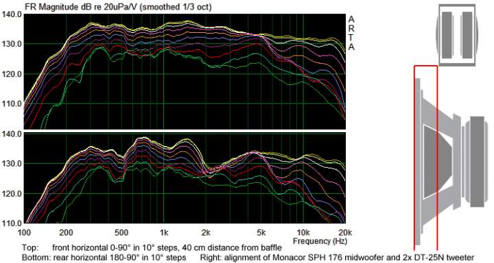

Lately I finally licensed my ARTA software and took the effort to do some 180° polars of my dipole speakers. While measurements of the front hemisphere were fine, the rear hemisphere was sort of shocking :o :
To the right you see how I mounted the drivers with respect to the baffle. The acoustic center of the (forward radiation of the) SPH 176 is supposed to be just behind the baffle (2.5 cm inside the baffle front). I positioned the tweeter dipole (two DT-25N back to back) between the AC and the voice coil, thinking this would be appropriate. This is how it looks in real life:

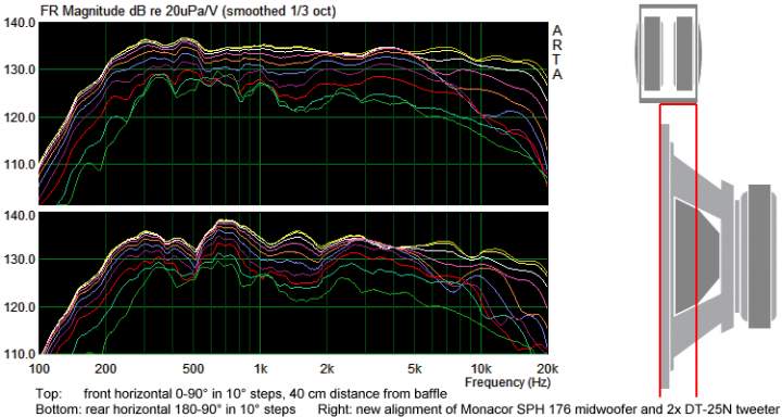

How wrong I was. I got a big suckout at the crossover frequency of 2 kHz. I had to move the tweeters forward to get a somewhat decent rear radiation pattern:
The difference in tweeter positions between right and wrong is only 4 cm in my case. While my first mounting position was led by theoretical considerations only, I have tried different positions for the new one – from 4 cm behind the first mounting to 4 cm in front of the actual best position.
I believe that getting a better rear pattern helped to get a smoother front pattern too. At least the new position does not sound worse than the older one. My ears believe it to be an improvement, but I always believe it sounds better when I know the measurements are more linear. :roll: :lol:
It would be interesting to see some backside measurements of the Neo 3 in combination with cone midrange drivers too. And certainly my findings should be a strong argument to move to the Neo 10 as midrange driver. :D

The center-center distance between both drivers is 13 cm. The microfone was 40 cm from the baffle front at the height of the separation between tweeter and midrange driver. This makes for a distance difference of 1- 1.5 cm to both driver positions on the baffle. Measurements where done in room with 1.5 m being the shortest distance from the drivers to a wall.
You don't need to do all polar steps. 0° and 180° would be sufficient. You have to rotate the baffle for 180°, NOT moving the mic. If there is a considerable difference between both measurements around the crossover frequency, you should investigate further. I would suggest to measure the Neo 3 at the actual mounting position and then changing the Neo to the front of the baffle (> 2 cm difference?). If this results in a change between both 180° measurements at the crossover frequency, you are in for a more precise investigation. If nothing changes, I am guilty of a false alarm. :duh:
My trial of explanation:
The acoustic center of a cone driver (where the air is moved) is NOT the voice coil, but somewhere in the middle of the cone (green square):
For the 90° radiation there is not much delay between front and rear (blue lines). But between 0° and 180° (green lines) there is a delay (for 180°) caused by the way of sound around spider and magnet. This delay will move the (virtual) acoustic center of the rearward radiation to the front of the baffle (dotted green line). The length factor for this is not the depth of the driver, but the width of the spider/magnet. The acoustic center of a tweeter should be in the middle between the usual acoustic center (green square) of the midrange cone and the virtual acoustic center of the rearward radiation. This middle position should usually be in front of the baffle and not in the back!
Does this sound like a good explanation or is it just rubbish?  :scratch:

they are connected in parallel and out of phase. Both moving in the same direction. As you can see from the diagrams they loose their dipole pattern above 4 kHz. The Neo 3 is good for 6 kHz AFAIK. :xmas: will probably be my time to "upgrade" to the Neos. Maybe some parcel will fall off my sled :green:.

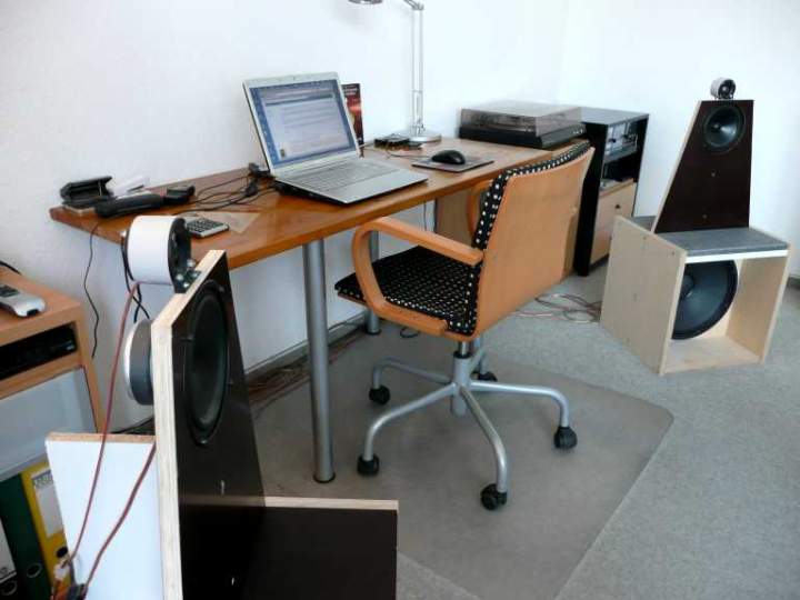

that's what I wanted to see :wink:. I built a provisional wooden slide for my tweeters to move them around:
I don't believe there will be a perfect alignment between a planar and a cone speaker, but we should know the compromise to agree on. The bad thing: The right position doesn't seem to be where pure intuition would have placed it.
