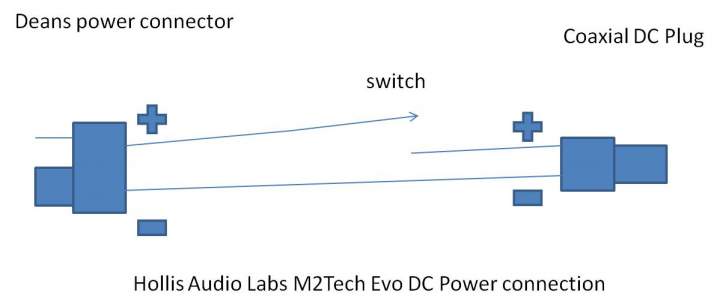

A Deans male power connector is needed to connect to the battery.
Center conductor of the coaxial DC plug is positive.
A switch in the power wiring harness from the battery makes it easy to control power to the Evo.

Great. Can you please describe how this is utilized?

« Reply #82 on: 10 Dec 2010, 03:52 am »
Here is a basic schematic of the DC power connection from the battery to the Evo.
Hope this helps.
