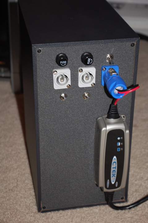

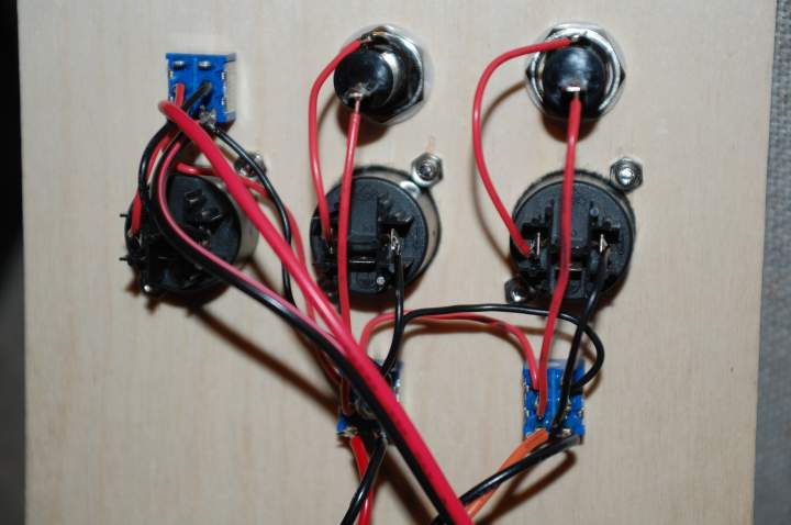

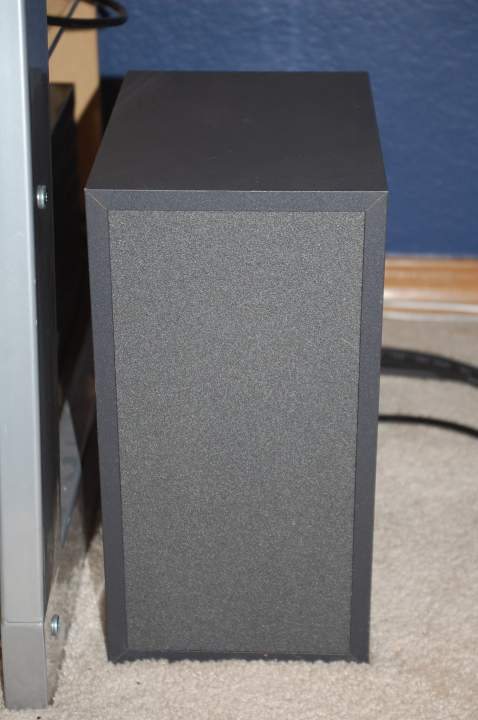

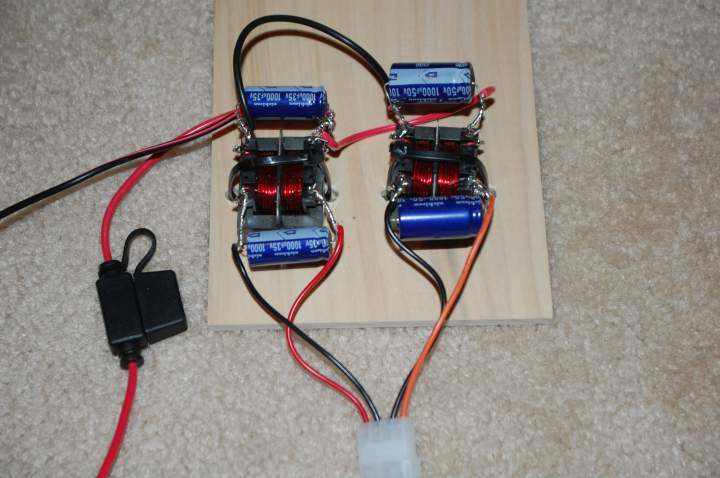

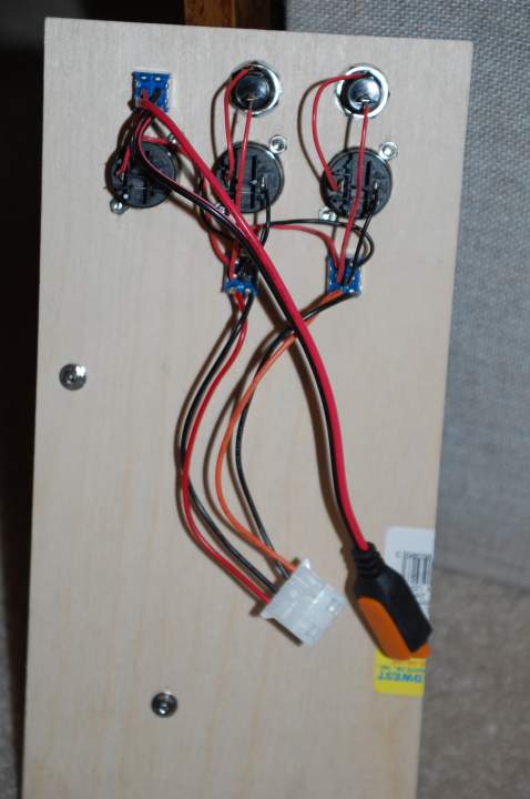

I have had my Dodd buffer for some time now, with the battery and charger sitting in the floor, which is not so nice looking.  Yesterday I built a box for the battery and charger from an old HK computer sub, removed the front and back from the sub and made new front and back sprayed with texture paint.  I included two outlets so I can run my Dodd and perhaps something else some day.  I put a switch on the back to turn the charger off and 2 switches that can change from straight battery to filtered battery.  I'm sure most of you have seen the Felix power filter on the Lab section of this forum.  The Felix used a common mode choke and caps to filter unwanted noise from AC, it works on DC too.  My charger puts some noise into the system, that's why I included two Felix type filters, one on each output.  And yes the filters work very well to remove the charger noise.
