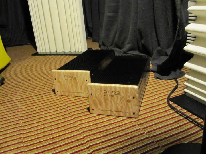

Re: DIY Dodd Buffer
« Reply #685 on: 8 Jan 2011, 03:13 am »
JTWrace, just what you got? :icon_lol:
Those amps are the new hybrid mono's. A single tube frontend with mosfet out put stage (Hitachi mosfets). Power supply consists of a 1KVA toroid with 136,000uf of filter cap with a stealth diode bridge. They are biased very hard into class A and run very hot!! They are 200@8ohms 350@4 ohms approximately 100 watts of it is pure class A! :green:

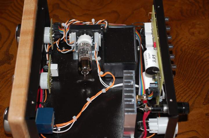

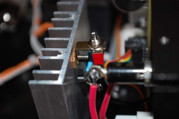

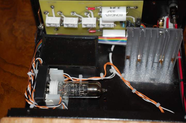

  • Posts: 406
Re: DIY Dodd Buffer
« Reply #696 on: 12 Jan 2011, 06:30 pm »
I completed the mod on my Dodd buffer for the change to a 6H30 tube.  I attached the voltage regulator to a heatsink which I found in an old computer self powered subwoofer.  To make room for the heatsink I moved the large potted module to the left as far as it can go. Due to the extra height of the new tube the tube socket module needs to be mounted on a "L" bracket so the tube is now horizontal.  This job is not to difficult and the results are worth it, a very 3D soundstage, I was amazed.  I had no idea this much difference could come from just changing a tube.  I have included a few pics of what I did, maybe they will help someone.
