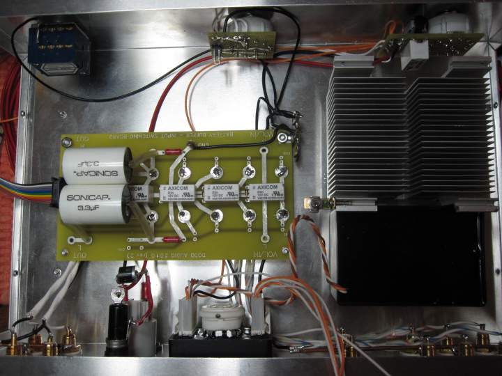

Here are some pics of the single tube conversion with the 6H30.
Thanks again Gary!   :thumb:

Looking good, now how's it sound?
jtwrace
  • Posts: 11433
    • TIPP YouTube Channel
Re: DIY Dodd Buffer
« Reply #673 on: 7 Jan 2011, 01:35 am »
Waaaay to early.  It works and sounds like my buffer so that's a start.   :thumb:
