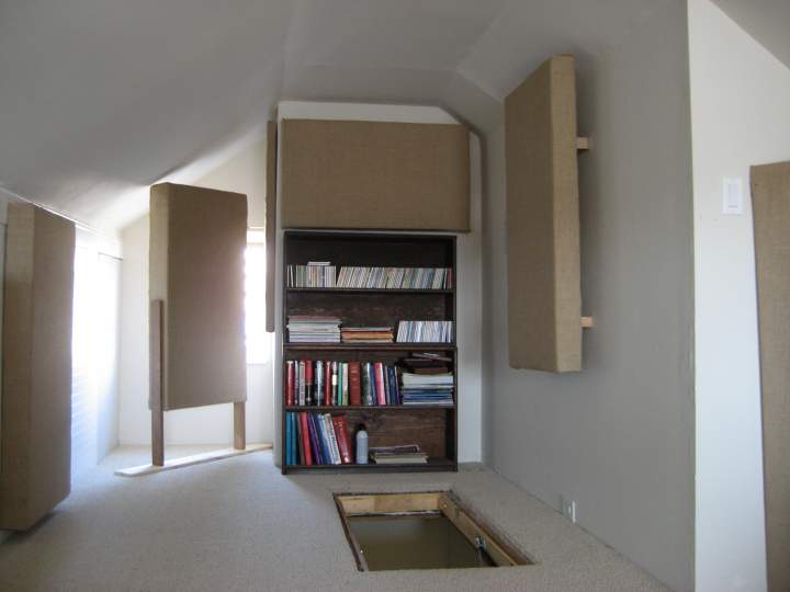

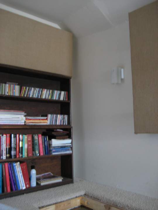

I built this 4"x2'x4' and mounted it on a 2x4 backing (airspace).  I intend to build a 6"x2'x4' to mount above the bookcase and then build a  rectangle shaped trap that will live in the corner, I will move the bookcase out away from the wall about 12 inches. I apologize for the poor quality photos, iPhone.
Looks great, Kirk,  Are you going to place a second panel directly across from that one on the other wall?
Yes, I will build another 4" thick panel for the opposite facing wall.  I also plan to build a rectangle about 18" square to sit in the area near the window (that damned space!), probably 18"x18"x48" that I will be able to move around, maybe taller.  The stall in the build is due to the miscalculation in fabric quantity.  The bass traps ate up more fabric than I figured.

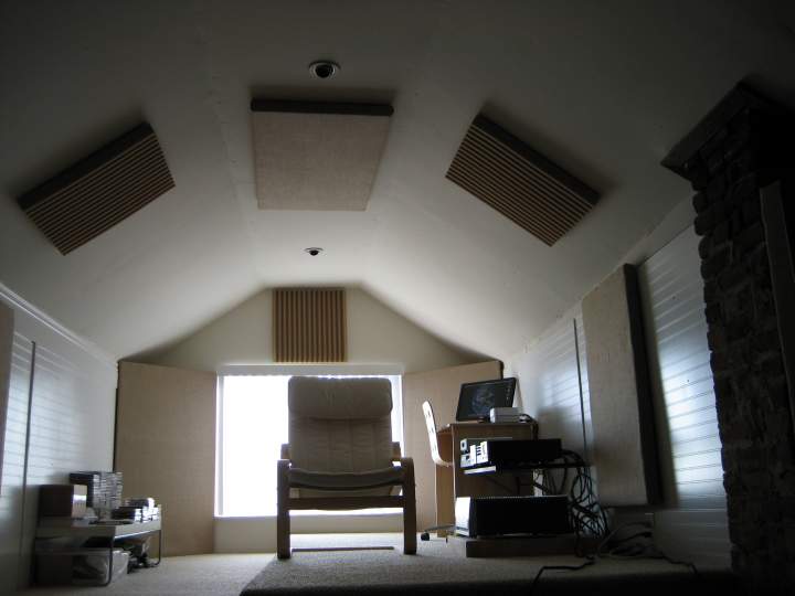

I removed 4 of the Auralex "foam" panels from the angled part of the ceiling.  The right side of the bookcase is boomy.
My question is does it make sense to walk around the room and treat locations that sound boomy?

That's one way to find things.  That said, if it's under control and sounds correct and not boomy at your seat position, you might not need any more.

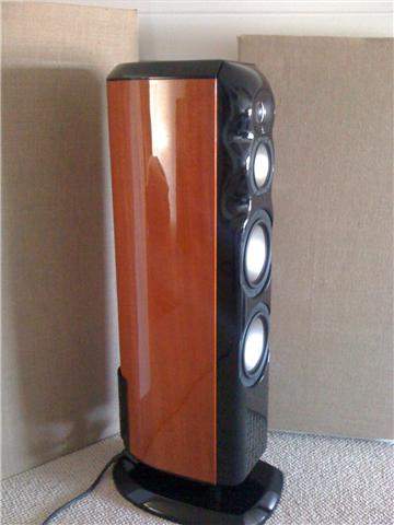

The new addition to my listening attic, Revel Ultima Studio 2's.  I will post additional photos as I settle in.

Hats off to Kevin Voecks and a very well measuring loudspeaker. In fact, the senior product in Revel's line won loudspeaker of the year at Soundstage. Just needs a beefy amp.
Congrats on the new addition!
