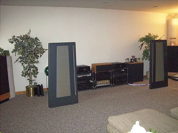

J. Royce Baron
The space is an irregular 27x28x7.5 with a five foot wide concrete support to ceiling in center of room that challenges the Almighty Himself.
LF absorbers throughout the entire space are a must here, the other end of the room is the HT for good measure which makes for a double whammy.
The Cardas if memory serves places left speaker at 7’.6” from side wall / 4’7” from front wall, the distance from side wall would put me at the concrete support, definitely not an option.
Maggie’s at present are 4’ from front wall and 3’ from side wall.
I’ve experimented without LF absorbers in front wall with speakers out to 5’ from front wall; difference been minute at best while forcing a near field listening position which I don’t appreciate.
Front wall is still a work in progress and it may still end up with a combination of absorbers and diffusion.
As is, the stage is wide and highly focused low level information is conveyed clearly and once in a while some recordings still offer a surprise or two.
Now, if the ‘Masterset’ was capable of expanding the sweet spot sans issues with the Maggie’s this would be a real bonus.
Certainly be nice if someone would chime in with dipole impressions.
Furniture sliders are a good idea, will eventually give this a whirl on a good day  :wink:
flintstone
The "Masterset" setup "is not" for dipoles which require setup well away from the wall, and really should not require any toe-in (or at least very little) if placed in a large enough room.
The rear wave from your maggies is your friend...no need to absorb it, if you can get your speakers far enough out into the room...mine are at (5 ft) as per CARDAS setup guide.
The furniture sliders work well, and thats exactly how I moved my heavy Apogees around when I was tweaking  :thumb:
