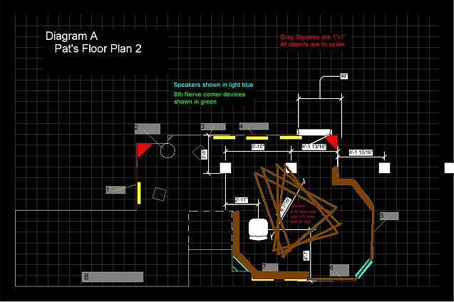

It's hard to make any suggestions based solely on the pics provided. If you can post scans of your floor and ceiling plans it will be much easier.
Jack

Here's a scan of my room to scale
Treatments are GIK acoustics and Real Traps
The eight nerve treatments have been removed
The ceiling height varies from 7-8 feet depending on the duct work

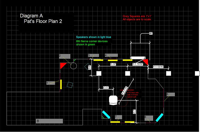

I would first try to maintain your current speaker distances - speaker to speaker and speaker to you - as much as possible. A few less variables in the equation would help you get an idea of what the new room orientation sounds like.
Once you hear your "new" room you can start moving your panels around to fix its new problems.

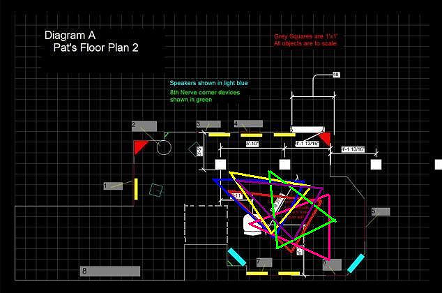

I have a suggestion. Put your stereo where the red corner sofa is, in the half circle. With the components in the middle and the speakers either side with them angled pointing directly towards the seat which would be in the middle of the mouth of the half circle opening.
  The panels could cover the whole of the half circle wall and the large butting out wall ceiling bit. The brown listening chair would be facing into the half cirlce pointing toward the middle flat which has the silver uplighter and brown panel on it in the first picture.
  What do you guys reckon?

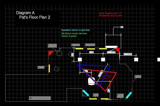

your layout would be the pink triangle shown below.  i added what i believe to be approx location of the angled staircase, indicated by dashed grey lines.  due to this, and to close proximity of the right wall, i still think an off-set asymmetrical layout would work better, but it would certainly be worth a try - this is a difficult room.  i also added a couple other triangles, which may (or may not?) help deal with the staircase.  i would recommend placing sound absorption on the face of the staircase that faces the speakers...
finally, here's another wariation - some brown triangles, w/suggested extra absorption on the walls/staircase, also indicated in brown:
doug s.
Doug Thanks for all your help here
I'm not sure I can spread out my speakers on an angle like the way you described as the room needs to also act as our living room
Wife approval will be needed to move further but it doesn't hurt to ask or move them in this configuration when critical listening
In your diagram where would the listening chair be situated
