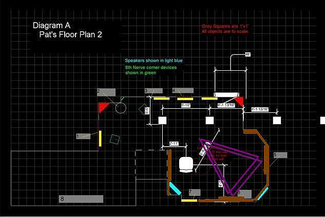

mike, best i can figure is browntrout's suggestion is what's shown in my diagram indicated by the pink triangle.  chair is in the same location as in your diagram, but turned clockwise 90 degrees, speakers being located at the other two points of the triangle.  in all my triangle layouts, the chair is at either the uppermost or furthest-left point of the triangle, w/the speakers being at the other two points...
the pink triangle location is prolly the most waf-friendly.  another option, likely still not the most waf-friendly, but one that will not be out in the room so much is shown below, chair is at the triangle point closest to where the chair is now:

Once again thanks for the input Doug
The diagonal placement will be hard to pull off as i'm placing a 47 inch plasma television on the southern wall (where my couch currently resides)
I'm going to try to place my speakers along the short wall and have them fire into the room this appears to have the least amount of obstructions

mike, if i understand you correctly, you will be going for something similar to what is indicated w/the pink triangle.
you could also work a plasma tv w/the last diagram i showed w/the purple trinagle - no reason the tv couldn't go in that corner space, even if it's not flush against the wall...

for the speaker/seating location indicated by the pink triangle, sound absorption should, imo, go where i have indicated in brown; with most critical areas shown w/heavier lines.
for the speaker/seating location indicated by the purple triangle:
due to location of staircase indicated by dotted line, and proximity of the wall to the right speaker if using the pink triangle layout, i suspect the purple triangle layout will give best sound.  and, note i have two purple triangles - exact final location can be adjusted to balance not being too far into the room with keeping speakers further from the walls.  but, as the walls are angled, you can place the speakers closer to them w/less deleterious effects than normal.

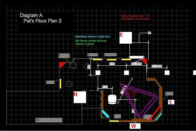

...Doug, the angled placement wont work as a plasma television will go along the southern wall and this should impact any sort of diagonal positioning
i'd give serious thought to placing the plasma screen in the sw corner, still positioned between the speakers, and as close to the wall as possible.  while the screen might be a little closer to the plane of the speakers in this location, compared to the pink triangle location, you could always drape a heavy blanket over the screen when listening to music.  you may find the improvement in sound to be worth it...

Not sure I get you -which SW corner the tv should go on ?
 are you not referring to the SE corner ...

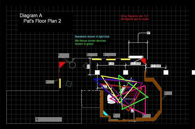

hmmm.  from this comment, i suspect that the layout you have in mind is represented by the blue triangle below, south wall being at the bottom of the drawing.  from your prior comments, i thought the pink triangle represented what you had in mind.  red line indicates location of plasma screen:
since you never specifically identified the south wall, afaik, i assumed it was per below.  plasma screen indicated in red.  even if it's not, my suggestions are based on what is represented here:
while i am yust speculating, i think that the purple triangle would give best sound, w/the blue & pink triangle locations pretty close to each other, and a little behind what would be had w/the purple triangle set-up.  of course, you would have to try for yourself, to see...   :wink:  certainly, if you want to utilize that red couch, it seems the pink and blue triangle layouts would be easier to work with.

Thanks for the clarification Doug
I'm going to opt for the pink triangle placement first and see how that goes
The Flat screen Tv will be placed on the western wall
The wife is ok with this placement and she seems to think this is the best compromise  :thumb:
