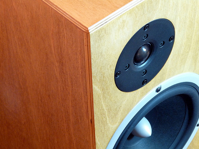

Well I figured white was the new red and went ahead with a test run. But as always, I'm grateful for confirmation. My Vsonics logged about 5 hours this afternoon, apparently in correct phase and definitely churning out more tuneful bass and mid to upper range timbre than the diminutive Ruarks they so recently replaced. JJ Cale (bass) is rock'n my listening room, and some spanish guitar that happened to come up on the FM was holographic in the timbre department...
What do I need for full bloom- 20 hours?
Attached, some photos. WAF is in evidence  :thumb:
The paint is still drying on the plinths, yet to be installed. As I anticipated, I'm happy with ~ 2" increase in tweeter hight from my listening position, not that I am above average hight.
John

Hi John,
Beautiful work, really like the fit, finish - and the port looks better than the original, I think......
Thank you for showing us this beautiful speaker, and I'm so glad you like the sound.  The bass is more placed in the room, than played - and it's an indefinable quality of all TLs, they are just so musical.
The resolution of these two drivers is something extraordinary, hats off to Peerless for getting the detail so precise.  The crossover, Laurie's design, is absolutely a work of art.  The crossover took more than twelve months to get exactly right, and it's a masterpiece.
Thanks for sharing, John, 20 hours is about right!

Johnny
Re: Vsonics build
« Reply #43 on: 24 Nov 2009, 03:32 pm »
Ah Andy, You've anticipated my next post! I was hoping to get some advice on placement without going through the whole masterset thing, which I have read  :scratch:
At the moment the speakers are in a resting position while they break in, and the wife, cat and kids get used to their presence. Soon, they will mysteriously begin to creep out into the room in increments of 2.5 inches over successive nights. Maybe no one will notice  :icon_twisted:
The room is very symmetrical- a nearly perfect golden ratio shoe box. Interesting, 1/5 from the side walls? That's really into the corners, which should indeed lift the bass. Interestingly, what you suggest would put the speakers and my listening position in an equilateral triangle, another rule of thumb  :thumb:
And you are also suggesting the speakers should toe in? Is that the general consensus for the Vs?
I will definitely report back!
John

Hugh, Laurie and all,
Here are the results of yesterday's tweaking:
1. Move stuffing to Laurie's suggested locations:
    Difficult to put your finger on, but it sounds like there's better integration between the drivers.
2. Removal of 80% of the felt lining in the lower chamber:
    4 of the 5 pieces of felt were removed, leaving the top piece in place so as not to disturb the crossover.
    The bass is back  :thumb: - and better than before, as the drivers are now well run in.
3. Removal of sealing on the tweeter:
    Suffice it to say that I put the blu-tac back PDQ!
Thanks Hugh and Laurie for your patient help and guidance, I think I'm now listening to these speakers as they were intended to sound. aa
