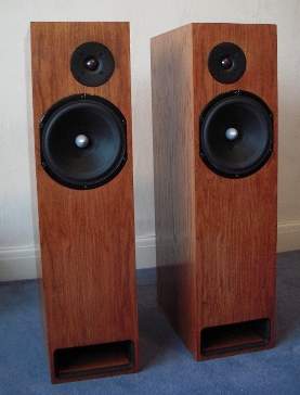

After much tinkering, the Vsonics cabinets are finished!
Here's a few pics:
I wish I'd seen Hugh's warning about not soldering the connections before having a Tweeter go open circuit!
Ron.

Look'n good Ron!
Ain't they grand?  :thumb:
John

Ron,
Impressive, congratulations!

RonR
Re: Vsonics build
« Reply #76 on: 23 Jan 2010, 12:39 pm »
Hi Johnny,
I spray painted the woofer frames with satin black smooth hammerite, as I was not a fan of the Aluminium frame with black mounting screws. It looks much 'cleaner' this way.
A new Tweeter is on it's way, as I couldn't disassemble the one which went OC on soldering. Those 4 small allen bolts are done up tight! Normal service should be resumed in about a week. :cry:
Ron.
