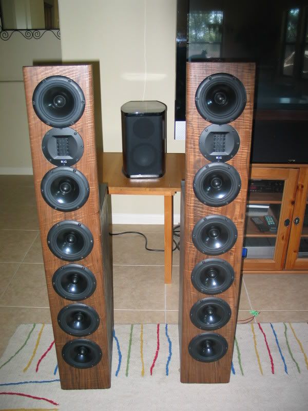

Myself and others have found approx half pound of Acousticstuff per cabinet has worked really well. I used iron on method with yellow glue for veneer with raw burl walnut. As with a few others also opted for external crossovers.
Good luck on the build, you will like the results.

Yes i also used norez in my speakers and I only veneered the front baffles and the rear's are black. I bought 2 sheets of veneer that were approx the same size as baffles and used 1 sheet per. I rounded the edge as much as possible to wrap edge. Thanks for the compliment.
