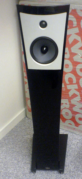

another example for a good looking narrow baffle, the lyngdorf dp-1
it kind of inverts the idea of pyramid (upside down )
low freq. are handled by two subs.

The Lyngdorf is a good sounding rig.  Heard them at RMAF.  Very small baffle.  Corner subs.
