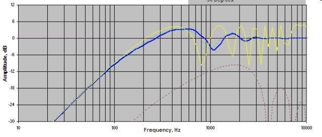

I don't think EDGE can do polar response
Erling,
as Panomaniac already mentioned you can cheat it. I once made up a chart to help finding the right values:
If I recall Svante correctly he does not recommend to trust EDGE above 70°.

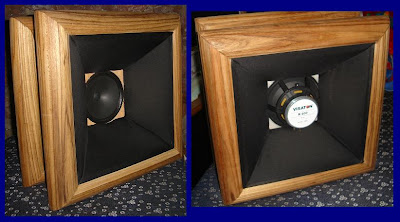

I`m not sure if you really need a doughnut shape
I found one major drawback with OB speakers being severe diffraction. According to the discussions (Gedlee and others) at the diyAudio forum, OB speakers have twice amount of diffractions comparing to monopole. I have personally measured such effects and obviously don't like them.
A doughnut shape (whether it is made from timber or damping material) would substantially reduce the diffraction effects.
Very nice, thanks!

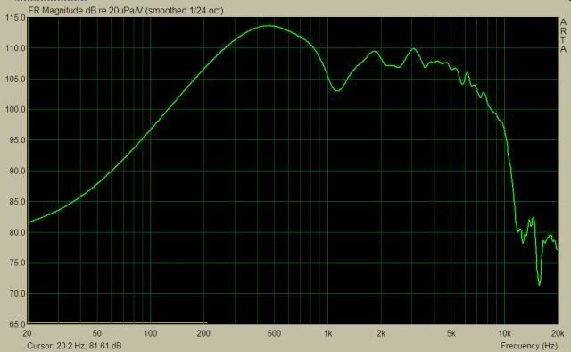

In regards to simulator, I have used JohnK's ABC Dipole with great surprise  :thumb:. I had heard something wrong with my old 120x45cm baffle with eminence alphas (a "CS2 Clone") but not sure what it was. I measured it outdoor and got this. I was already suspicious that this has something to do with baffle width.
So, needing a tool I bought John's simulator. To my amazement this is the simulated plot  :icon_surprised:
So I have been using that software quite reliably for the "S7". Btw. I have yet to find independent measurement of Physics CS2, all the reviews seems to be positive talk only, keen to know.
